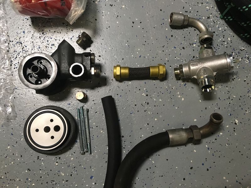

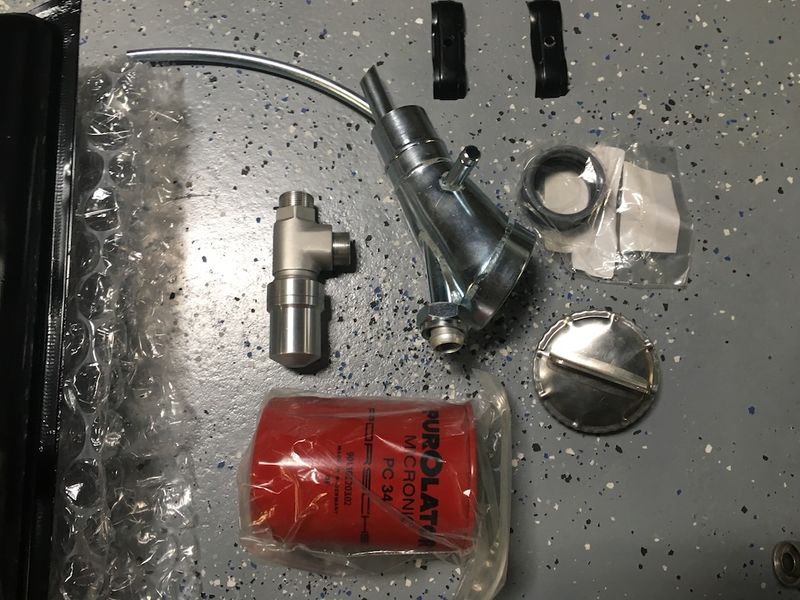

Ben - since you are doing the GT lines, will you also do the GT console and pressure relief valve. They are hard to track down and rather pricey.
Pic stolen from this thread - http://forums.pelicanparts.com/porsche-914...oil-system.html
I may but again would need samples to get castings made etc..
For my car I will do a hybrid so to speak with adaptation of a 911 t stat.. Its hard to say at this point how much interest beyond the hard GT lines there will be.????

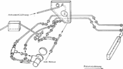

its complicated..
http://stazak.com/914/gt/oil/oil.html

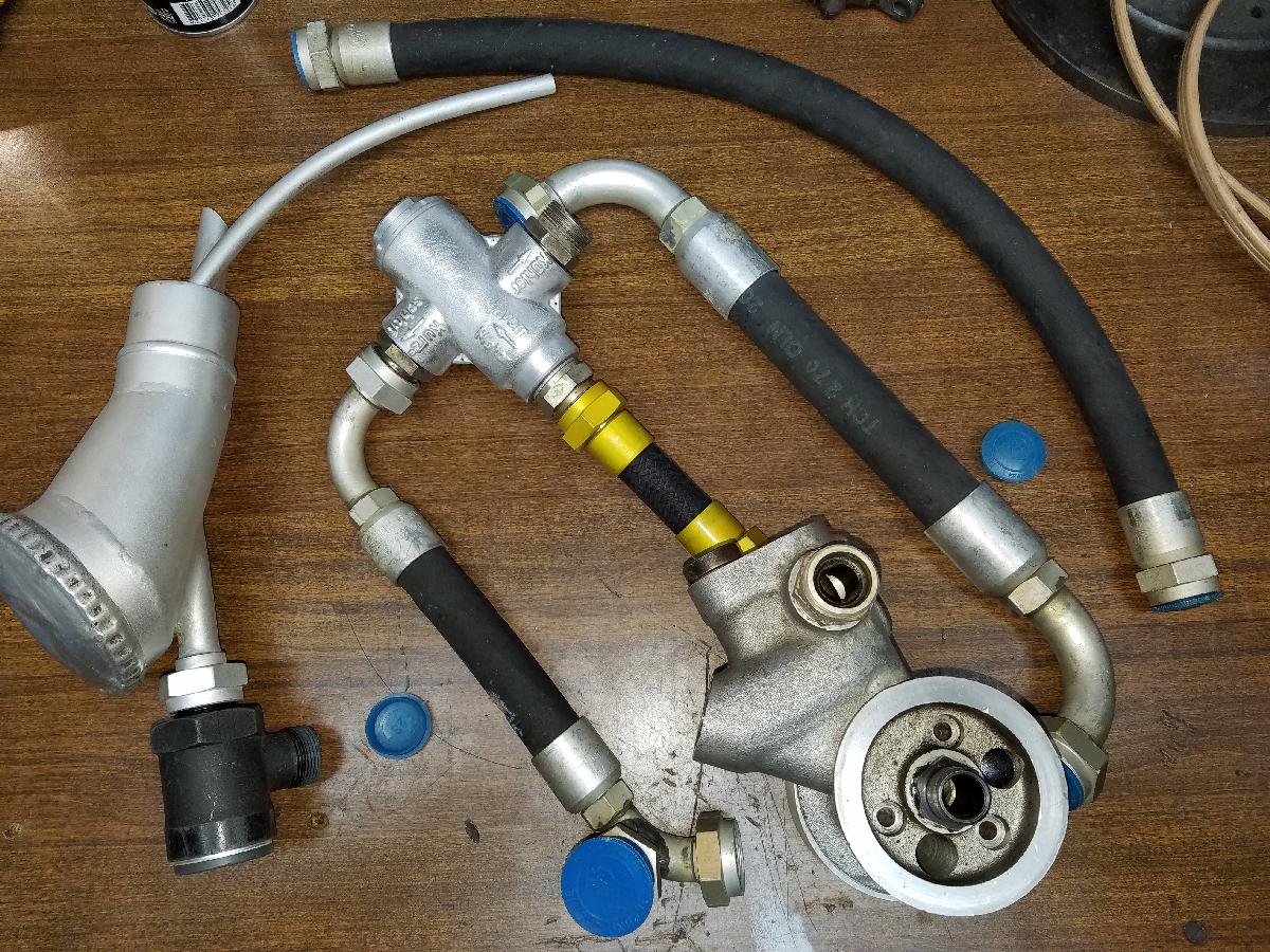

I still wonder why the oil system was plumbed that way vs the conventional 911 setup?
Glenn any thoughts?

QUOTE(mb911 @ Jan 2 2018, 07:11 PM) *
Glenn any thoughts?
I sold a similar/same setup from a 911 “69S. Sold for $2k. I believe Porsche used it on a lot of there race cars.

Joined: 12-September 04
Member No.: 2,744
911R is the same and 3.0 RSR
early versions had a adjustable pressure relief later did not....
