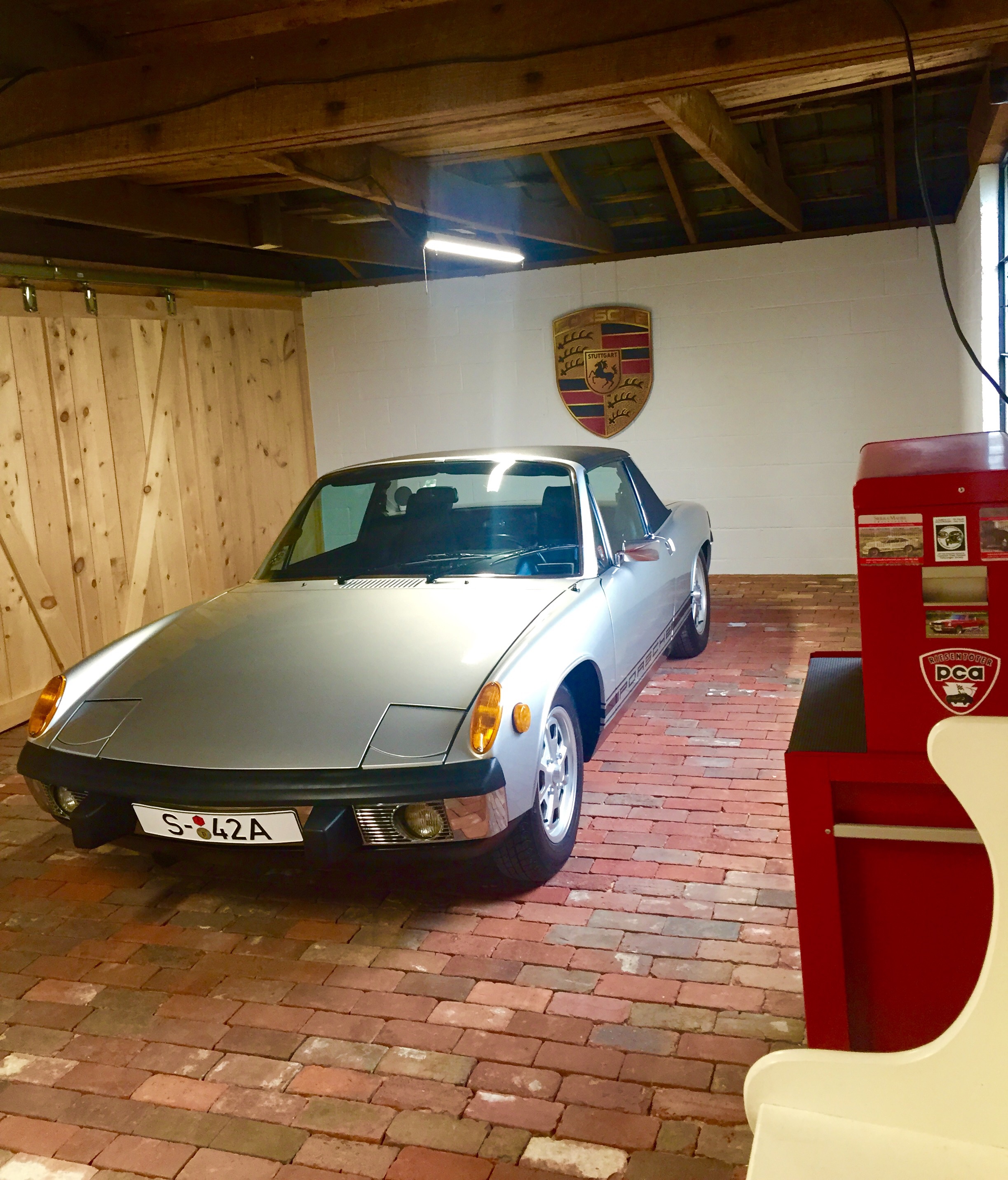

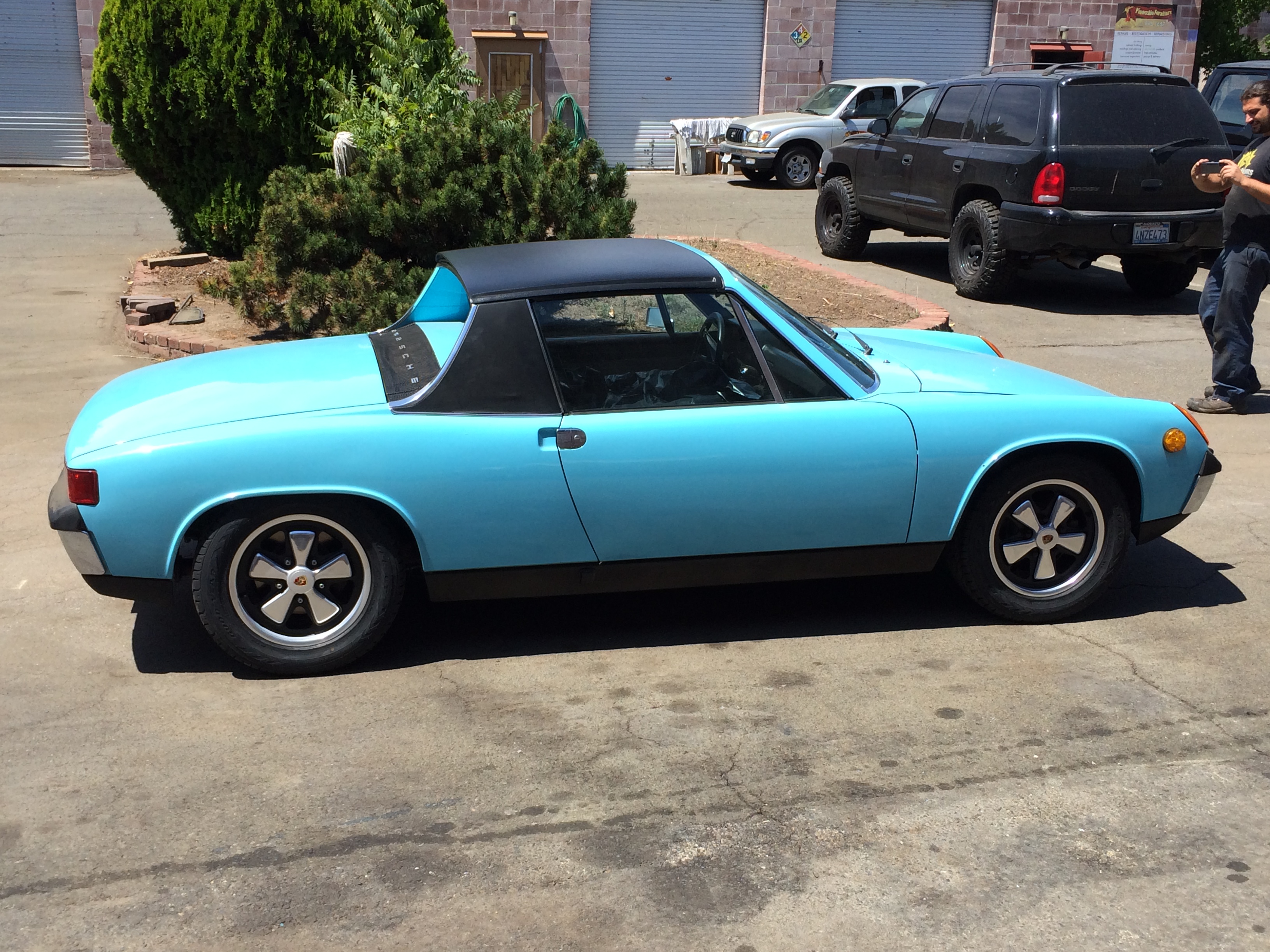

I've posted several threads recently regarding Fuchs and tire types/sizes. I'm on the fence about staying with the stock 4-lug alloys that came on my 2.0L car or converting over to a 5-lug to run the 911 deep sixes. If I did the conversion I'd probably use PMB's kit. My question is.....am I an absolute idiot to even consider doing this to an original unmolested '74 2.0L? I know it's my car and I can do whatever I want but I'm looking for advise / opinions. If I did the conversion with Eric's kit could I ever convert it back to a 4-lug without much trouble. If I left the car unaltered I'd at least replace the old 165/SR15 tires with the period correct Michelin XWX or the Pirelli CN36's in the 185/70/15 size. Below are photos of the car....

That car is beautiful. I would keep the 4 lugs, especially on a narrow body. (IMG:style_emoticons/default/smile.gif)
When i had a narrow body LE i used 195/60-15 tires which gave it a slightly more updated look IMO
But i would leave that car as is! (IMG:style_emoticons/default/driving.gif)

As you mentioned, your car, your decision.
I personally think your car looks very nice and classic in this configuration especially with the 165s. (IMG:style_emoticons/default/drooley.gif)
That said, I'm sure it would be as classic with the deep Fuchs but maybe also keep the era tire size.

your car is gorgeous! 4 lug Fuchs looks just right on yours.

I think you are correct about Eric’s kit being the way to go. It would be easy to switch back. That being said, I can’t think of a nicer looking stock four.

I really love the deep sixes, but on your car, which is just stunning, I would have to keep it original. Replace the tires and enjoy. (IMG:style_emoticons/default/beerchug.gif)

I think your car looks great with the 4 lug Fuchs. That being said I think it would look good with 5 lugs Fuchs as well.
Why only "good"? Chances are the 5 lugs will be your typical silver with black background, right now the 4 lugs have a more subtle contrast which is visually appealing to me.

Your car would look great with deep six' (more black) , but keep the original parts if you ever want to go back to original. I'm sure you'll get a lot of pressure from here to sell your 2.0L fuchs ( they look great) but I'd hang onto them.

I'm sure that you can guess that my opinion on a beautiful original 73-74 2L like yours will be to keep it stock & period correct.
Another reason to keep with the stock-ish sizes that nobody is mentioning here, is "Ghost Mileage" - wherein the odometer error of +/-10% will significantly devalue an original 2L like yours over time driving it, & showing more mileage than actual.
Member Todd on here who has restored several low original mile 73-74 2L learned that lesson the hard way, when he lost some sale price upon his refurbishment/clean-up of the Bahia Red 73 2L IIRC due to the 195/65HR15s that he used on it for a time driving it.
185/70R15 or 185/75R15 are the closest diameter to the OE 165HR15 (165/80R15) size that were original 73-76 2Ls, & so only have a tiny error.

If you're looking for better performance, then go to 185/70R15 - if not but want the OE look & size of 165R15 (165/80R15) - all in the H, T or V speed ratings.
Sometimes it's just best & nicer looking to have & show-off a classic car as it was back in the day, without all of the resto-mod & hot-rodding tricks of today!

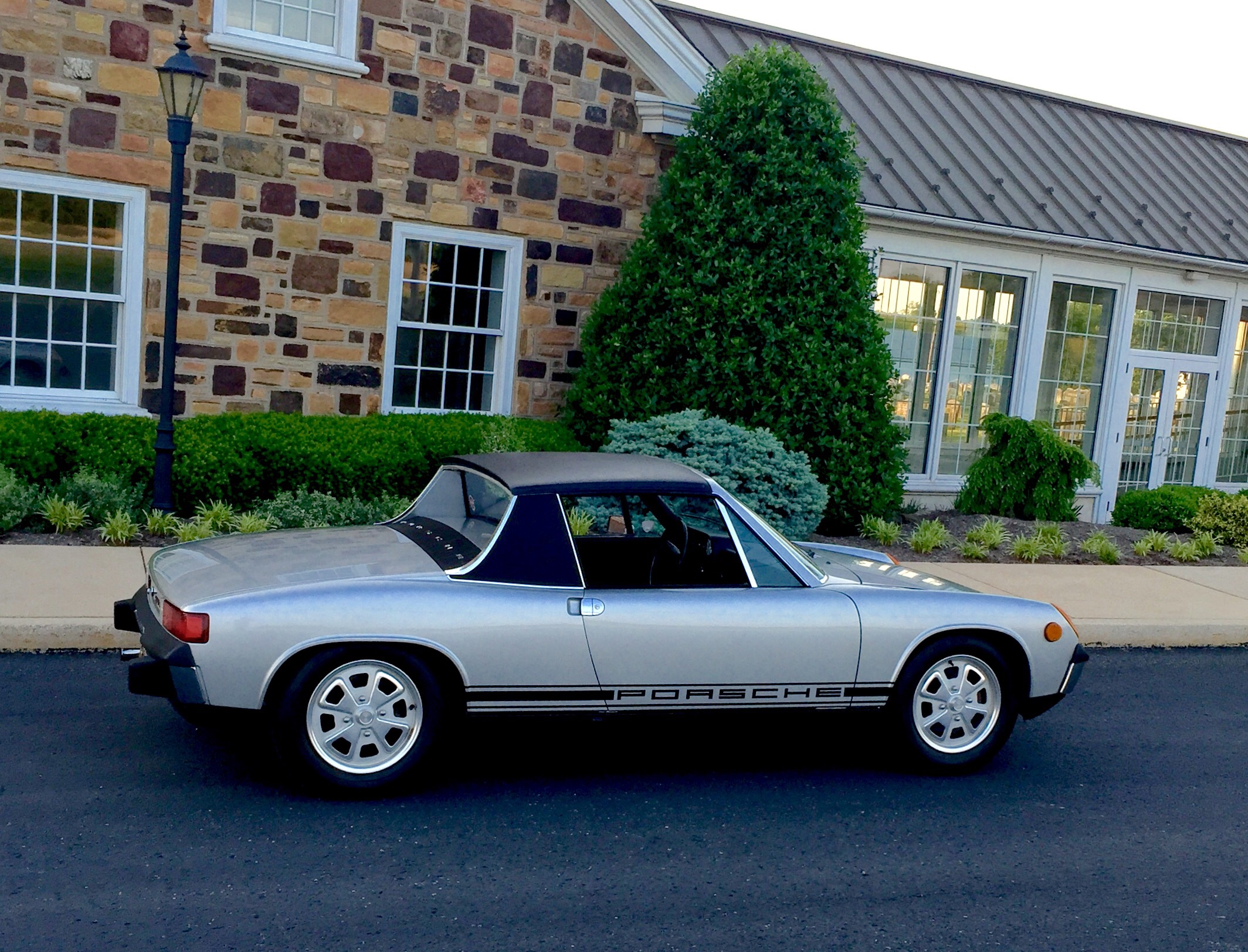

I waffled on this decision for a while too but ultimately I just love the look of the 5-lug Fuchs on our cars. Not a cheap change though; Wheels, refinishing wheels, tires, conversion parts and getting McMark/Tim to do the conversion came to slightly north of 5K. But I love the look....
Before
After
