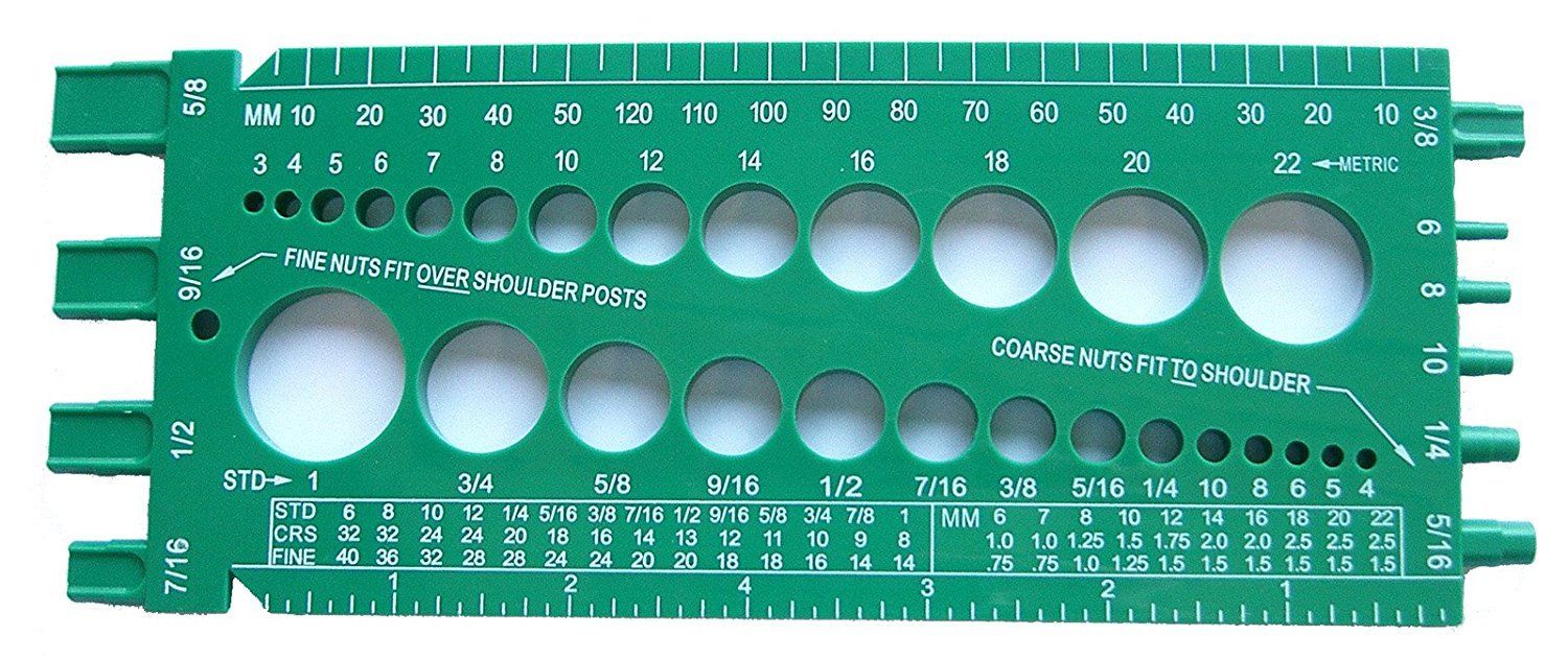

Definitely use one of these and start a spreadsheet (or just some paperwork) that details what size came from where.
Camera and photos are a great help for later as well.

Raynekat, great idea. I'll definitely pick one of those up. I've been meaning to get one anyway, but it never crossed my mind for cataloging parts. (IMG:style_emoticons/default/screwy.gif)

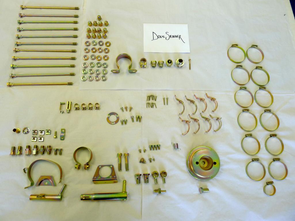

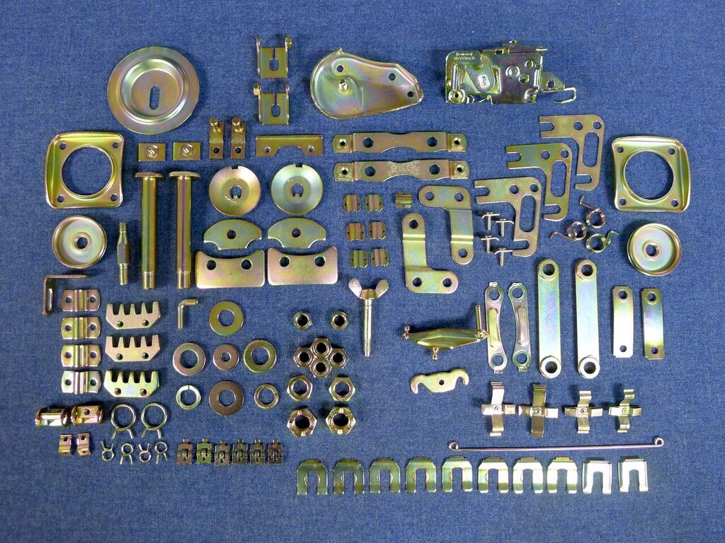

I've used Shaun with Tru-6 exclusively on my build, and am completely satisfied.
It's not always the fastest and for sure not the cheapest, but it is always done to perfection.
And yeah, that's where Shaun excels....in his preparation of your parts before they go to plating.
Some samples below:
