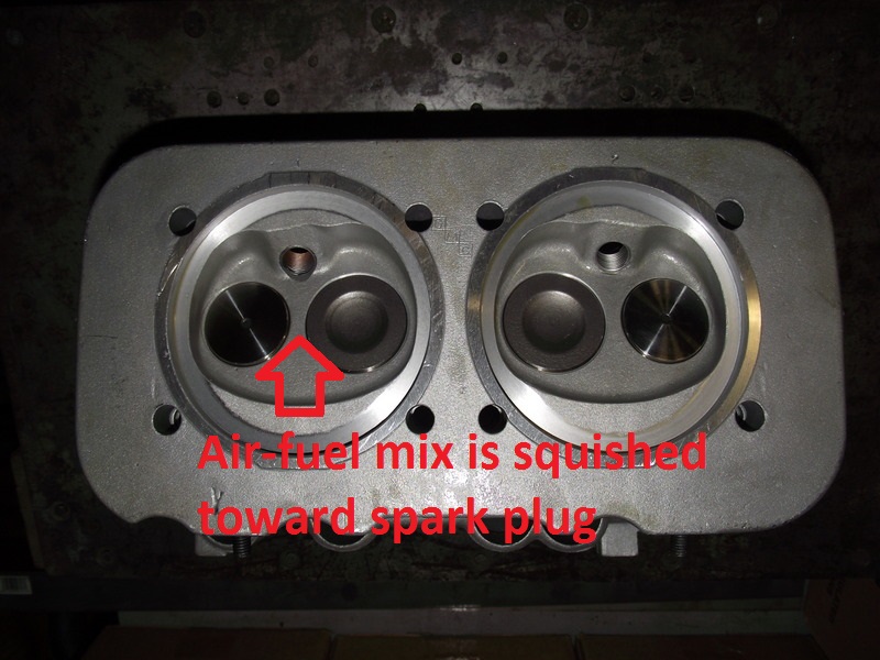

The 914/4 combustion chamber is a modified wedge style design which compressions (squashes) the air-fuel mixture toward the spark plug. Adding a second plug may have some advantage but not as much as the 911s hemispheric combustion chamber which benefits from 2 points of ignition.
There was a local guy who did the twin plug 914/4 heads back in the ‘90s his name was Morrison and he was in Aurora IL.

QUOTE(gms @ Feb 18 2018, 07:23 AM) *
The 914/4 combustion chamber is a modified wedge style design which compresses (squashes) the air-fuel mixture toward the [existing] spark plug. Adding a second plug may have some advantage but not as much as the 911's hemispheric combustion chamber which benefits from 2 points of ignition.
