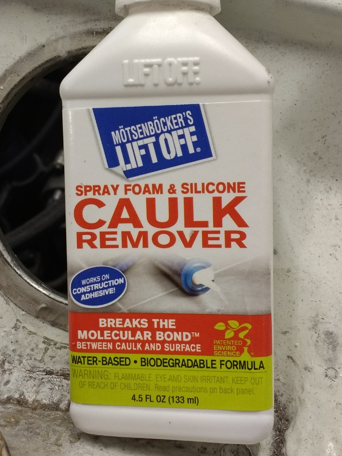

EDIT: I found a solution. I used Motsenbockers Lift-off. It apparently works by loosening the molecular bond. I scraped off as much as I could with a razor. I applied the lift-off. Let it sit for about 3-5 minutes. I was then able to scrub it off with a rag. Took about 3 applications.

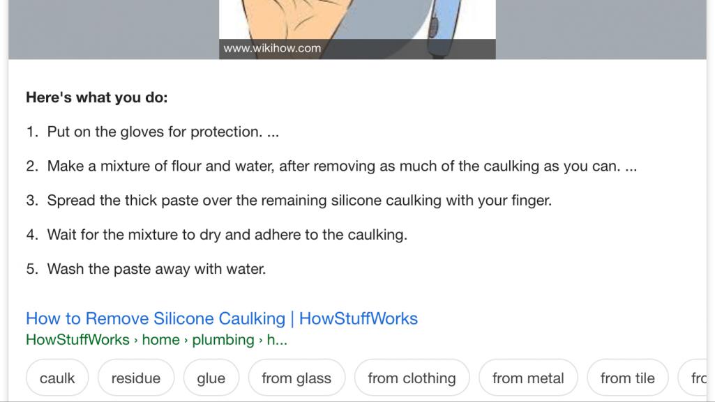

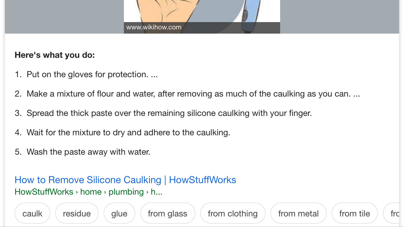

The flour just made a mess! The other suggestions did not work for me.

What about any products available at the big box stores like Home Depot?
Like this: https://www.homedepot.com/p/Motsenbockers-1...11-16/202103458
