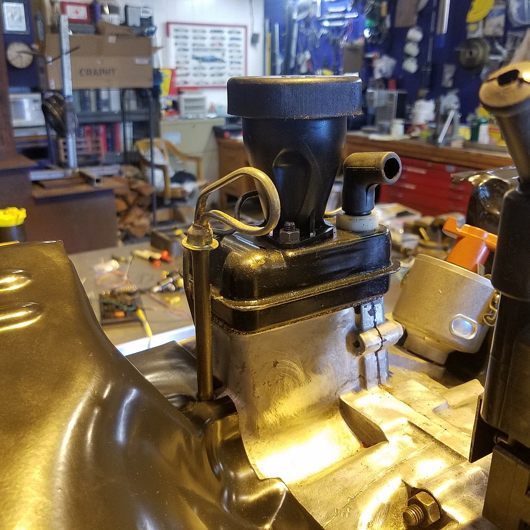

I'm thinking maybe a Tangerine catch can. With only the evap going to one of the air cleaners.

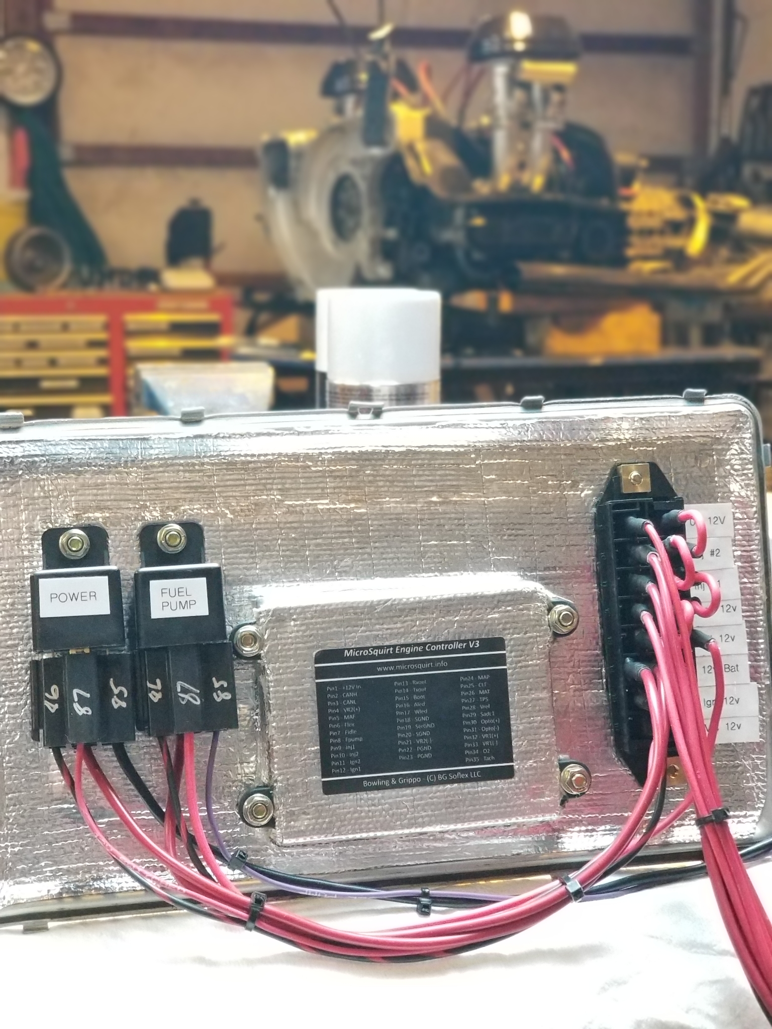

After a 30+ day break I'm back to Matt's MicroSquirt install. We're making an attempt to kind of hide the 21st century components to some degree. At least the mondo wiring harness. So must of the wiring connections will be hidden in the old D-Jet ECU box.
The wiring of the box has begun. All individual components will be fused.
We found one terminal block that would have eliminated the jumpers. But it wasn't robust enough.
Still working thru my sleep deprivation from the Mexican 1000 Rally, but it's getting better day by day. Up at 5am and can't wait to get back at it. I think I've been wiring since 3am in my dreams.

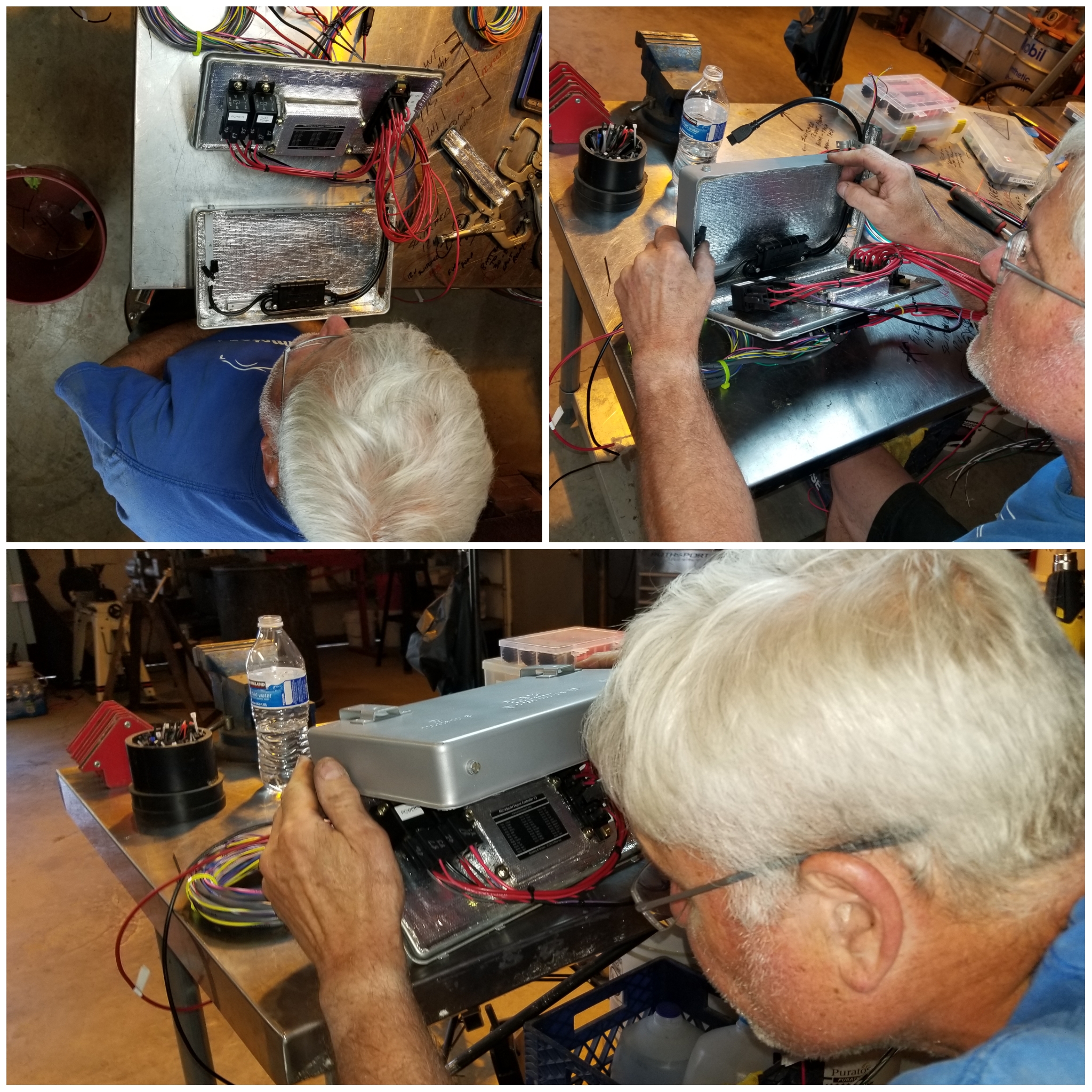

Here it is wired up ..............
The box is tall enough to allow for the wires to arc and dress out real nice.
If we do a few more of these we'll have some stickers made to call out the fuses. Both inside and out.

After the mock-up was done I put some work into the ECU boxes. Painted it and then insulated the inside then added a rubber sheathing to help keep any water out of the box.
Starting to look like a V2 rocket (Mark (IMG:style_emoticons/default/poke.gif))

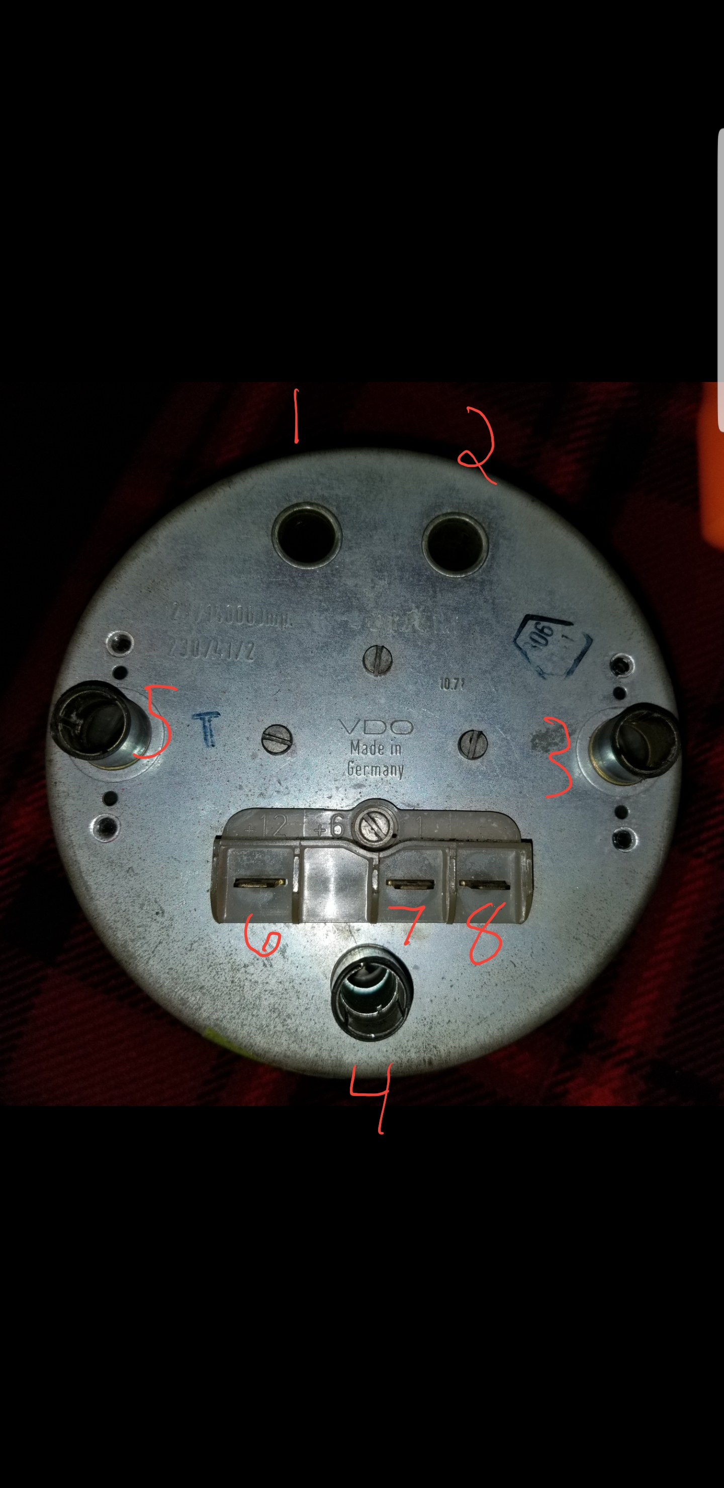

Pulled the tachometer and sent it off to Palo Alto Speedometer (thanks Eric Shae for the advice) to get an upgrade so that it will be able to use the signal from the microsquirt. Now if I could remember what he said about needing a diode somewhere for some resistance (IMG:style_emoticons/default/poke.gif) Eric (IMG:style_emoticons/default/confused24.gif)

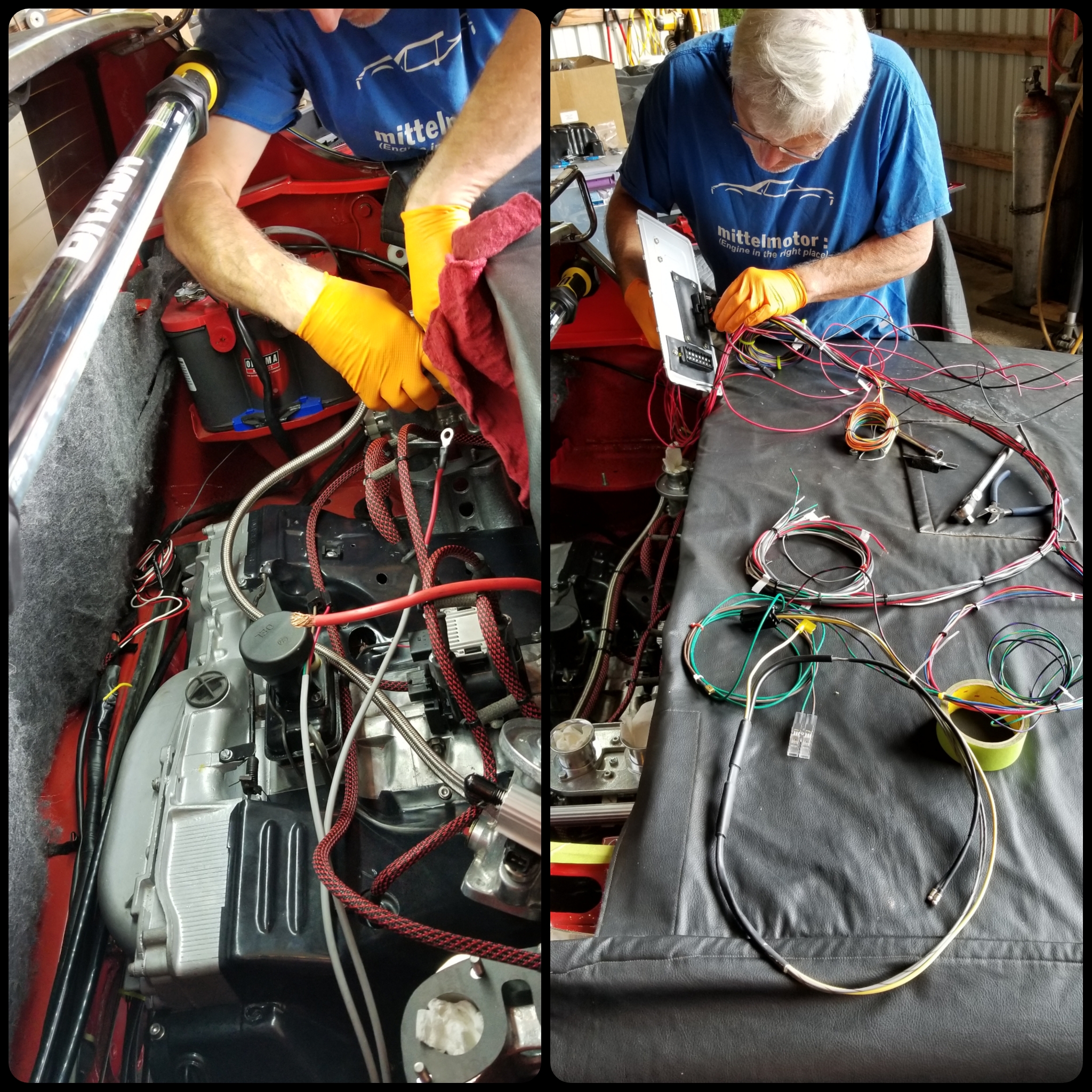

The work continues. Installing fuel lines and fuel pressure regulator.
Lots of engineering along the way. We want to be able to replicate what we've created.

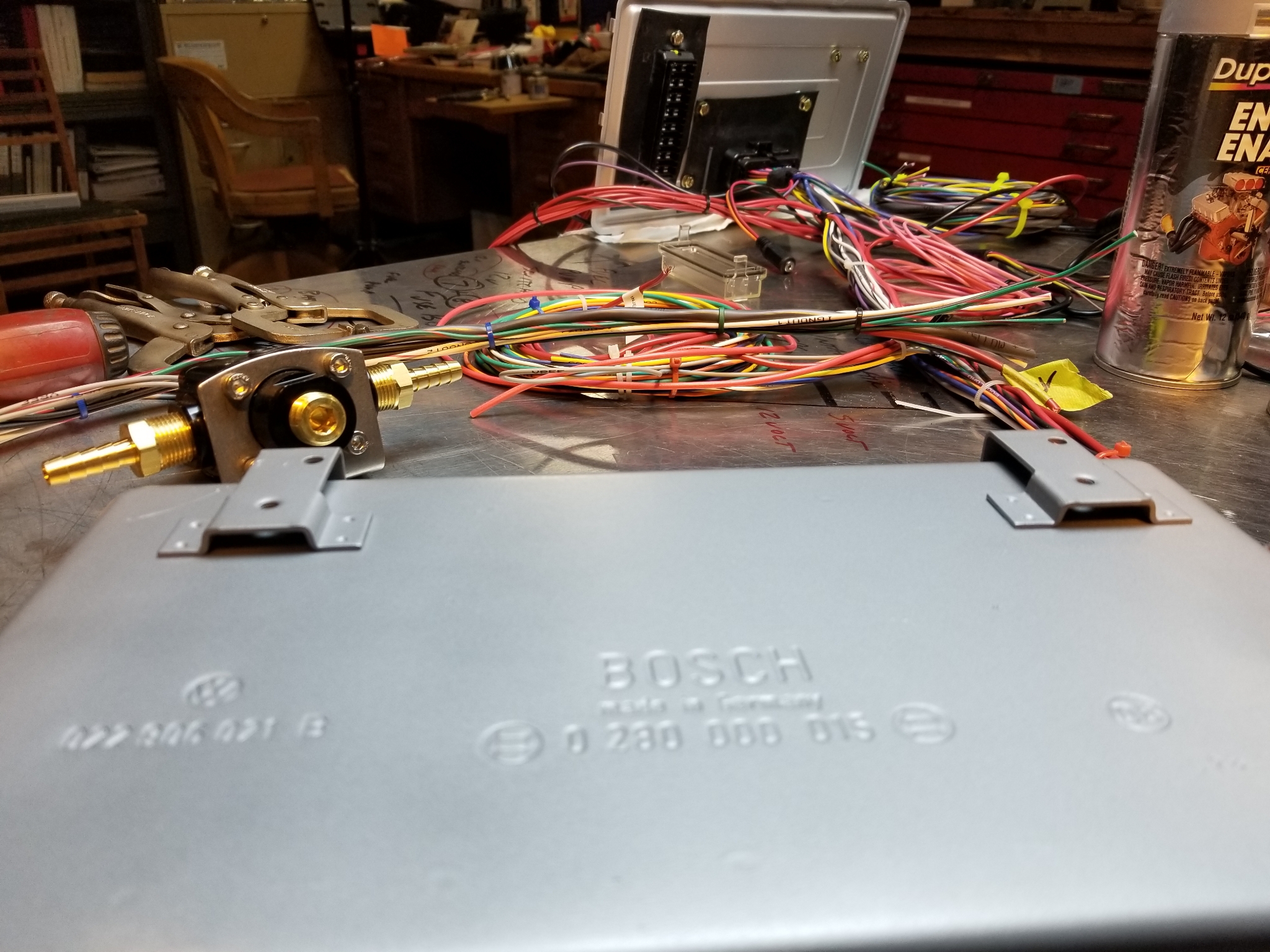

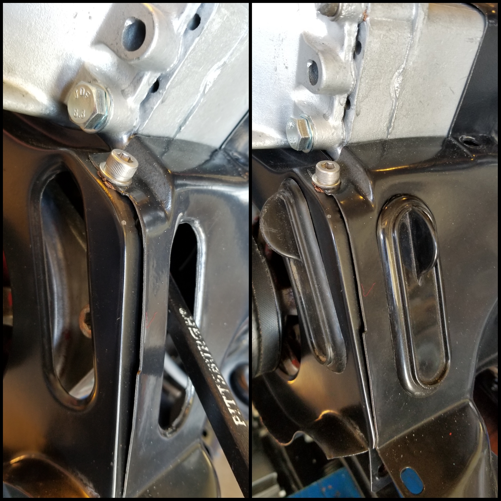

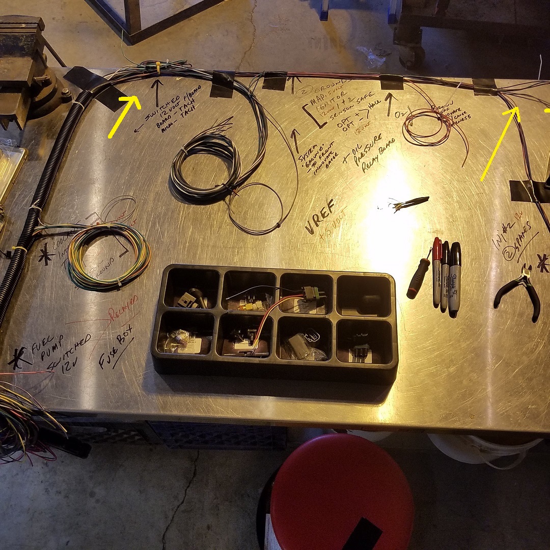

Tuesday was going over the harness one more time before it goes into the engine bay for harness mock up. I'm making sure I have all the wiring I need to integrate the Innovate LC-2 into the harness, it too is going into the ECU box. This is definitely not plug and play. While I was doing that Matt was upgrading the fuel lines to SS and AN fittings.
I climbed up on the engine rack and extracted an engine ground off one of my engines.
I'd like to find find/purchase 5 more to send out for plating.

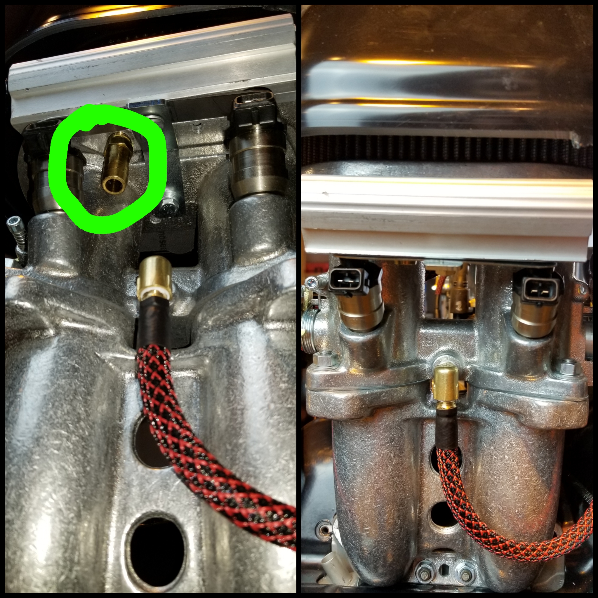

Then I'm not real crazy about the evap lines going into the throttle body top. So I had Matt pick up some pipe thread taps so I could tap a hole in the stack plate. Should be Tight & Tidy.
Then onto NEW parts. Matt bought a set of NEW Porsche Classic half shafts.
Installed the outer hubs and torqued them down so we can safety wire them today.
That hub will be painted blue and added to the fixture bin. Got lots ........
Fuel line didn't arrive last night. So theres a change in plans. After a little shop housekeeping the engine is going in without half shaft and fuel lines so I can mock up the harness break outs and shrink tubing. I'm going to time it. LOL.

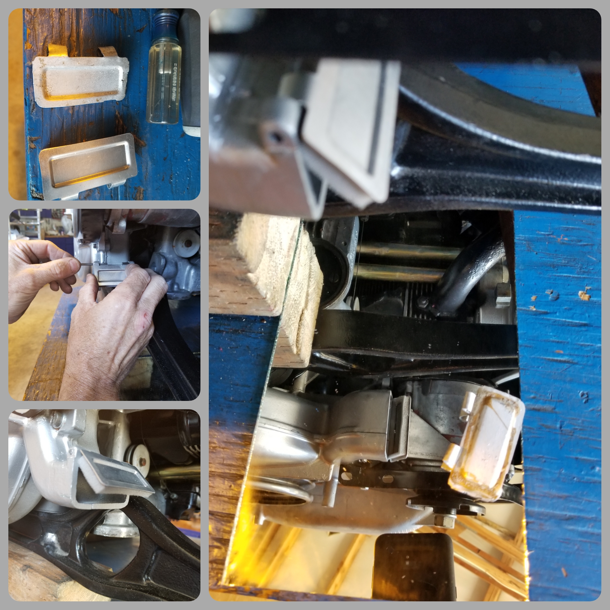

Member No.: 18,454
Alternator and belt installed and adjusted. New alternator inspection covers back on.

Cary's handiwork on the evaporation line fitting and the dressed vacuum line for the throttle body

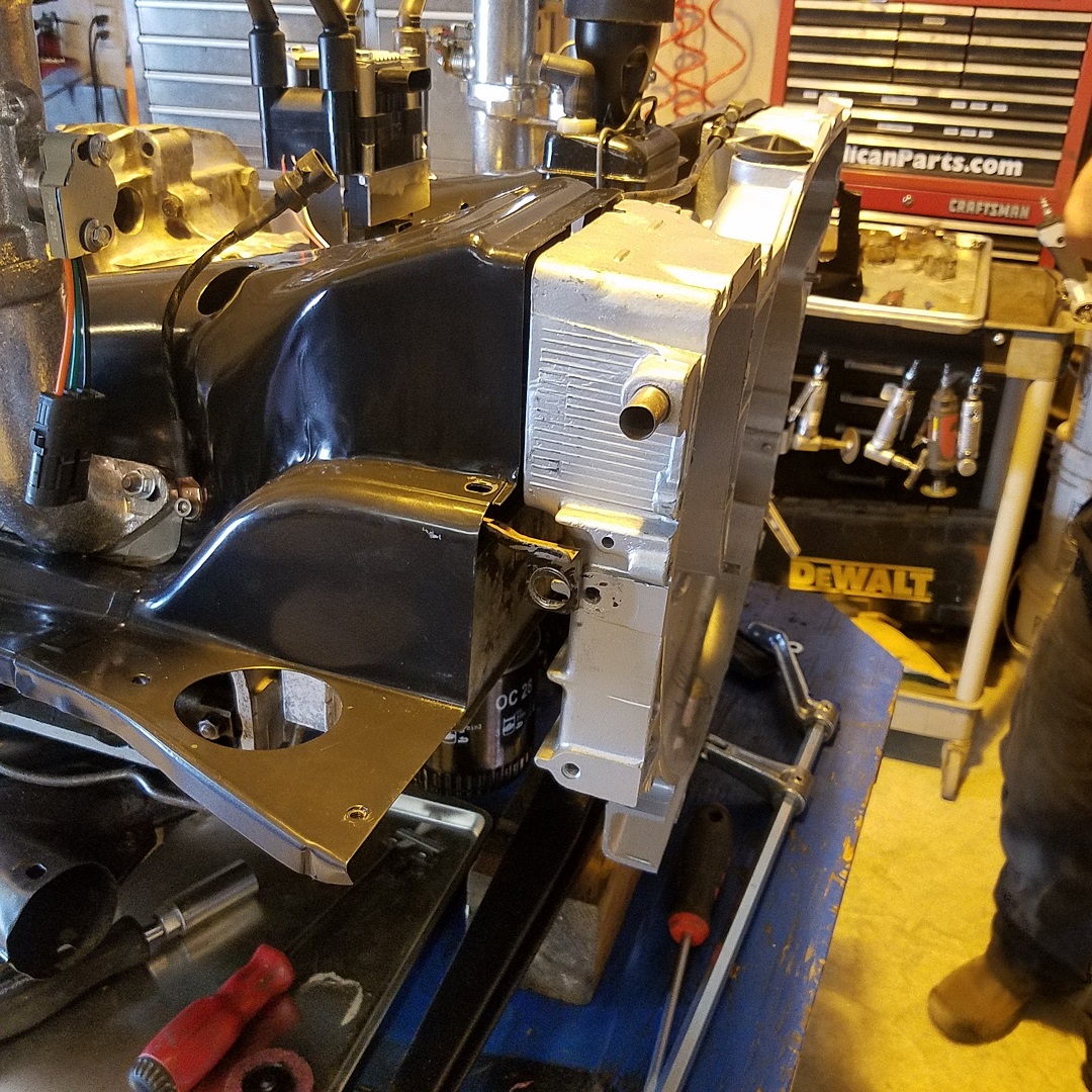

Member No.: 18,454
Engine in the car for harness mockup.

From: Oregon
Member No.: 18,454
Fitting the air/fuel monitor/controller in to the original ECU box along with everything else. Ready with a plan for tomorrow. Adjust the wiring harness with today's fitment info
