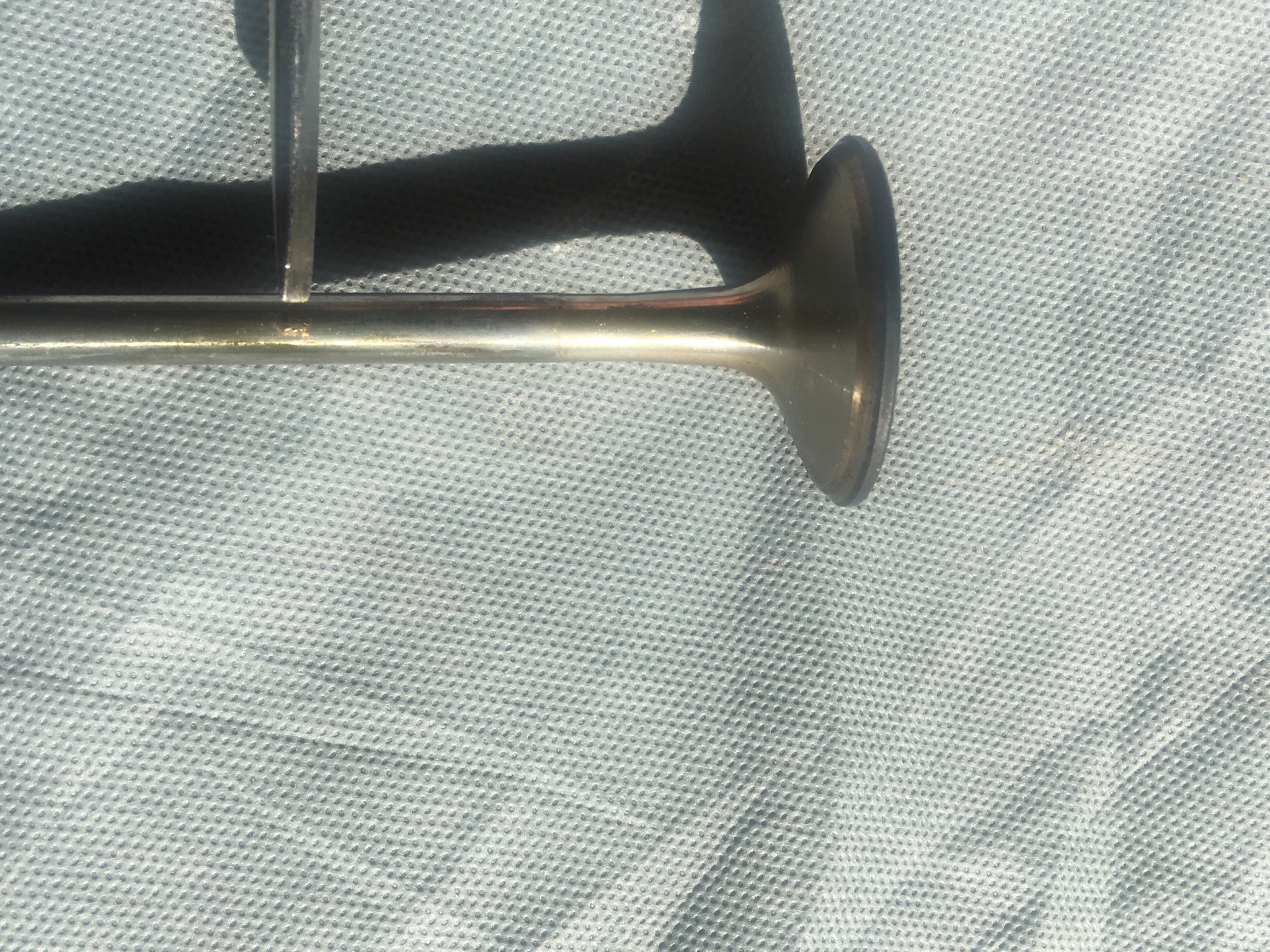

Brass shaving found mid stem

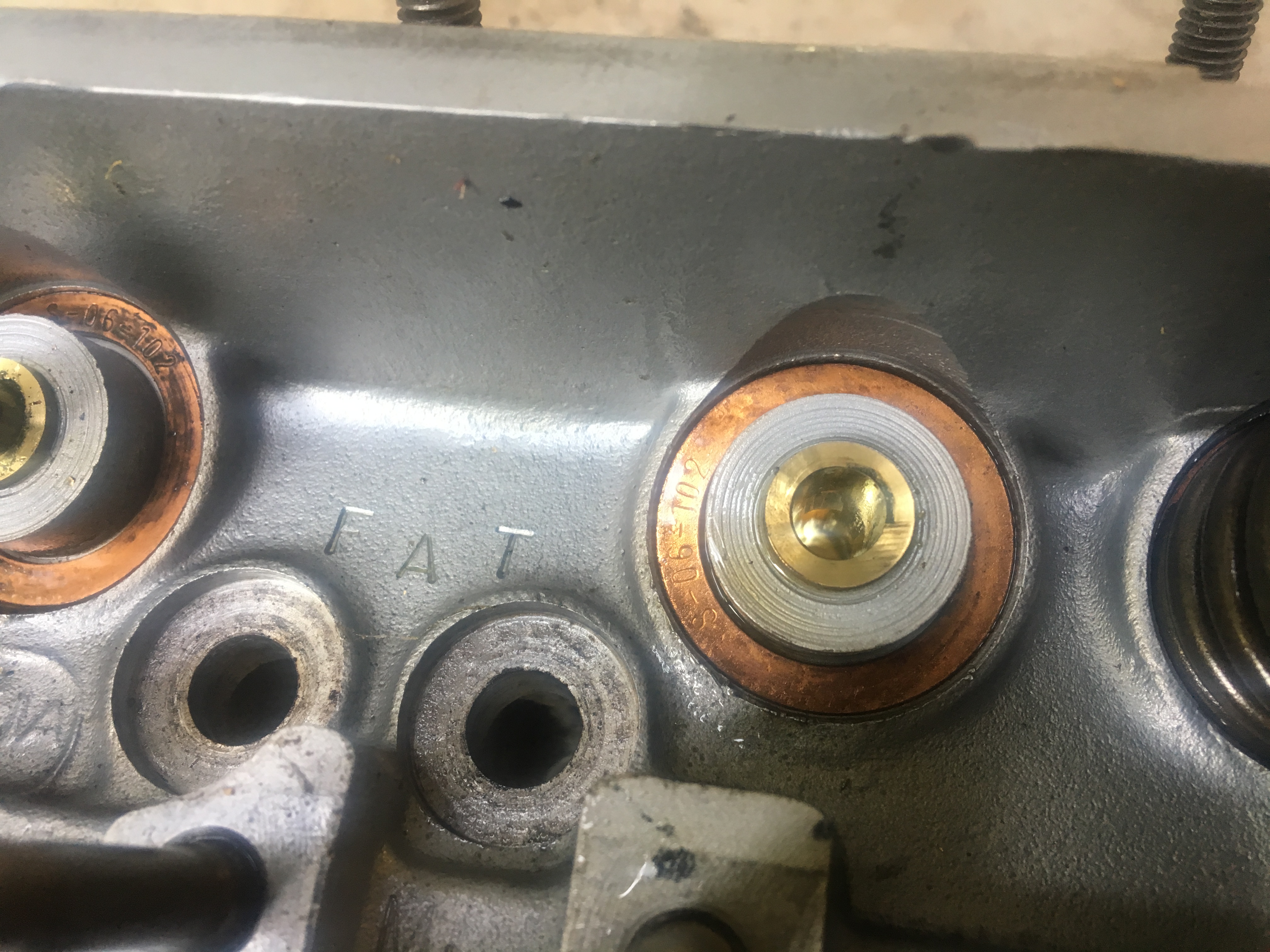

It is hard to make a good photo of this, but looking
down the guide, there are areas that look non uniform. Like
the way wood looks when you have lightly run a chisel over it.
Again, cause or effect? I’m leaning towards imperfect guide reeming.

They used the wrong size reamer ?
Roll that valve stem on a piece of glass and see if it is bent.
How much did they cut/deck the heads?

Hard to see, but definitely tight and a poor job.
When you drive guides in they collapse slightly, so they have to be reamed and honed back to spec.
This is just common procedure, part of the job.

I had this exact same problem once and it was the new valve guides that were not reamed to the correct size. That's why you see the small pieces of brass and gulling marks on the valve stem. Pull the heads and remove all the valves then have someone ream all the new guides to the right size. Ray
