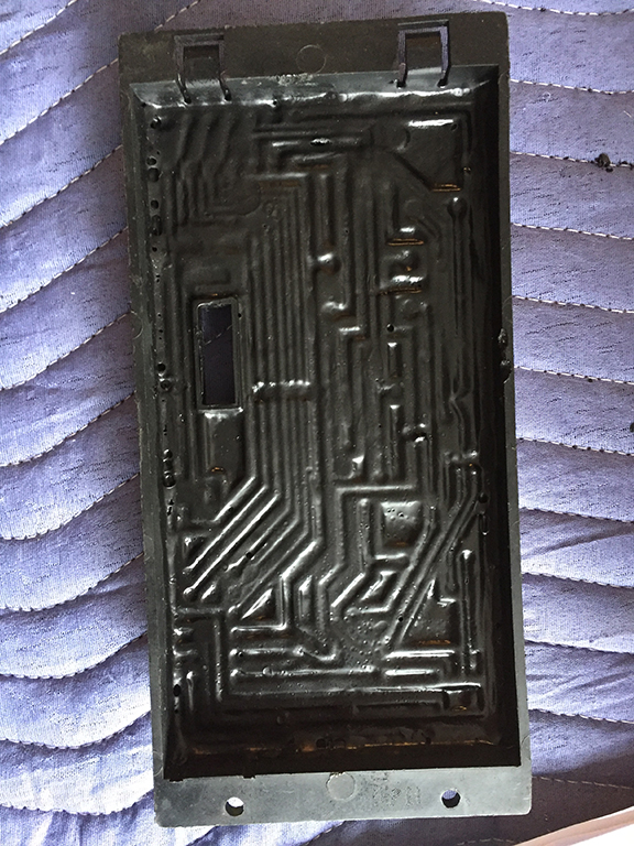

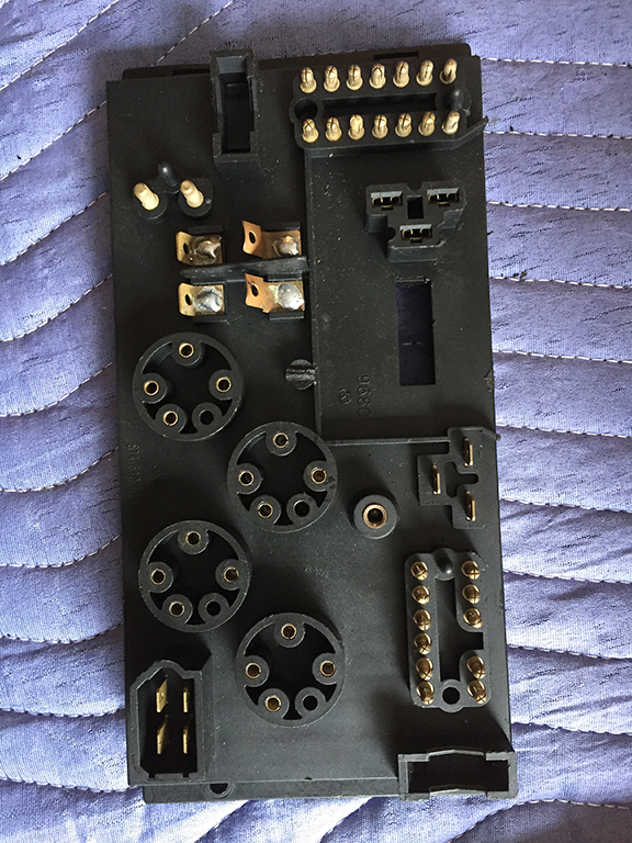

Okay, here's were we are;
Pulled the circuit board checked the bottom which was in pretty good shape. No signs of breech or corrosion. Chipped off a tiny bit under the fuel pump relay and no further evidence of problems so I resealed with epoxy. Next pulled the ECU and ran the resistance or voltage as required to test back thru the wiring all checked out perfect. I then reconnected the ECU, reattached the battery ground, turned the key and WOW, I got that heart warming fuel pump buzz at switch on. Turn over the engine and after several revolutions it fired up! Ran for 10 seconds or so and died. Turn the key to OFF then back ON, again got the buzz but this time it would not fire. Back under the hood to double check that nothing was amiss with the ignition, checked for any vacuum hose loose then tried it again. Same results, fuel pump buzz at ON, but would not fire. Pulled the ECU harness and reassembled, then back to where we were in the beginning, no fuel pump buzz at switch ON.
Looks to me as if I've got a bad ECU, anyone agree or disagree?

Okay, so after a long delay involving travel, photography projects, holidays, flu and snow / cold weather. I finally got back on this project. If you'd care to know the whole background of this mystery jump back to the beginning and follow the various symptoms, suggestions, and fixes tried.
I had proofed the fuel pump by running a jump straight from the battery to fuel pump relay pin 85 on the circuit board, the fuel pump ran continuously, which to me proved to me a) the fuel pump was functioning properly and b) the circuit from pin 85 to the pump was good. I switched out a borrowed ECU and no change as the problem remained. I checked all of the power wiring and power circuit board continuity and all were fine. I removed the steering wheel and found the starter switch had a brown spot indicating it had gotten hot at some point so I replaced it with a new one thinking for sure that was the problem. No change but at least I know have avoided a future problem.
That's where I stopped back in September.
After thinking about it over the winter months I realized I was only thinking about power supply. So I started to check ground. Checking the obvious ground connections with the wiring I then moved to the circuit board. I checked the 14 pin connector to the relay board, pin 10 (ground) to the fuel pump power replay pin 86 by checking the continuity of pin 86 to ground. It failed, no continuity.meaning a bad circuit board!
I located a source for rebuilt circuit board "High Performance House" in Redwood City, CA, installed it yesterday and........
