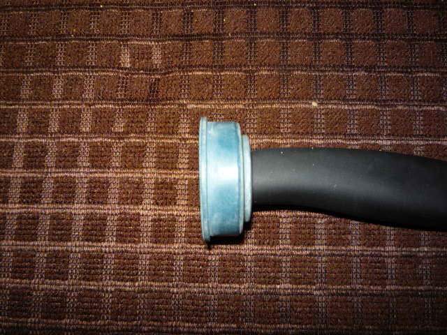

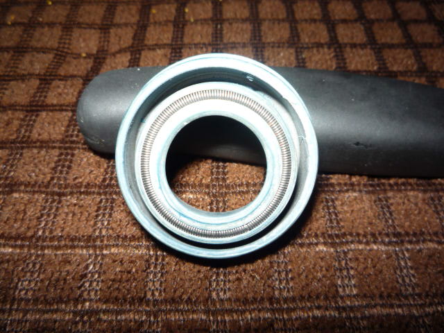

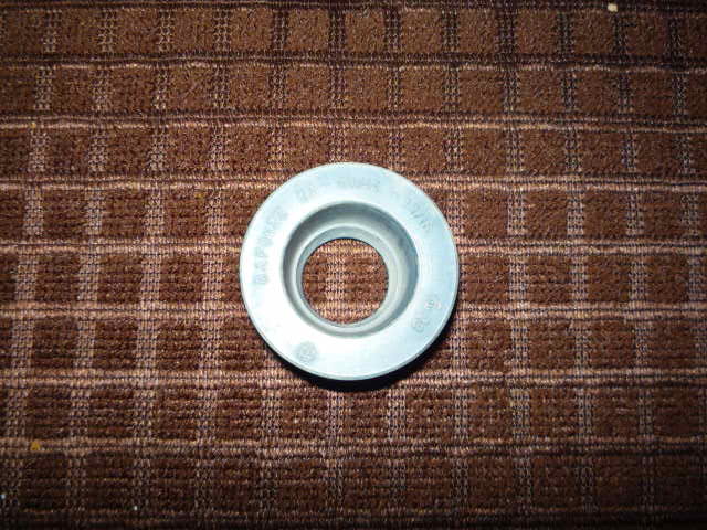

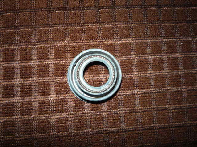

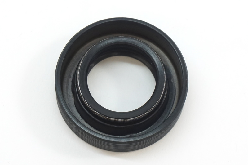

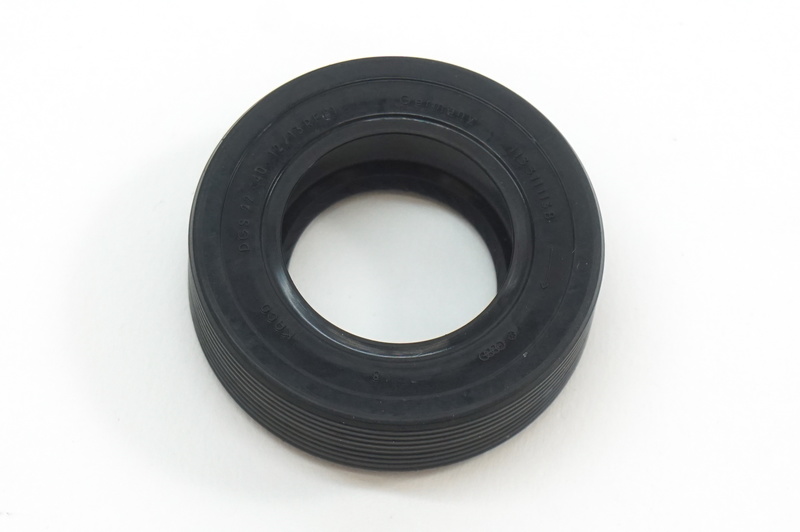

I thought it would be a good time to show what the factory transmission front seal looked like. As you can see it is NOTHING like the replacement seal that is being sold. VW part 113.311.113B
Added picture of Porsche OEM
Attached Image Attached Image Attached Image Attached Image Attached Image Attached Image

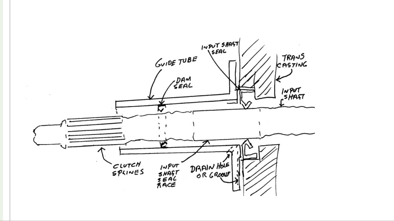

Thanks for all the input. I got all the parts you mentioned above and am ready to go. Do you think I will need a pilot bearing puller or could I fashion something from the assorted pullers in my collection? Also found this diagram about the trans. Let me know if this sort of looks correct.
