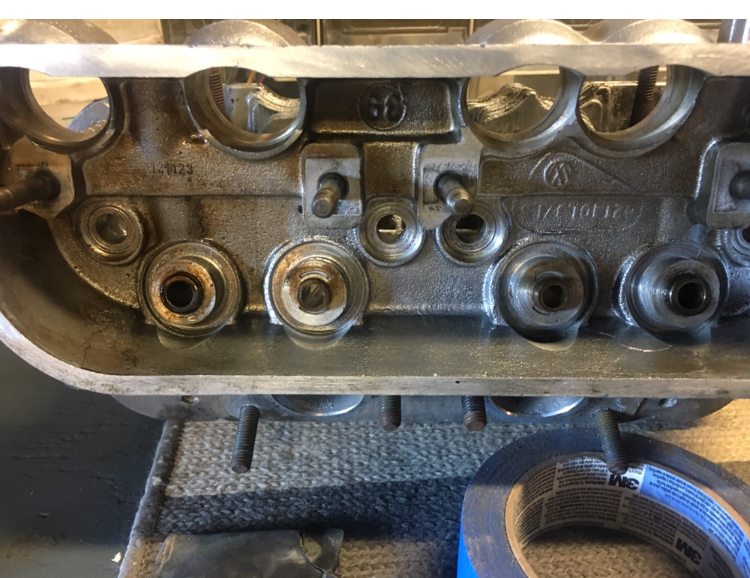

I pulled the 1.8 L motor in order to fix all the rust in hell hole which of course gave me the opportunity to fix a few things.
Pulled the heads as the lifter tubes were all leaking oil profusely.

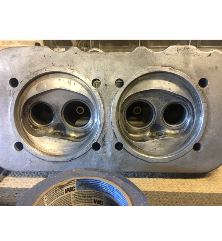

Heads/Valves: Looked to be in good shape with minimal carbon buildup. I was surprised.

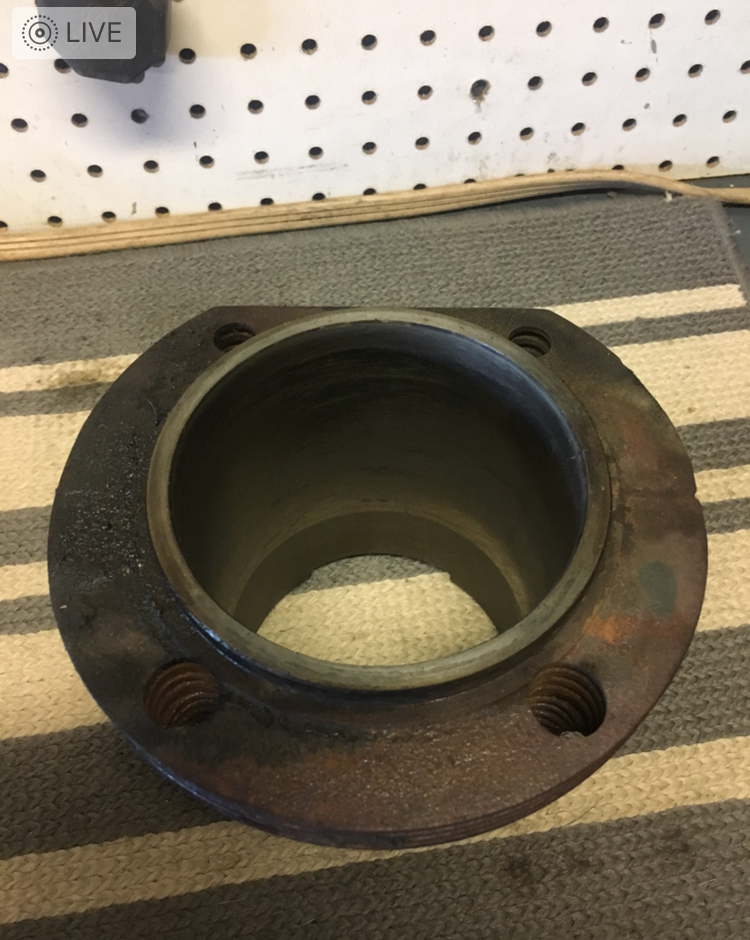

Pistons: Look OK I guess... not sure what they’re supposed to look like? They had light carbon buildup on the top of the Pistons but otherwise seems to be OK.
Questions:
Do I buy a new stock pistons and cylinders? if not should I at least change the rings or does it matter?

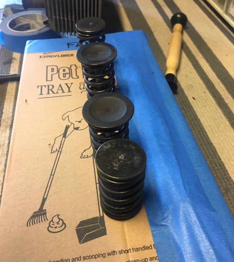

Retyped the post...sorry, I used my phone to post this originally and it was all screwed up.
Added some photos of one of the heads, valves etc.

It looks like you already have the valves out of the heads. Have your local machine shop put 2.0 stainless valves in the heads so the engine can breathe a little easier.

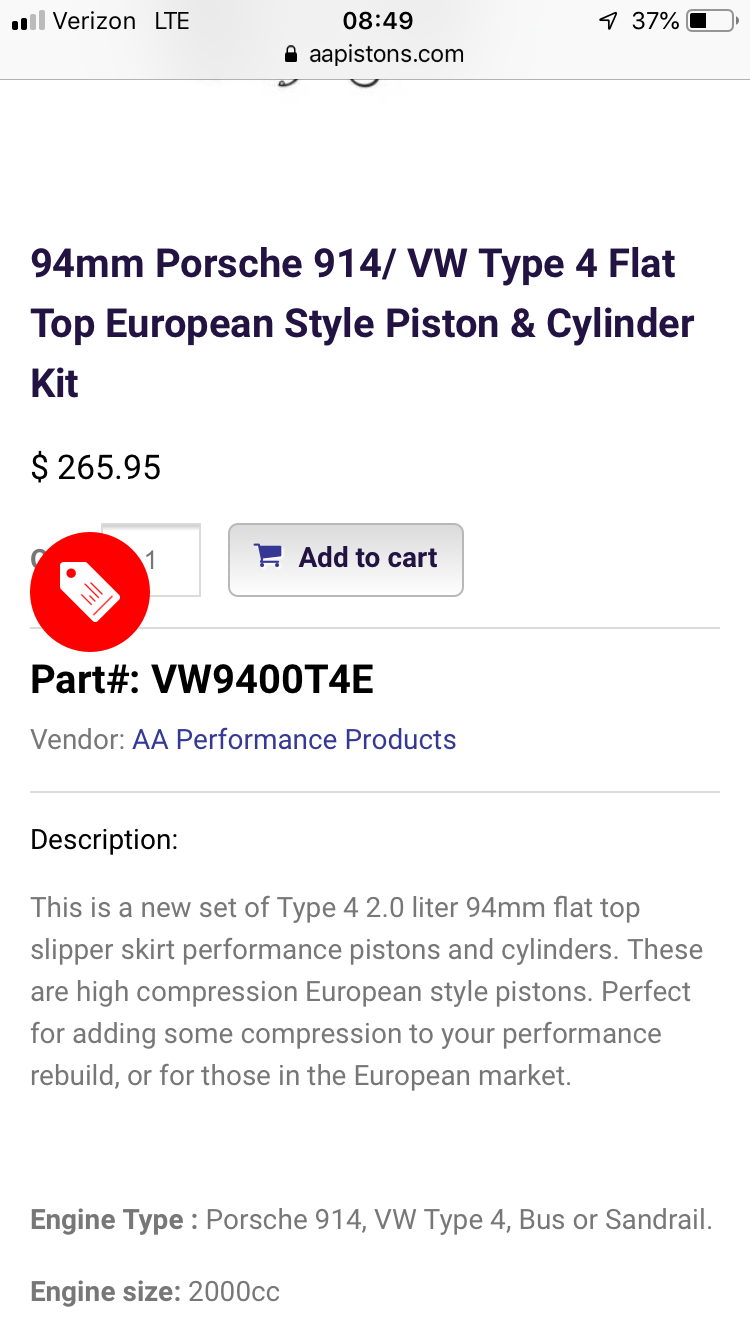

Awesome info!! Thanks!! Would these be the flat tops you suggested,

When you buy pistons, make sure you get the correct pin height. The 2L has a different measure due to the longer stroke.
There are 94 and 96 pistons for the 1.7/1.8 crank, if that's what you want to do.
Regarding the oil pump, the type 1 has no advantage over the type 4. On the contrary, it's a bit of a headache to get the right one and to make it fit. It also has more places to leak from. The only reason for a type 1 is if your type 4 is bad and can't find a new one (NLA)

You probably want these if not planning to replace the crank.
https://aapistons.com/collections/porsche-p...der-kit-914-bus
