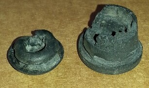

I'm looking for a source or a suitable substitute for the grommets for the fog light and horn wires exiting the body then the smaller grommet for the wires entering the fog light housing.
What have others done?

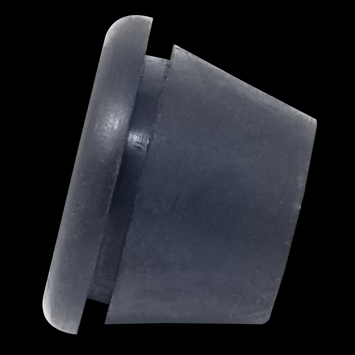

The cone shaped one is part # 311.971.909 and I got mine from Wolfsburg West http://www.wolfsburgwest.com/cart/DetailsL...fm?ID=311971909
I haven't been able to track down that small one yet despite a lot of searching. (IMG:style_emoticons/default/popcorn[1].gif)

https://www.ebay.co.uk/itm/Blanking-Grommet...redirect=mobile

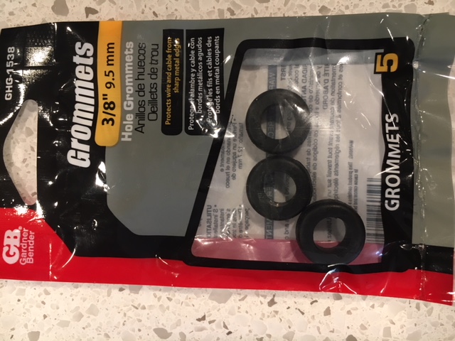

Bought several sizes of these at the now defunct Orchard Supply Hardware. I would try Lowes or Home Depot. These are 3/8" and fit perfectly for the fog lights.

I got mine from 914rubber, ordered them via the phone since I couldn't find them on the website.
I also bought a couple packages of grommets from Orchard Supply but didn't use them.
