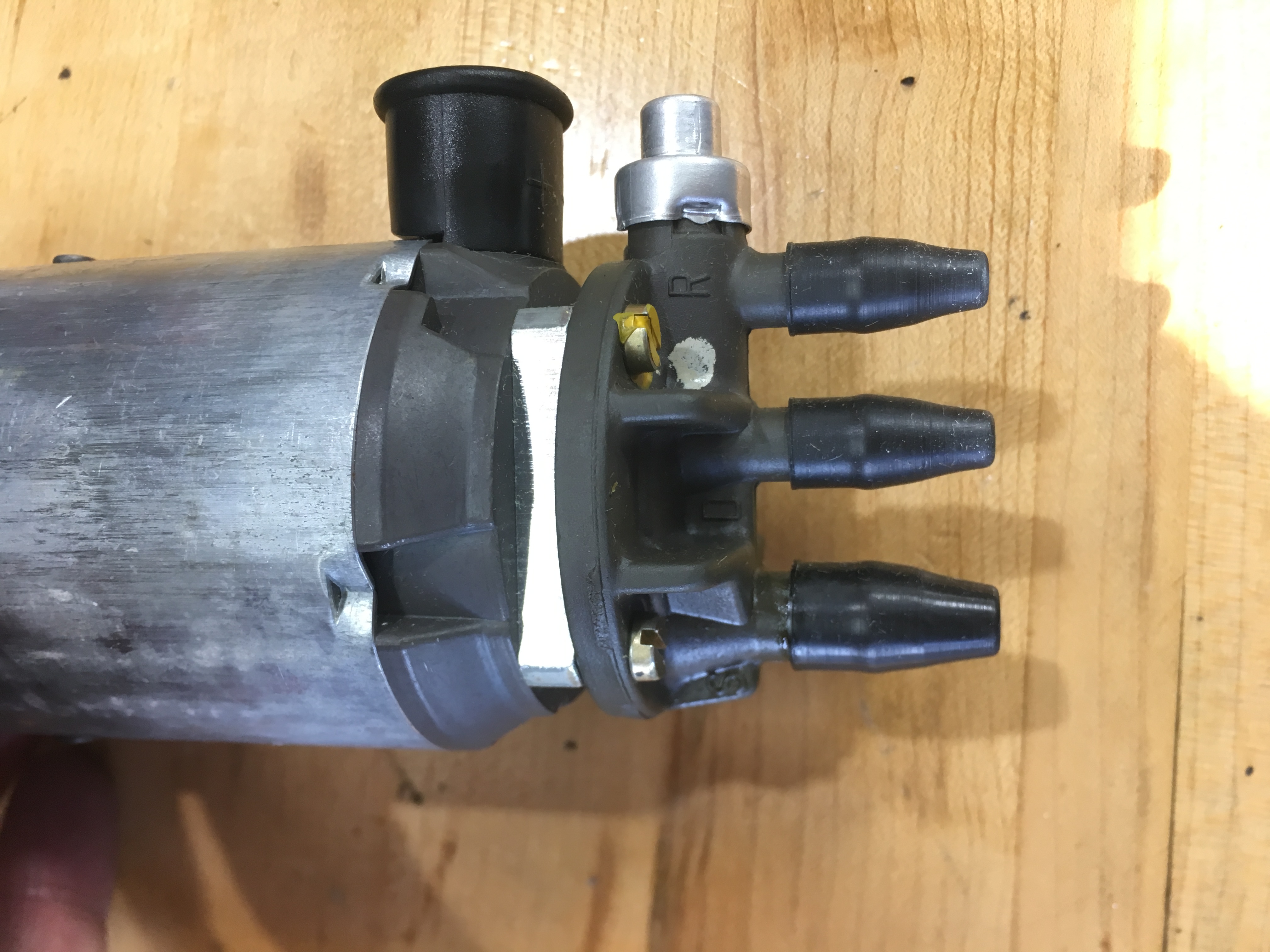

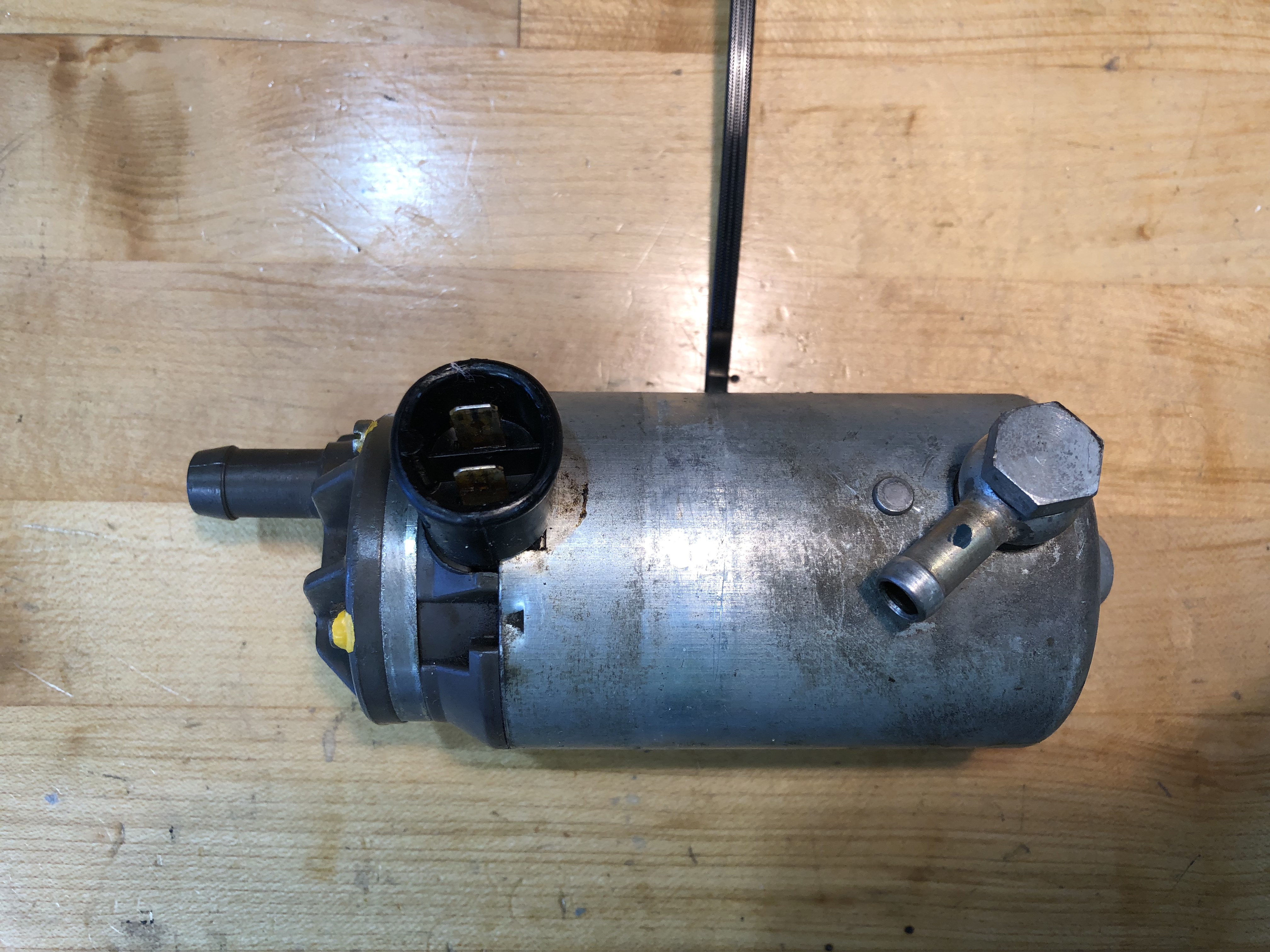

(IMG:style_emoticons/default/agree.gif) My 911 had a high pressure CIS pump and PMO regulator which I removed and installed the carburetor version, Bosch #05802544985, used on 911-T and the 914/6. There is no need for a regulator as the this Bosch pump is pre-set for optimal pressure and the return is already designed into the pump.
As for a carburetor regulator, if you can get the pressure in range I'd prefer and Aeromotive or similar with return feature. Summit Racing or Jegs has a good selection.
