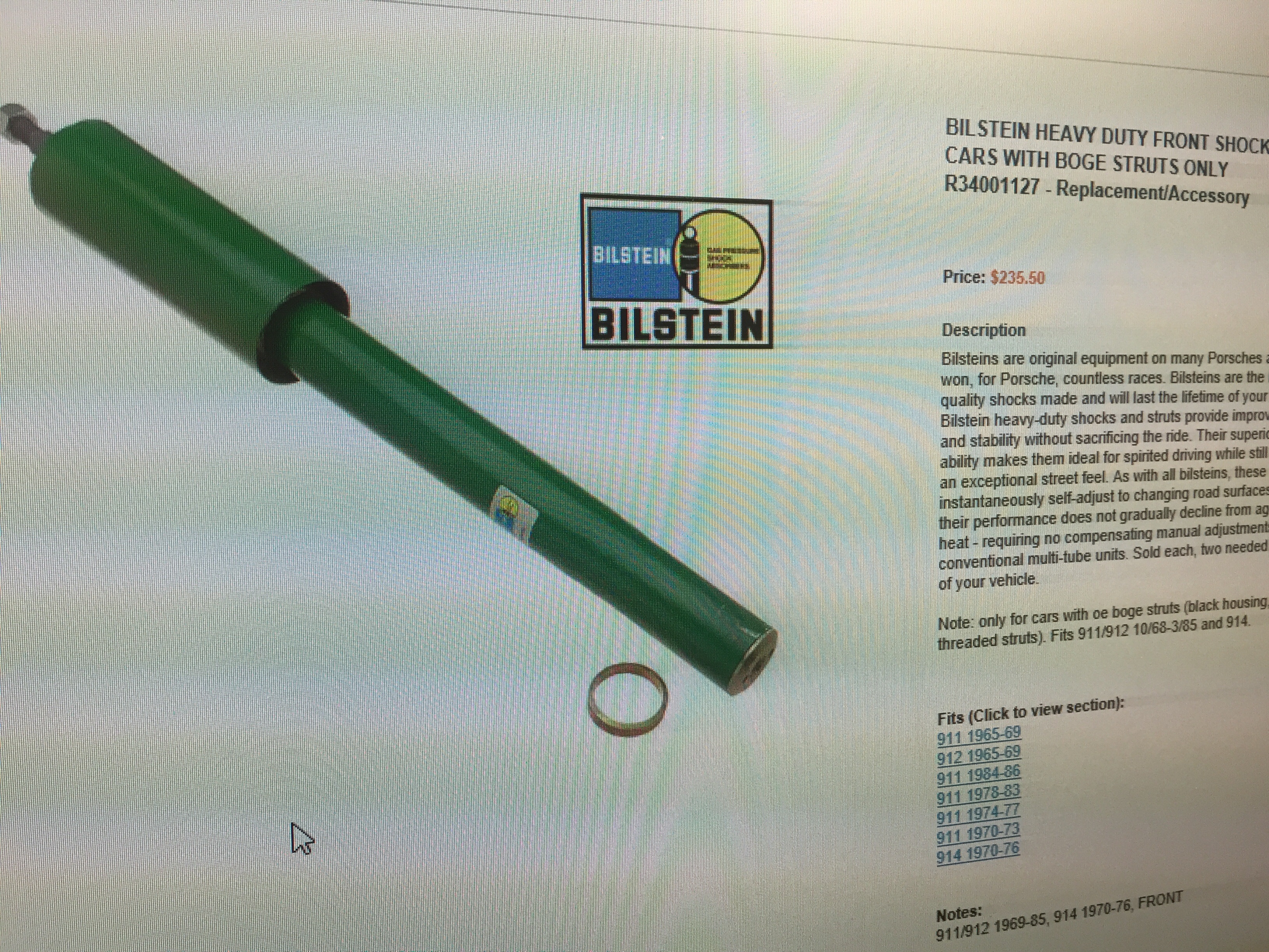

these?

QUOTE(DRPHIL914 @ Dec 3 2018, 09:24 AM) *
these?
yes
Drive them a couple miles before you get them aligned. It gives them a chance to settle in a bit. Doesn't need to be much. Leave on the rears for now and see how you like the ride.
New front shocks make a big difference. You will love the ride and wonder why you didn't do it sooner.

looks like the #001127 is HD and 34 is regular?
thmotorsports has these for $168,
and $167 at Summit Racing. Looks like those are the best price for the HD’s.
once in it will be interesting to see how it feels and how it balances out.
