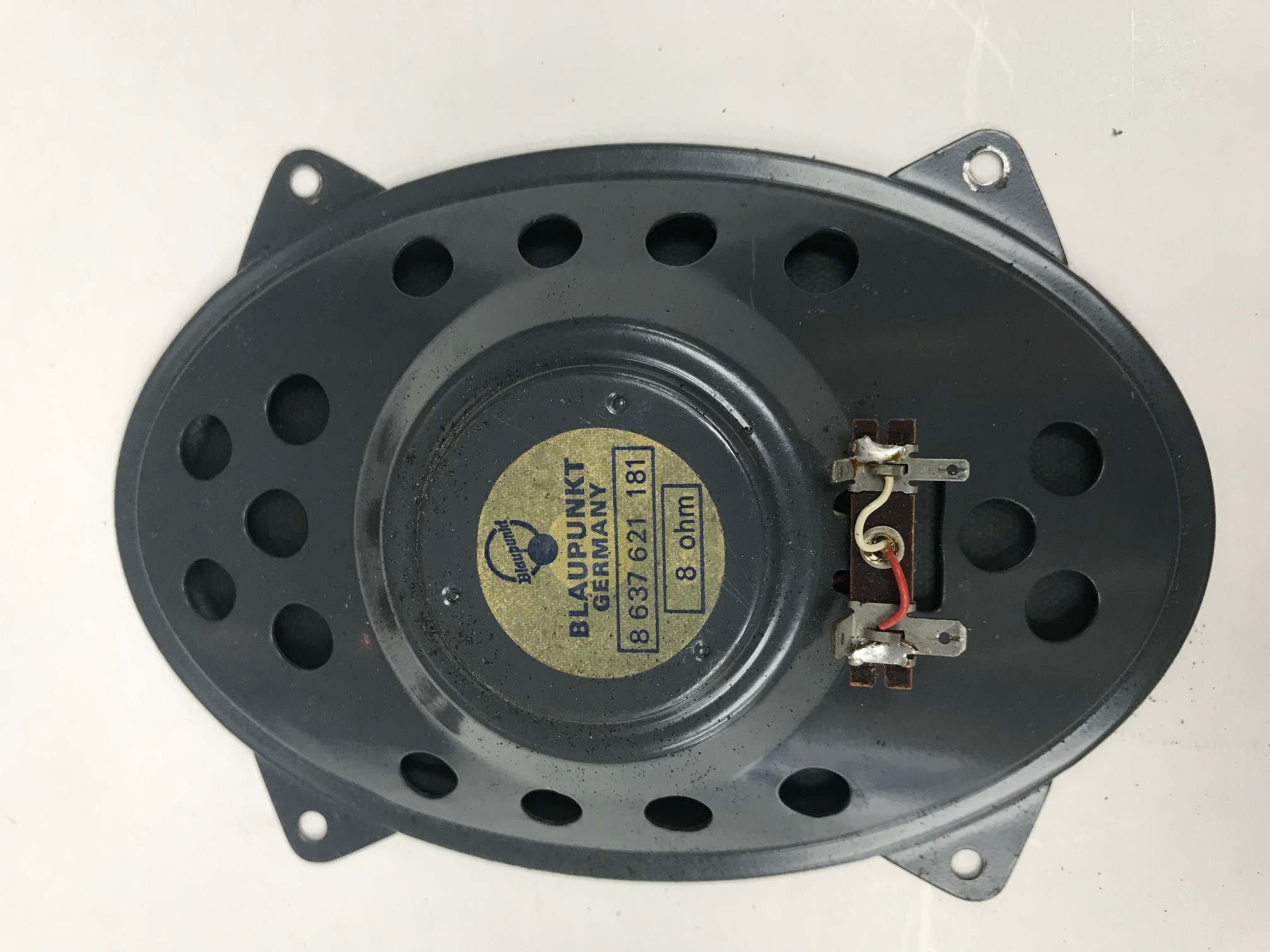

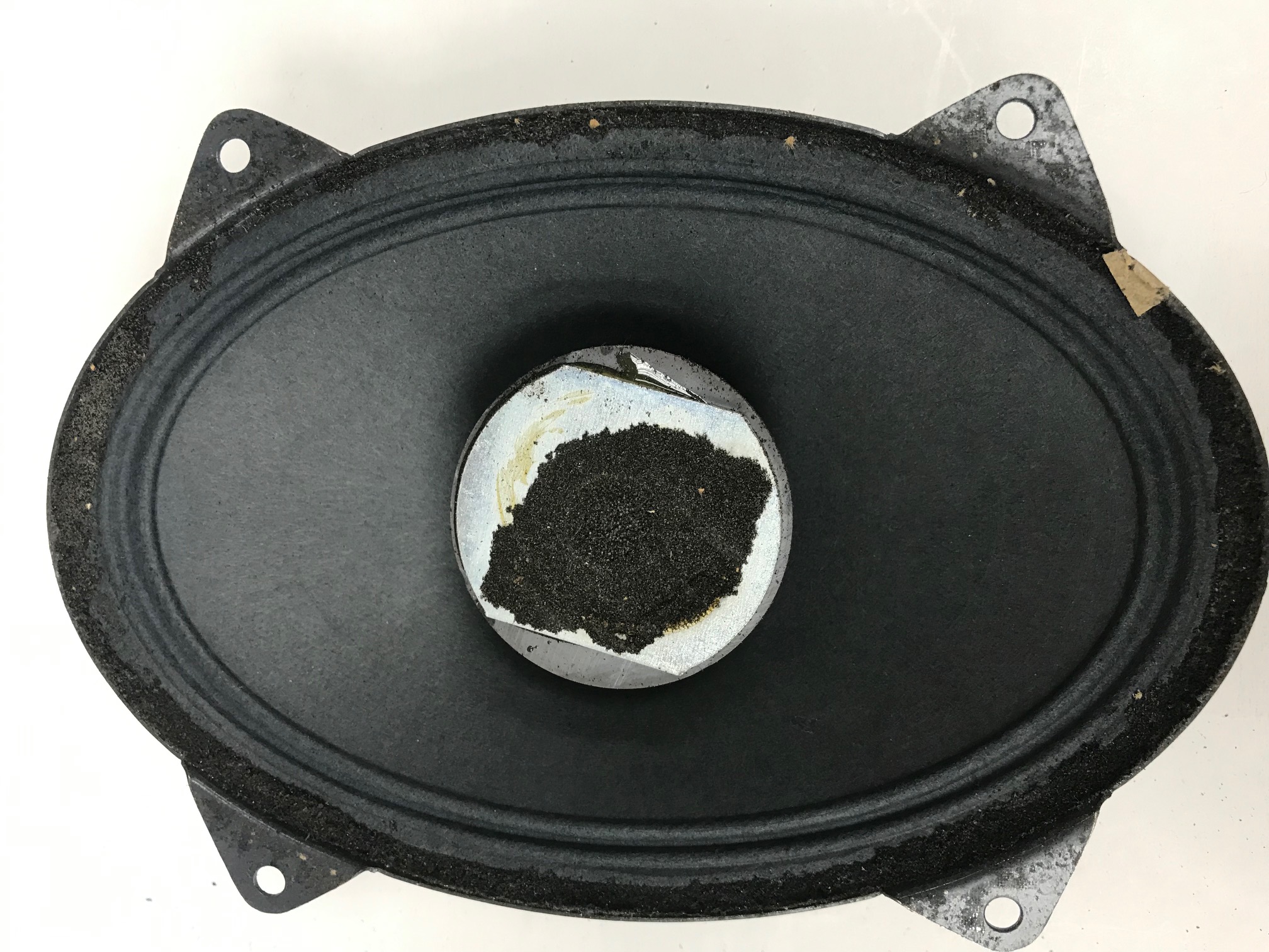

The closest I’ve got to these speakers is this place in germany
https://www.koenigs-klassik-radios.de/en/lo...r-cars/a-31149/
The foam needs some trimming as did the metal frame very slightly at the top but they fitted for me, but it was still very tight if the heater pipes are installed behind
