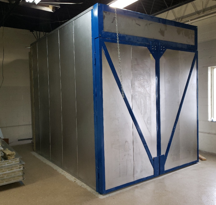

You should get a proper sized oven like mine (IMG:style_emoticons/default/biggrin.gif)

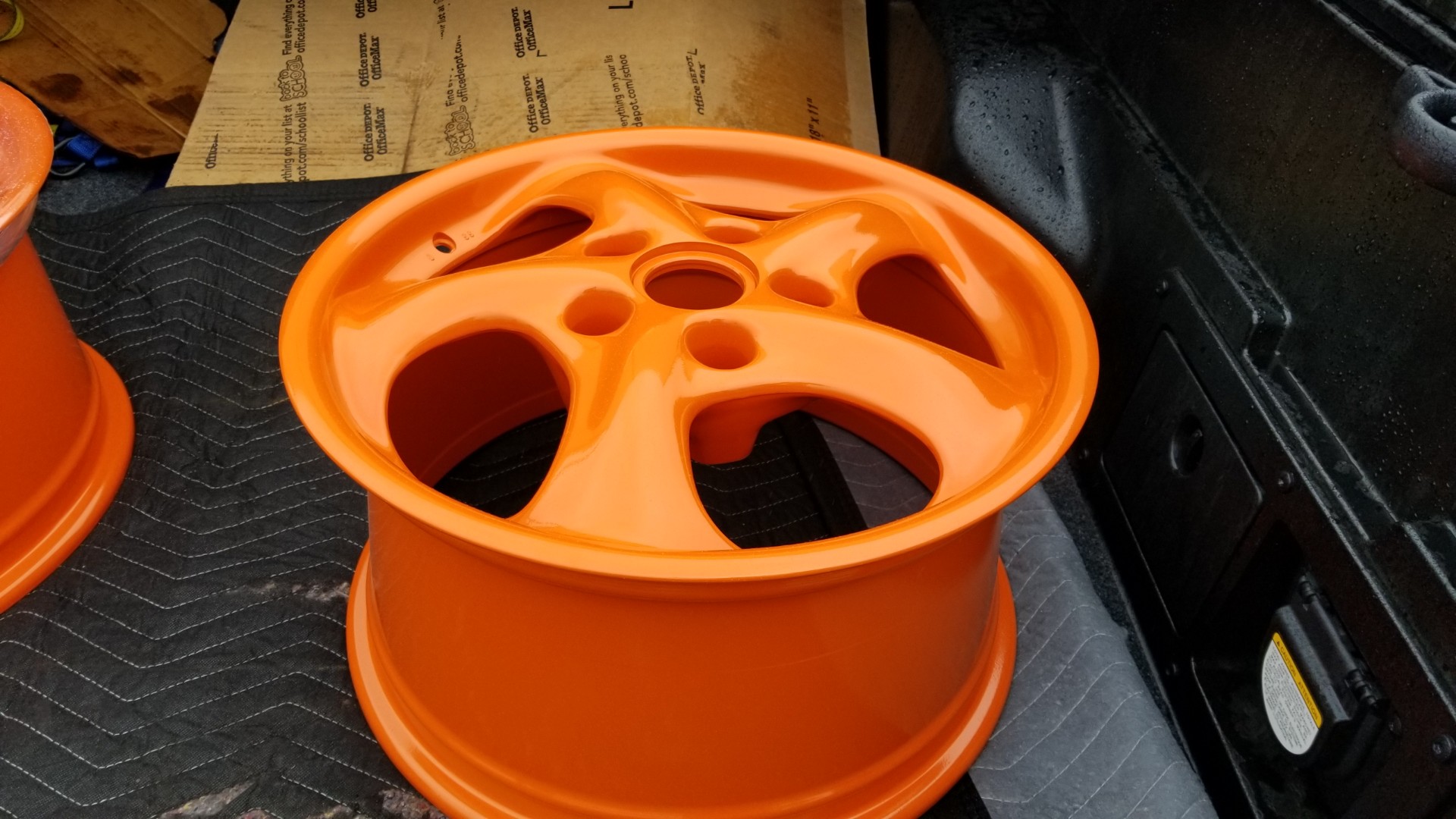

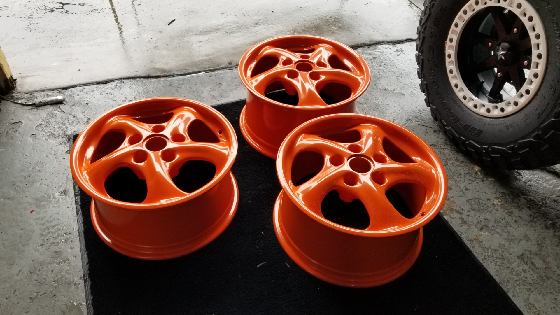

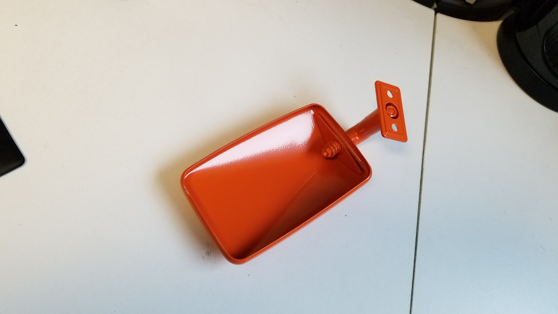

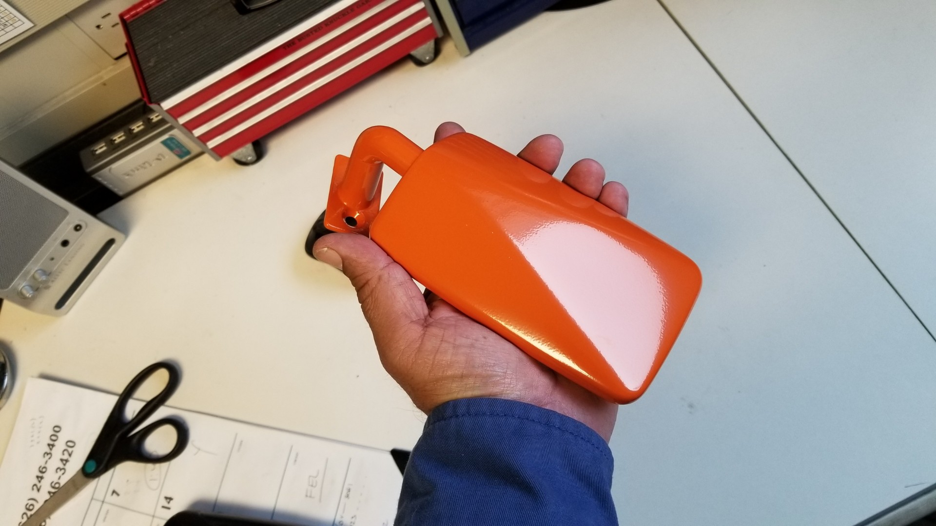

Well...here's some pictures of my first attempt. Now I have to mount my tires back. SIGNAL ORANGE. I should have cleared them. A little orange peel but okay for me.
Used: Red Line EZ50 Gun, Lab Metal (nick filler), 2010 Signal Orange powder.
Cured @ 380 deg (Part Temp) for 15 min.
A bit messy...next time I'm wearing ear plugs.

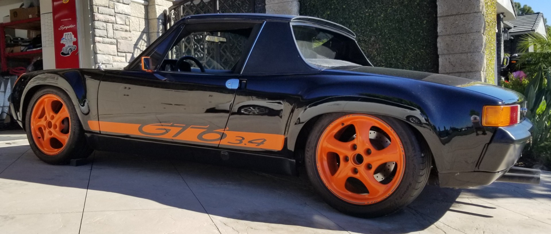

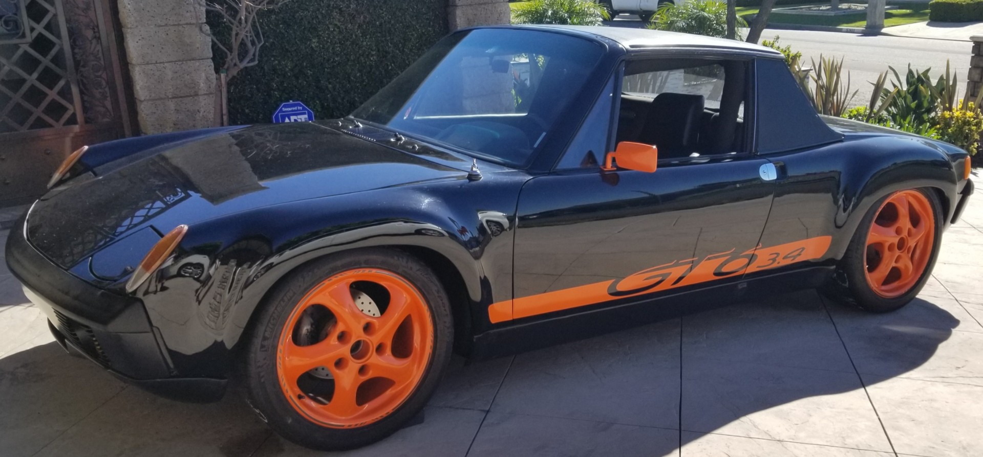

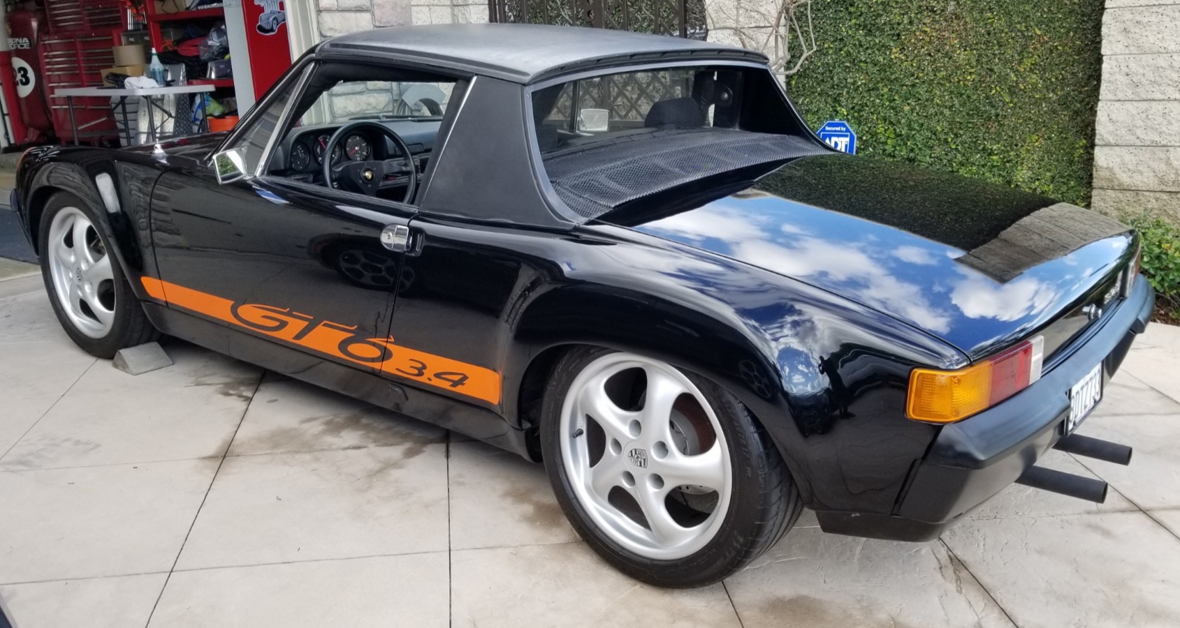

Going for this color scheme...for now

Oscar, some of that orange peel may be from too low of heat and not long enough cure time.
IIRC you have a higher heat until the powder flows, then down a bit for 20 min or so, bigger items may take longer....

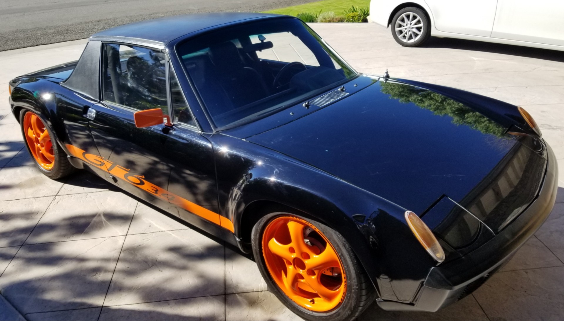

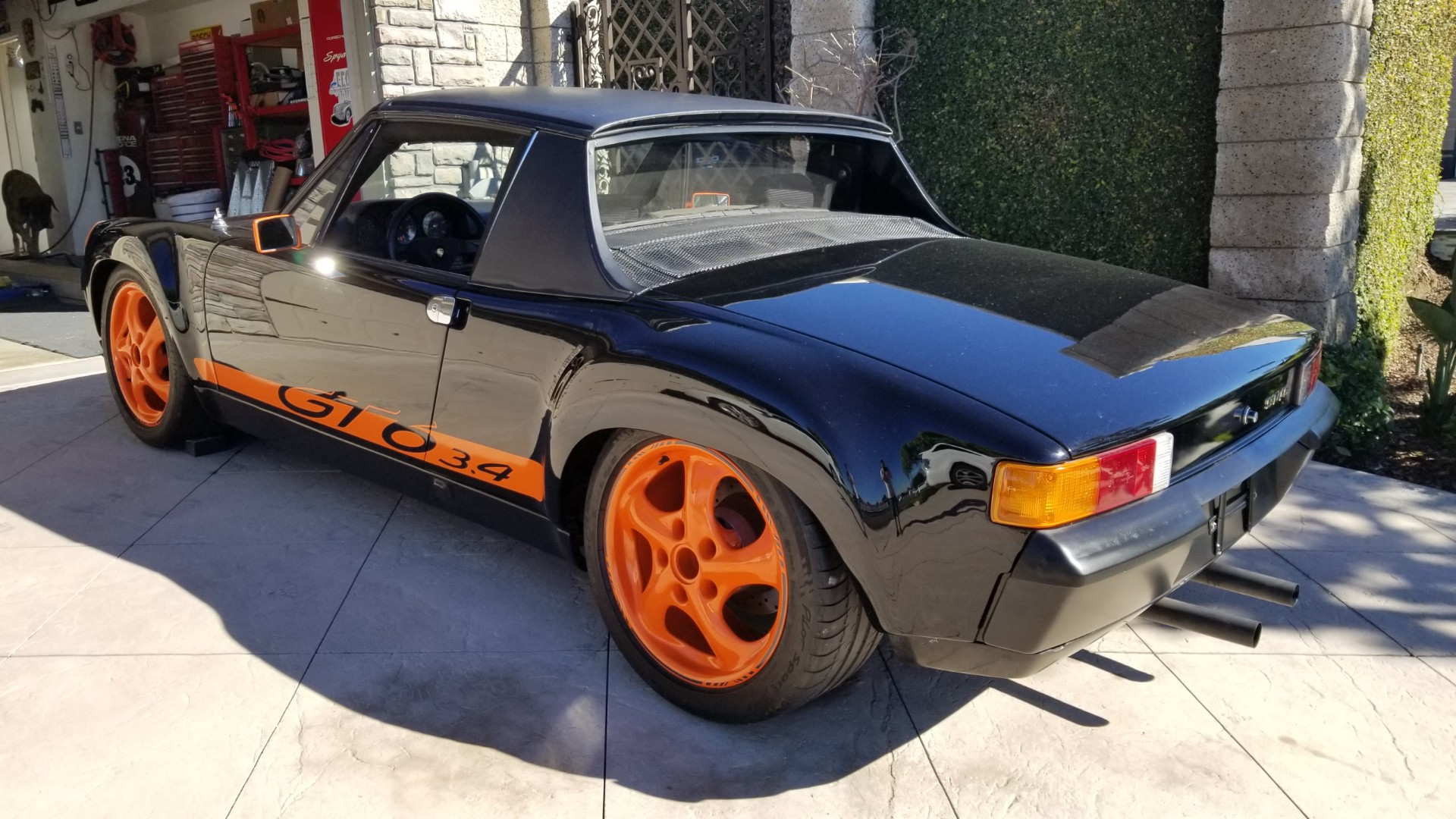

Yes...ready for Halloween Attached Image Attached ImageAttached ImageAttached Image[attachmentid=682

That is way cool!! Nice way to break up the black!!
