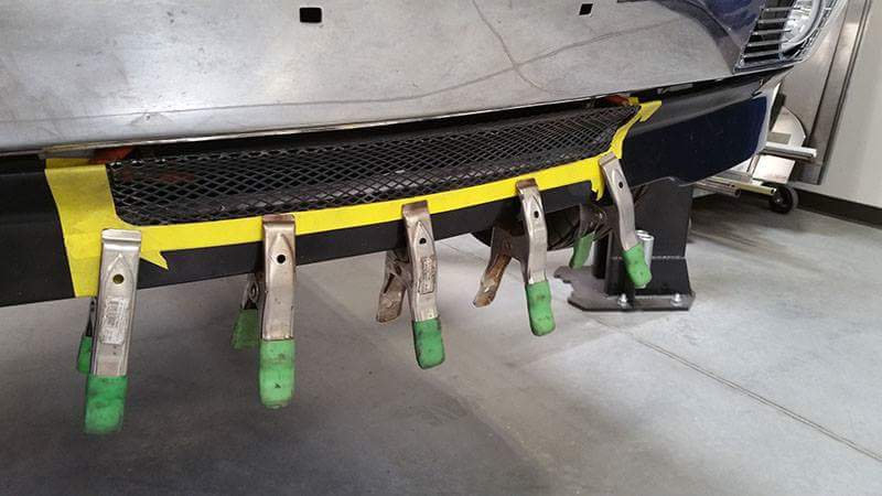

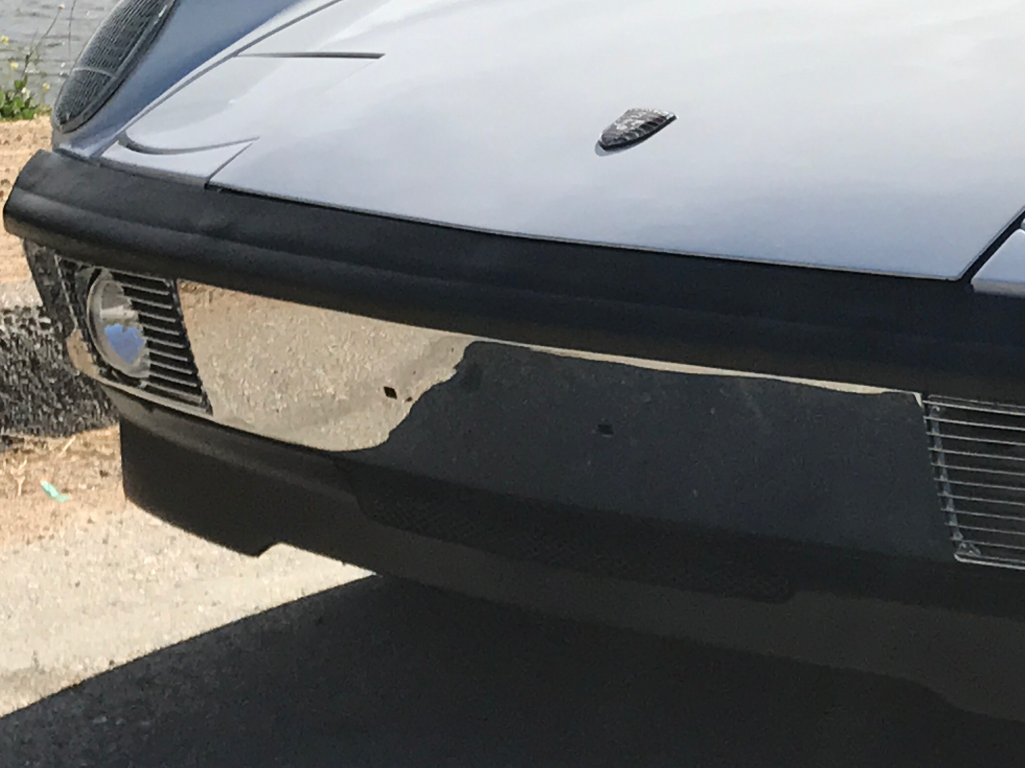

Running a 3.2, with a uncut bumper and a custom cut LE spoiler.
Renegade hybrid is who you should be asking, they make a front spoiler that is designed to scoop in the air. You could probably use the fog light grills as a additional way to hide the additional cutouts you may need to bring in extra air ???

Well done valence modification!
