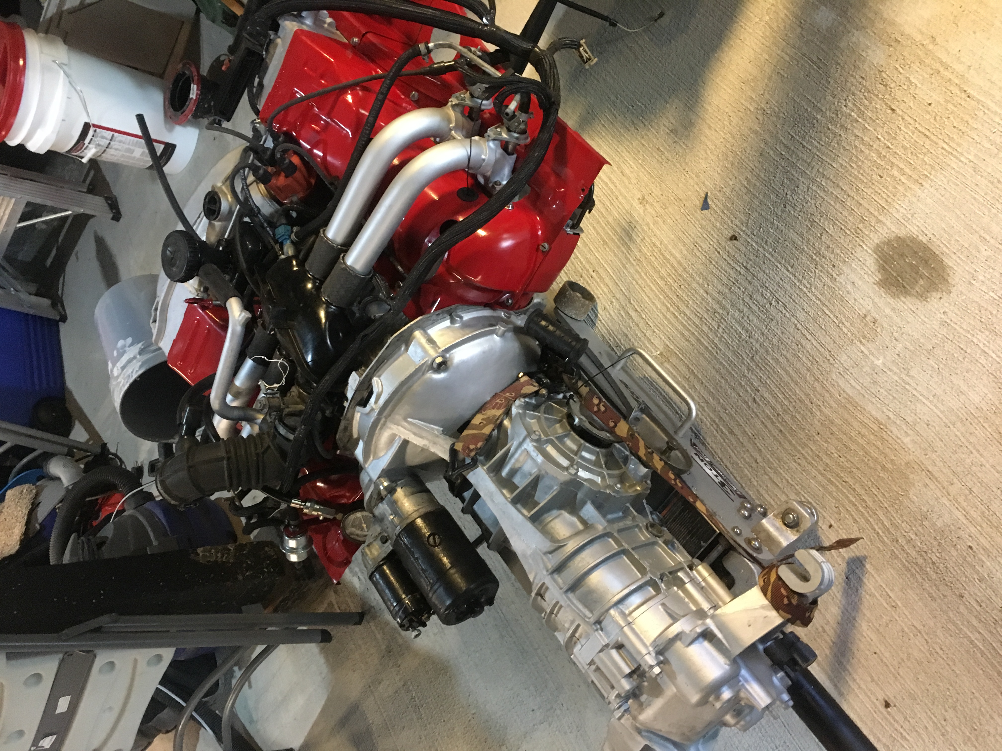

John90290

IronHillRestorations
post Jan 26 2019, 02:30 PM
I. I. R. C.
Posts: 6,926
Joined: 18-March 03
From: West TN
Member No.: 439
What kind of injectors? Does not look stock to me.
74ravenna
post Jan 26 2019, 04:09 PM
Posts: 479
Joined: 19-October 14
From: nh
Member No.: 18,032
QUOTE(John90290 @ Jan 26 2019, 12:58 PM) *
Togetherness
How do you get your transmission to look like that!? (IMG:style_emoticons/default/smilie_pokal.gif)
post Jan 26 2019, 09:23 PM
I. I. R. C.
Posts: 6,926
Joined: 18-March 03
From: West TN
Member No.: 439
QUOTE(74ravenna @ Jan 26 2019, 02:09 PM) *
Togetherness
Aluminum colored spray paint is my guess
jcd914
post Jan 26 2019, 11:05 PM
Posts: 2,096
Joined: 7-February 08
From: Sacramento, CA
Member No.: 8,684
QUOTE(IronHillRestorations @ Jan 26 2019, 12:30 PM) *
Looks like L-jet that would have come on a1.8l.
Engine and transmission look great!
I would not use the cloth braided fuel hose, it does not hold up to the fuel we have with ethenol in it.
A fuel leak in a fuel hose with 30psi behind it is not something you want to have.
Jim
John90290
post Jan 28 2019, 11:15 AM
Posts: 93
Joined: 4-March 18
From: Ventura, CA
Member No.: 21,937
QUOTE(jcd914 @ Jan 26 2019, 09:05 PM) *
Jim
Thanks for the tip on the fuel line. I will replace asap. I increased the piston size a bit from stock from the stock 1.8 and went with 2.0 injectors.
jcd914
post Jan 28 2019, 06:58 PM
Posts: 2,096
Member No.: 8,684
QUOTE(John90290 @ Jan 28 2019, 09:15 AM) *
I would not use the cloth braided fuel hose, it does not hold up to the fuel we have with ethanol in it.
Jim
You need to get Fuel Injection hose that is rated for high pressure and ethanol.
I think the SAE rating is 30R9 and most flap carry some of it. The 2 flaps near my house had either 30R7 (old spec) or only a short chunk of 30R9 but 1 of them ordered some for stock and I came back 2 days latter for it.
Did you go up to 96mm pistons?
That make a 1910 with the short stroke 1.8 crank, they have a reputation for being a nice engine when dialed in.
Jim
914_teener
post Jan 28 2019, 07:09 PM
Posts: 5,270
Joined: 31-August 08
From: So. Cal
Member No.: 9,489
Jim
Well...if those are Djet 2.0 injectors, they won.t work with L jet sorry to say IIRC.
Nice looking build.
jcd914
post Jan 28 2019, 07:14 PM
Posts: 2,096
Member No.: 8,684
QUOTE(914_teener @ Jan 28 2019, 05:09 PM) *
Jim
Nice looking build.
In the picture they look like L-jet injectors to me.

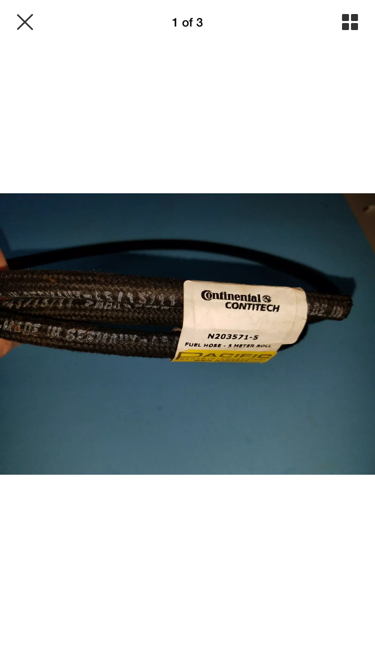

John90290
post Jan 28 2019, 09:00 PM
Posts: 93
Joined: 4-March 18
From: Ventura, CA
Member No.: 21,937
This is the braided fuel line I bought that is currently on the car . Injectors are Bosch fj707.
VaccaRabite
post Jan 28 2019, 09:35 PM
En Garde!
Posts: 13,845
Joined: 15-December 03
From: Dallastown, PA
Member No.: 1,435
Get rid of the braided line. Get FI ethenol rated line. That's a nice engine. Would suck to loose it and your car in a fire.
Zach
John90290
post Jan 28 2019, 09:46 PM
Posts: 93
Joined: 4-March 18
From: Ventura, CA
Member No.: 21,937
QUOTE(VaccaRabite @ Jan 28 2019, 07:35 PM) *
Zach
Got the 30R9 on the way as I write this. Thanks for the heads up on braided line, had no idea.
John
