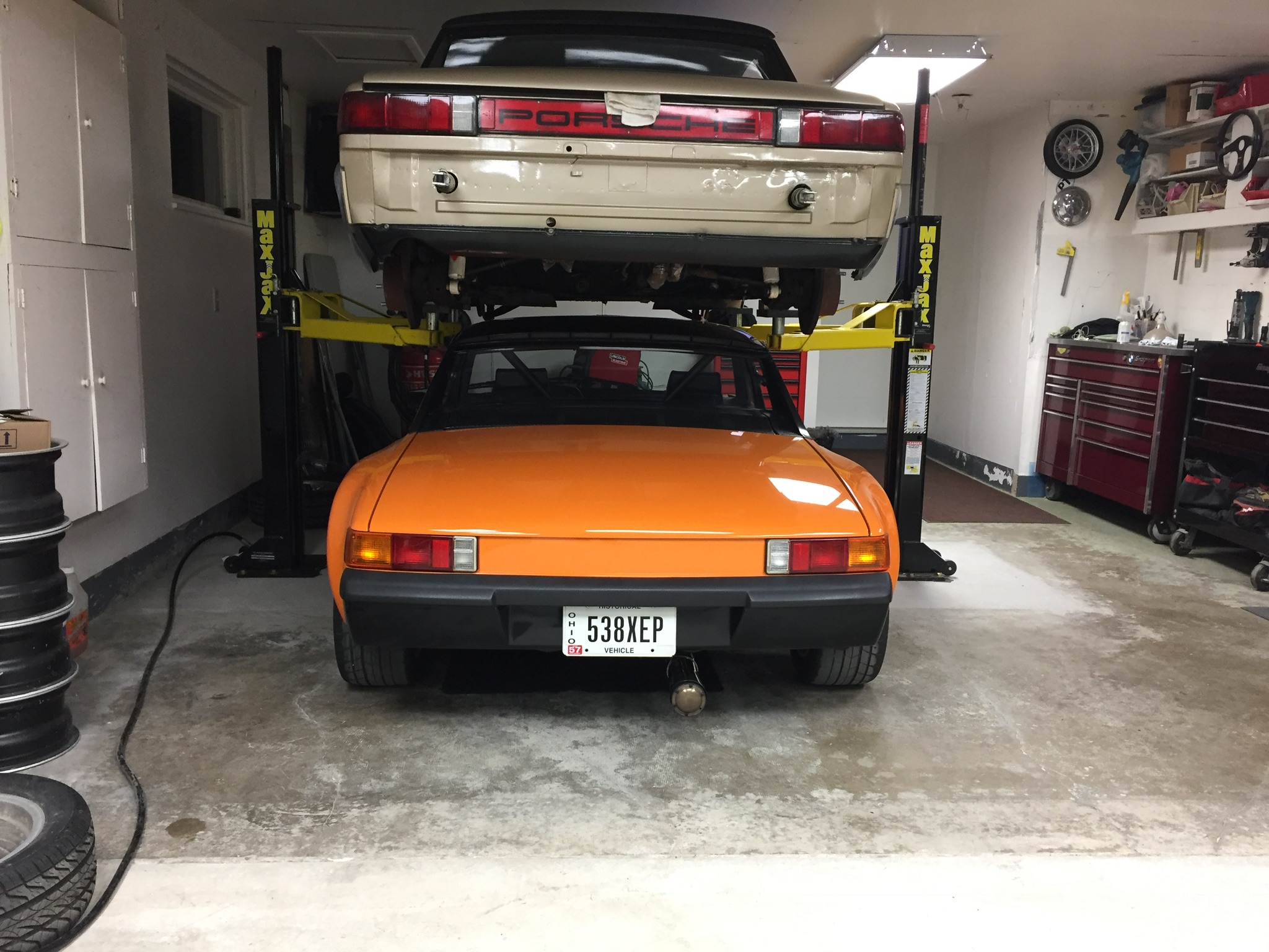

I have this one:
https://www.maxjaxusa.com/buy-purchase-maxj...rd-package.html
I really like it and you can unbolt one side and leave the other installed to have more room when not in use. (it has wheels) I just cover the holes in the floor with a matt when not installed. If I remember the anchoring system goes 4-5" in the floor and there are 7? anchors per post.
Good luck!

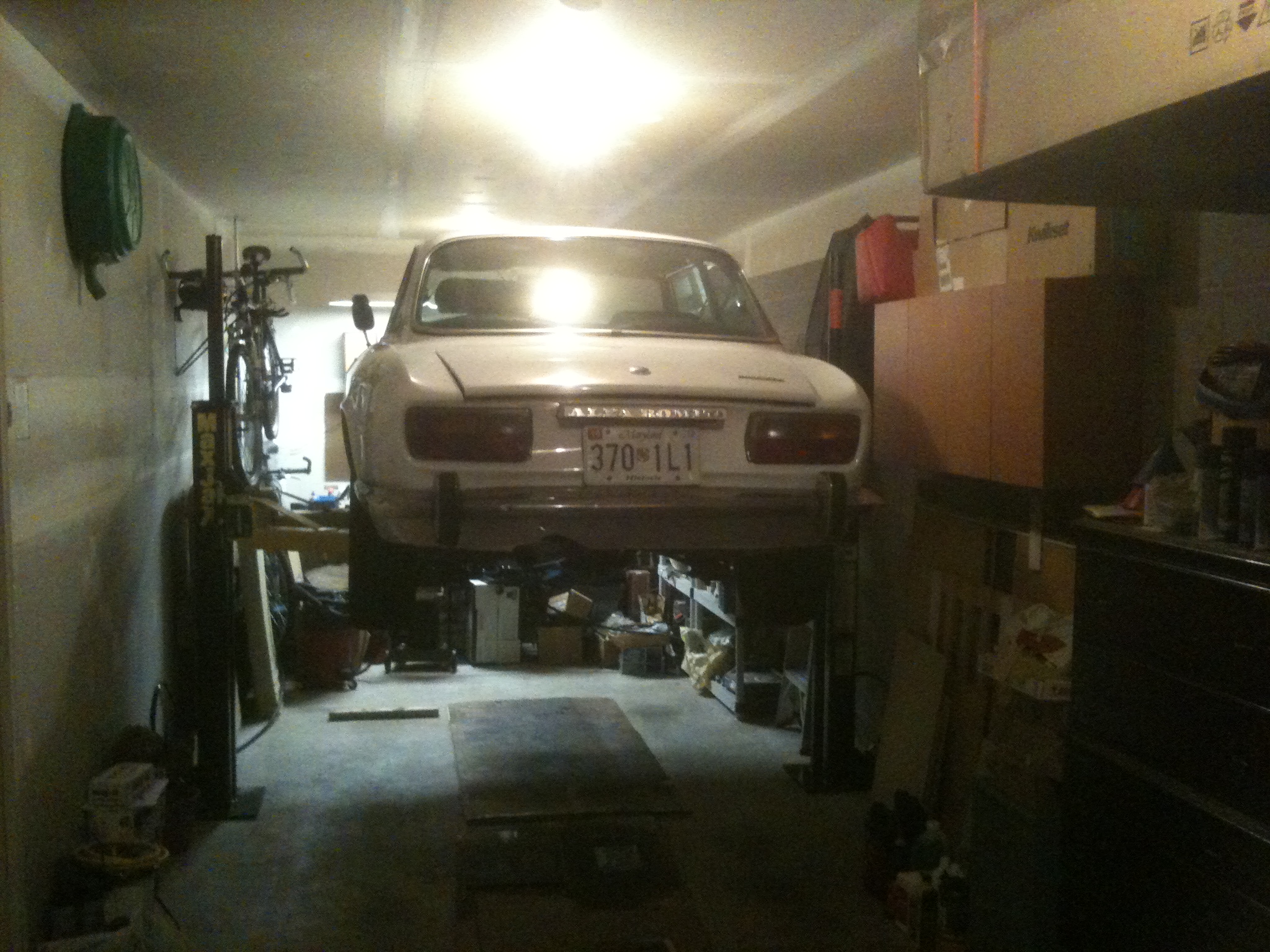

Max Jax is pretty much your only option. That is what I had in my garage in a city rowhouse.

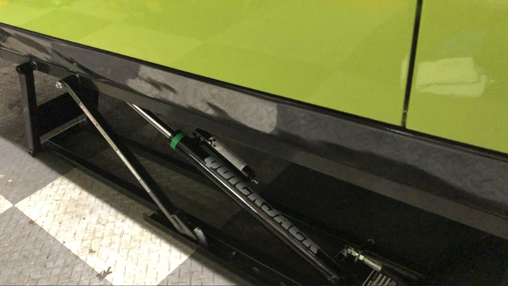

Quick Jack is another great option. The lift sections are trapezoidal so they don’t need to be anchored to the floor and there’s no minimum concrete thickness. It doesn’t lift as high as max Jax, but the 21 inches or so is more than adequate to work on a creeper. In my opinion, there are really only two workable heights anyway....on your back or above your head. If you don’t have the ceiling height for the latter, quick jack is an easy and portable solution. I use it in my small garage and there’s an unboxing, setup, and 914 lift video in my signature...

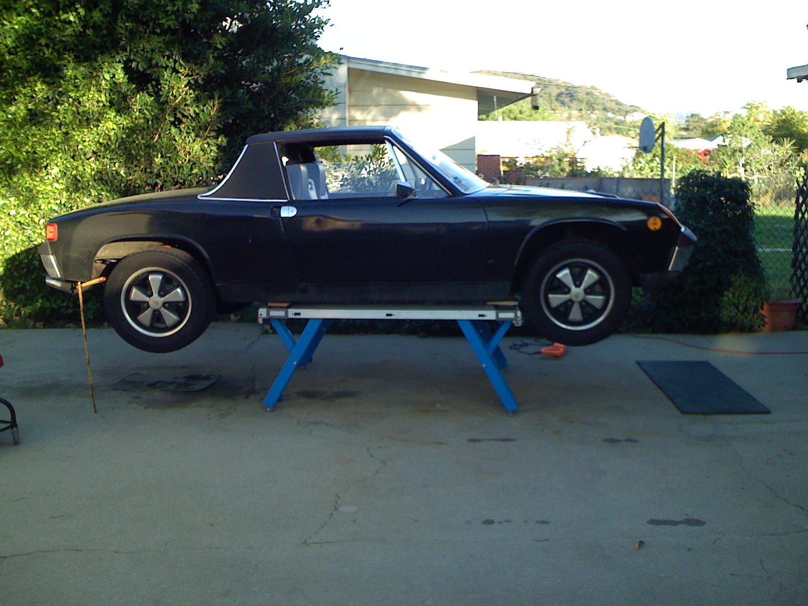

I decided on the EZ Car lift, light weight, very portable, lots of options like the caster kit.

The Maxjax works with the 3” pad extension for 2 cars.My ceiling is 98” tall with plenty of room. I would recommend using the epoxy anchors.
