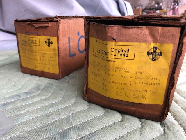

going thru my stash, prepping for the yard sale
have 2 Lobro CV's in old boxes
- believe one is -6, per fella i got it from long ago
914 3320 2903 - is 914-4 all ?
914 3320 2901 - is what? -
any help?
update - lot's of good info in responses below - so I finally unboxed 'em & counted the splines 04-02-2019
the 029 01 is a -6- CV, appears to be new - in a oldish cardboard-brown box with blue Lobro printing
the 029 03 is a -4- CV, also appears to be new - in a yellow Lobro box that has seen a bit of haphazard shelf life -
both wrapped in brown oil-paper in the boxes

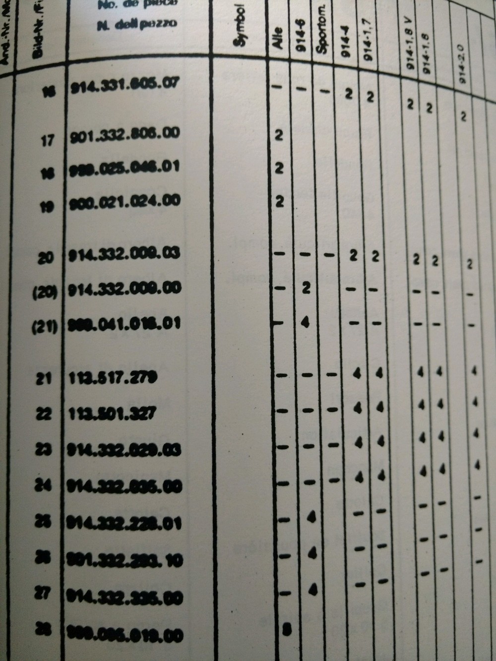

bbrock
post Mar 22 2019, 09:44 AM
Posts: 5,269
Joined: 17-February 17
From: Montana
Member No.: 20,845
QUOTE(dr914@autoatlanta.com @ Mar 22 2019, 09:41 AM) *
even my old old original porsche 914 parts book has only listed the 03 suffix as a 914-4 with no listing for the 914-6 other than a complete axle with cvs attached
George, can you check what P/N they list for the complete axle? I'm betting the 03 version.

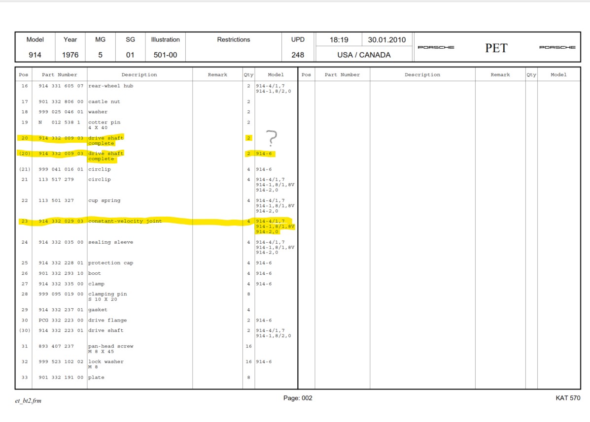

914_7T3
post Mar 22 2019, 03:04 PM
Posts: 1,894
Joined: 3-April 17
From: Los Angeles, CA
Member No.: 20,991
I'm far from an expert on anything, but does the half shaft part number add to the confusion or clarify as it references both the 4 cyl. & 6 cyl. models.
bbrock
post Mar 22 2019, 03:49 PM
Posts: 5,269
From: Montana
Member No.: 20,845
Do you happen to know the spline count on those?
Here's where I think the confusion started which probably goes all the way back to when the first PET was drafted in the late 60s. Notice there are two entries for the complete half shaft, both with the same P/N and one missing a description of models it pertains to. What I think happened was that the 914-4 P/N got accidentally linked to the -6. Then look down at the cv joint entry. Only one P/N listed and only for the -4. -6 is missing. Clearly something is amiss here and it is biting us in the ass now.
