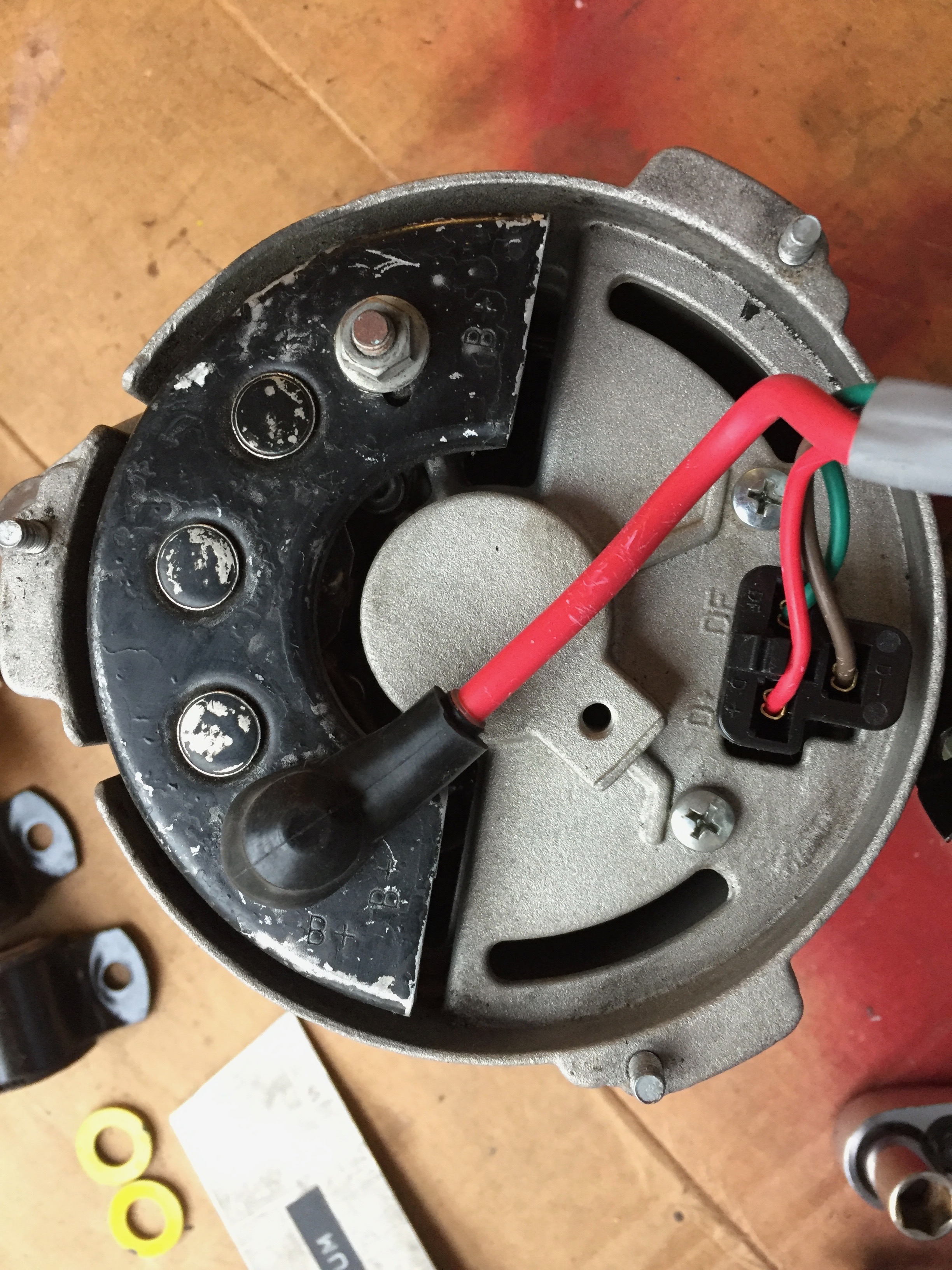

#1 - I have a heavy gauge red wire that is coming off the alternator, that the previous owner spliced into and ran through the longs to the hot terminal by the fuse box.
  • Is this red wire from the alternator stock? I couldn't find it on the wire diagram.

Any idea about the Alternator red wire? I have no idea where it's supposed to connect. Oddly, it looks like it's supposed to be there, the wire goes into the protective sheath and through the rubber grommet on the alternator. Here is another pic of #1 wire looking from underneath.

Usually the heavy wire goes to the starter positive post with the positive battery cable.

New alternator wiring harnesses are avaliable from at least 2 sources and would be a good idea for you to replace yours.
This picture shows connections at the alt. the triple plug is duplicated at the other end and plugs into the back relay board. My origional harness was toast, so expect yours had some issues also. well worth the small $

Barefoot - Ahhhh... This explains a lot. I thought it went to only one terminal.
Do you happen to have a photo of how the wire is routed to the starter? Lots of different sized holes in the engine tin, not sure which is the correct one.

The hole where the PO's wire runs through the dash is "custom." There should be no hole there. My hunch is the PO had (or thought they had), a problem with the two large (12gauge?) wires that run from the pos battery terminal through the main harness that are the main power feeds to the starter switch and fuse box, and bypassed them through the long. I'd check resistance end to end through those wires end to end and go from there.
I agree that you should chuck that alternator harness and get new. I can't remember for sure, but I believe the 3-wire portion is supposed to feed through the hole just aft of where it is coming through in your pic but covered by foil tape. The hole it is coming through now is for the heater J-tube. If you new alt harness doesn't come with grommets, you can get them from 914Rubber.

bbrock - Thank you! That hole by the dash was going to bug me to no end. Glad I now know it was added by PO. Also per your reply I've rerouted the alternator wiring out of the J-tube hole.
