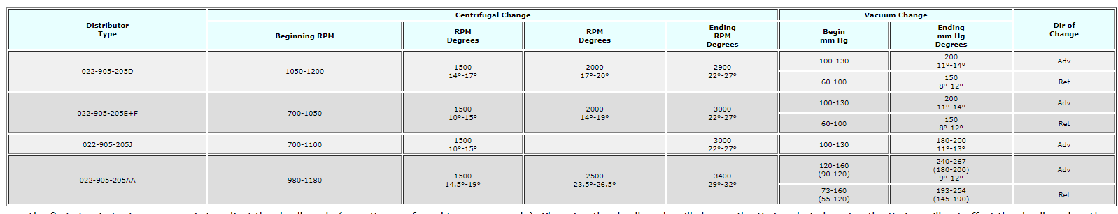

1. In the chart below, is there correlation between cars (year/engine) and distributor numbers? Kinda weird that it was put into the Birdboard instructions on this topic with no references to it.
2. If I set the dwell angle on my timing light to the degrees of each of the RPM's might it be easier to find which way I need to go advance? retard? or do we just 'play with it'

Don't worry about the timing at all the different RPM listed in the chart unless you have so running issue you think are due to poor time at a specific RPM.

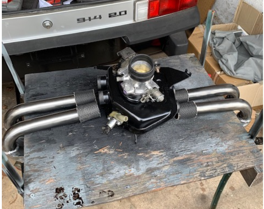

Rebuilt the throttle body, have an extensive post on this, seemed to be firm and no play

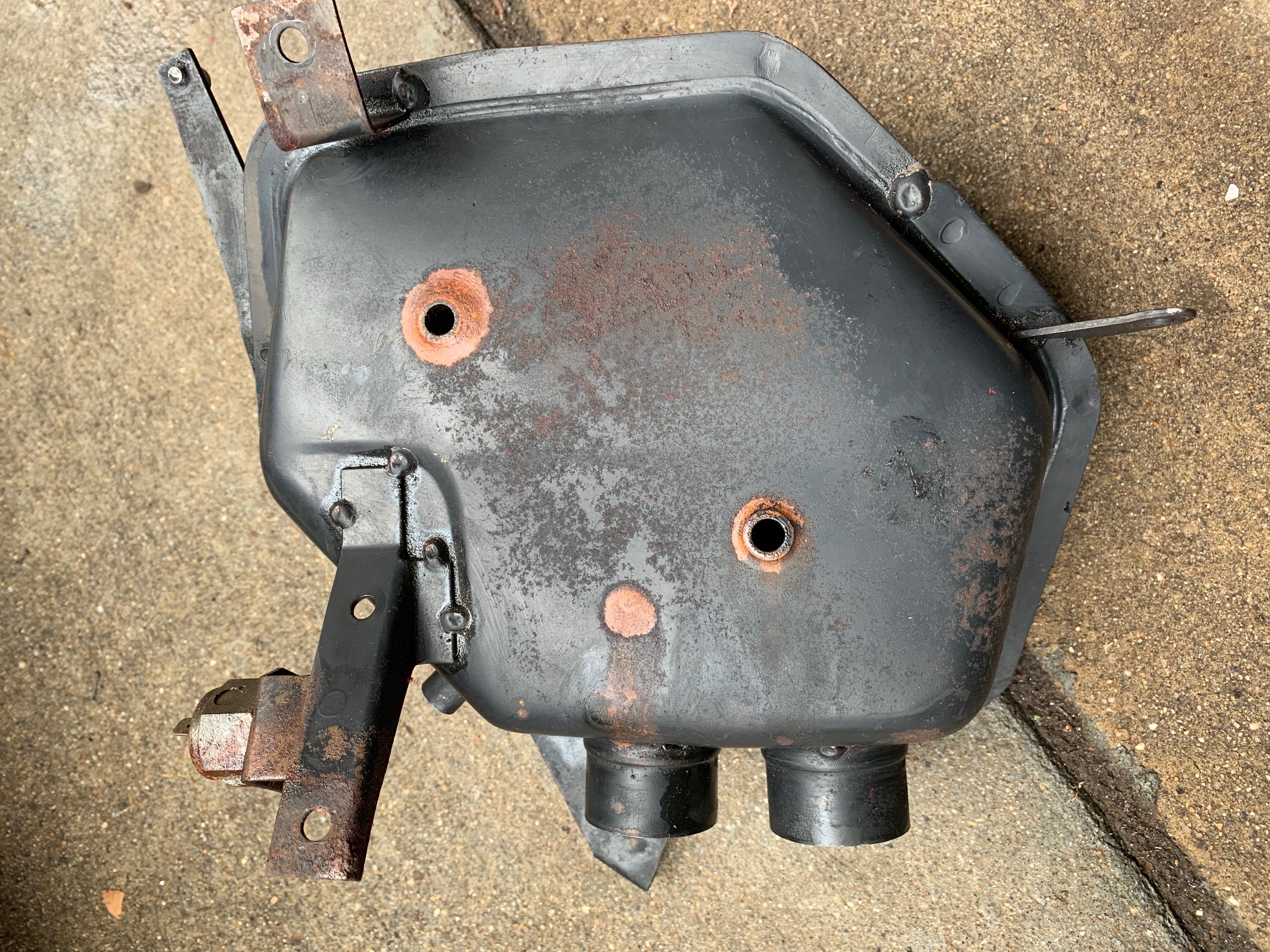

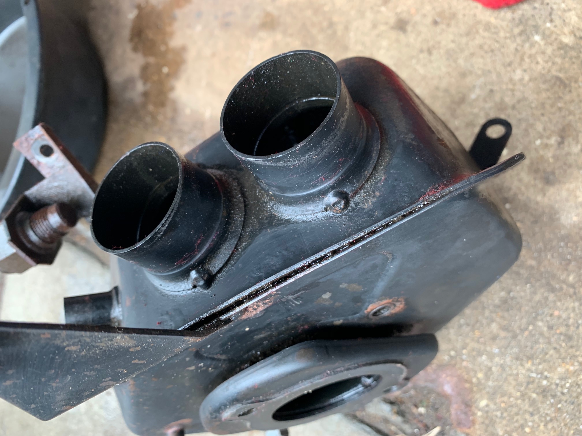

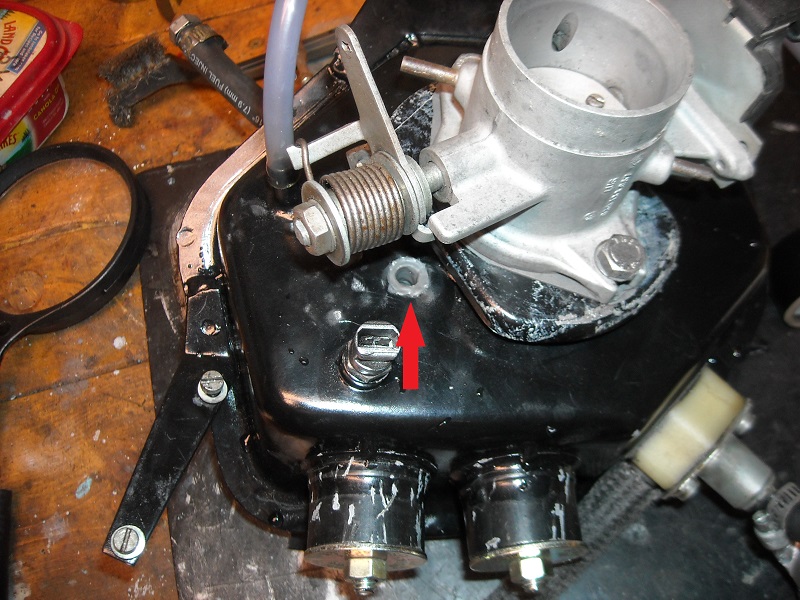

The air box/plenum that the throttle body bolts to is known to rust out in places and can be filled with water or alcohol to check for leaks. (IMG:style_emoticons/default/beerchug.gif)
Next stop will be to replace the intake gaskets and to inspect the bottom of the plenum------THANK YOU FOR THE POINTERS!

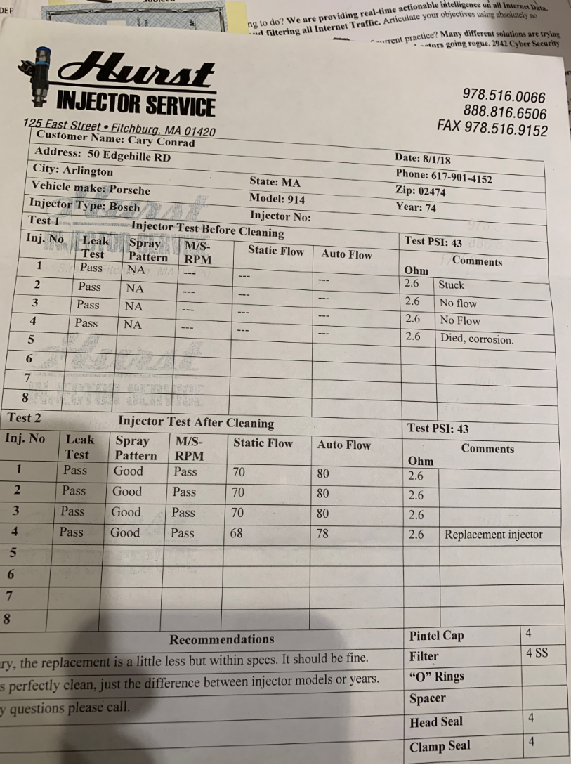

How did the injector expert "set up" your injectors?
See the attached below.
How did he test the injectors?
He uses an ASNU machine, also the dude was a Bosch employee (in Germany) for many years. Good guy, very knowledgeable,

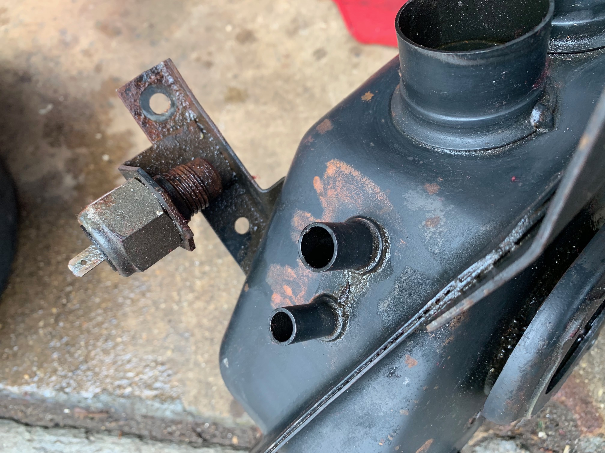

Took off the entire upper assembly to chase the vacuum leaks. My impression of this exercise is:
If the engine has not been running for over 10 years - EVERYTHING in the vacuum chain should be removed and regasketed.
Plenum does not have any holes from rust nor do the seam welds have any leaks - used solvent to chase the tiny leaks - not sure how I was supposed to plug all of those holes to pressure test this, has anyone done that?

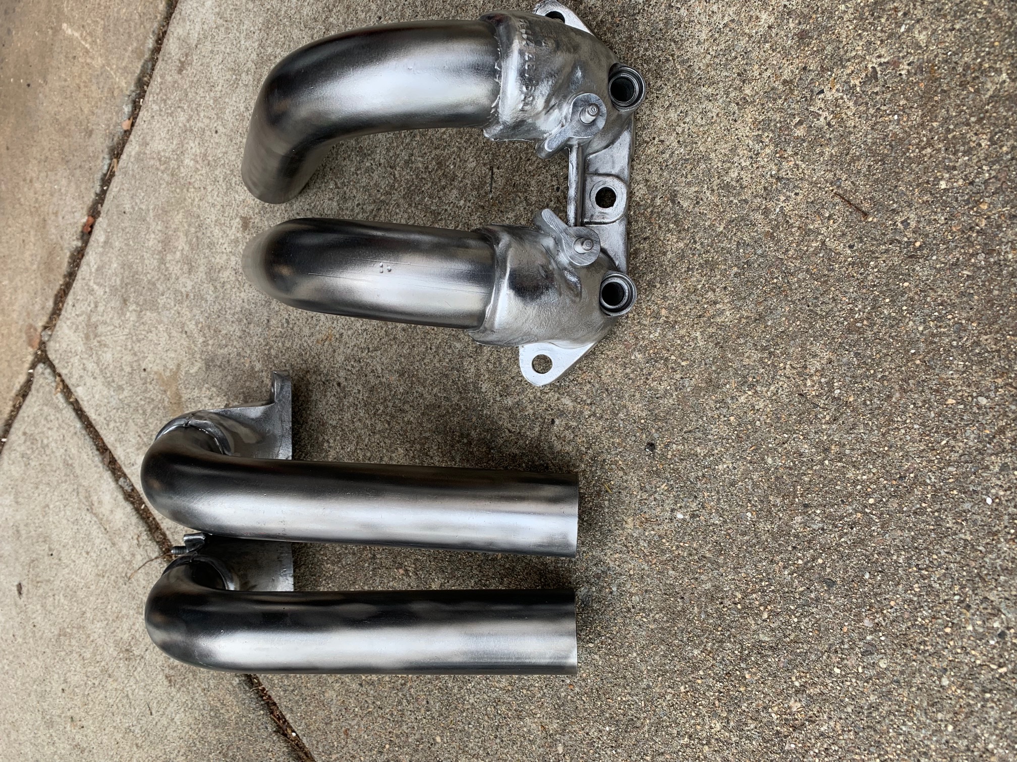

My son went nuts on the pipes - really looks great - we are going to put clear coat on this , paint would be a sin.
I also took the opportunity to send all of my injectors back to Hurst Injectors, Paul wants to take another look at them, as well as recondition the ones that I recently purchased. At the end of this job I will have spares of EVERYTHING!
Yes chased a vacuum leak for a bit. it ended up being the tubular supports that run through the plenum. Used pipe plugs for the intake connectors and cut a piece of gasket material without a hole and bolted on the throttle body to seal that area. used hoses with bolts to seal the others.

WOW - very impressive, I could not see any seeping from those weld points - will let this thread know the outcome after I remount all of the hardware.

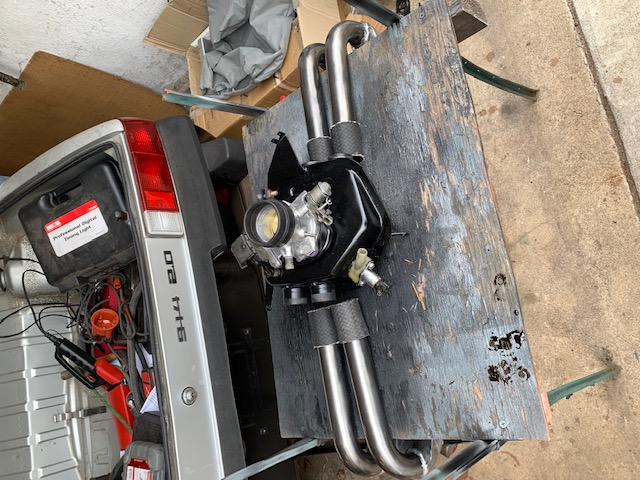

Here is what we did this weekend while chasing down the vacuum leak. Most of this was done by my 17yr old who is constantly seeking perfection.
