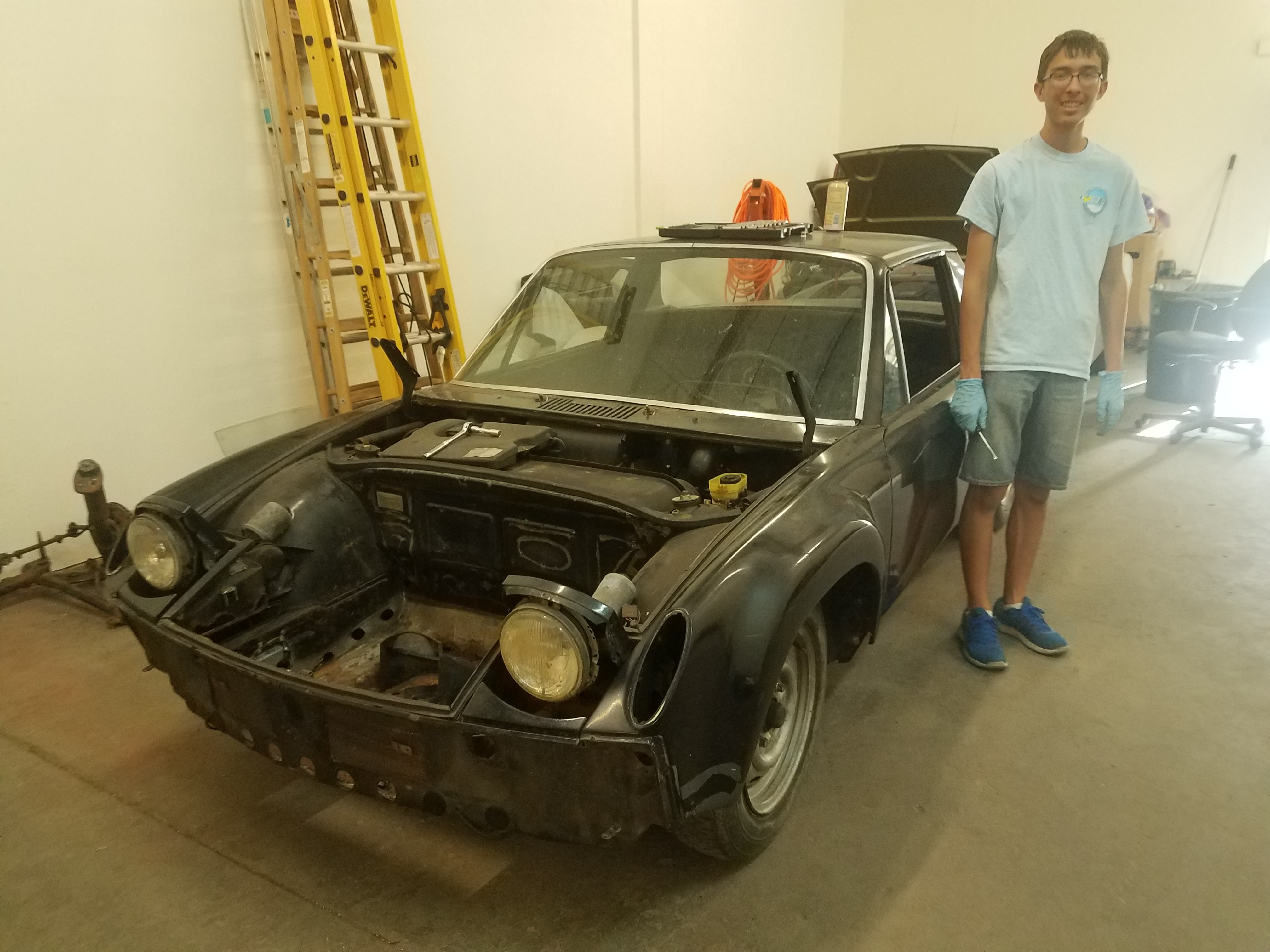

My 16 year old son, "The Stripper"
Car stripper.

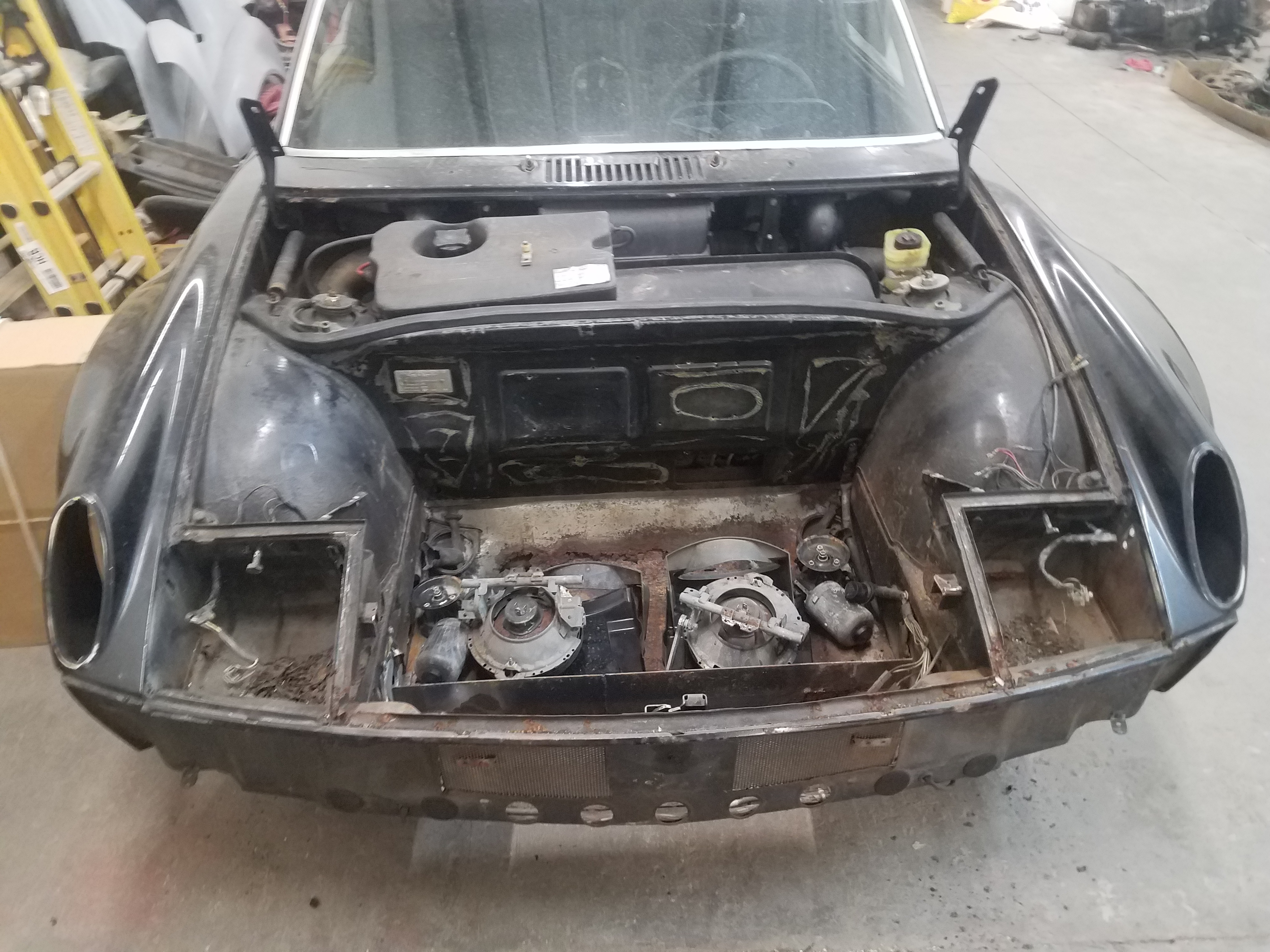

We started stripping the parts we need off the parts car.
Started with the front trunk lid and moved on to the headlights.
AZBanks

This is where we stopped for the night.

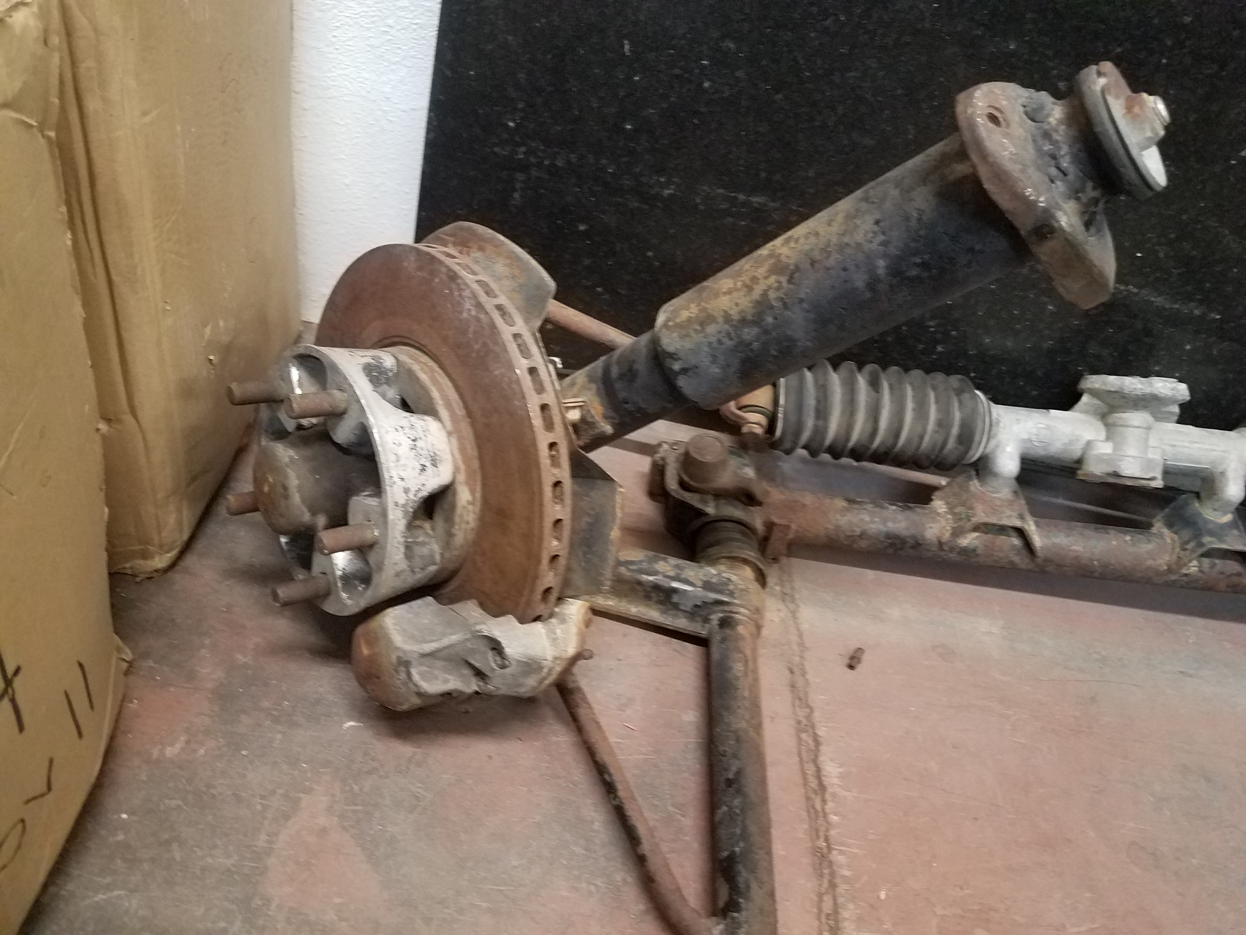

I forgot to take pictures of the 911 suspension we got from Ric.
I need to find out what kind of brakes we got so we can send them back up to SLC so PMB can do a rebuild.
Nathan and I will be picking up the pace so he can drive it to school this fall.
I was hoping to have it 100% complete this year but now we are looking at getting it 100% mechanical/drivable this summer and we will worry about finishing bodywork and paint next summer.

Great to see you getting your son out there to help!
Looks like he is enjoying himself.

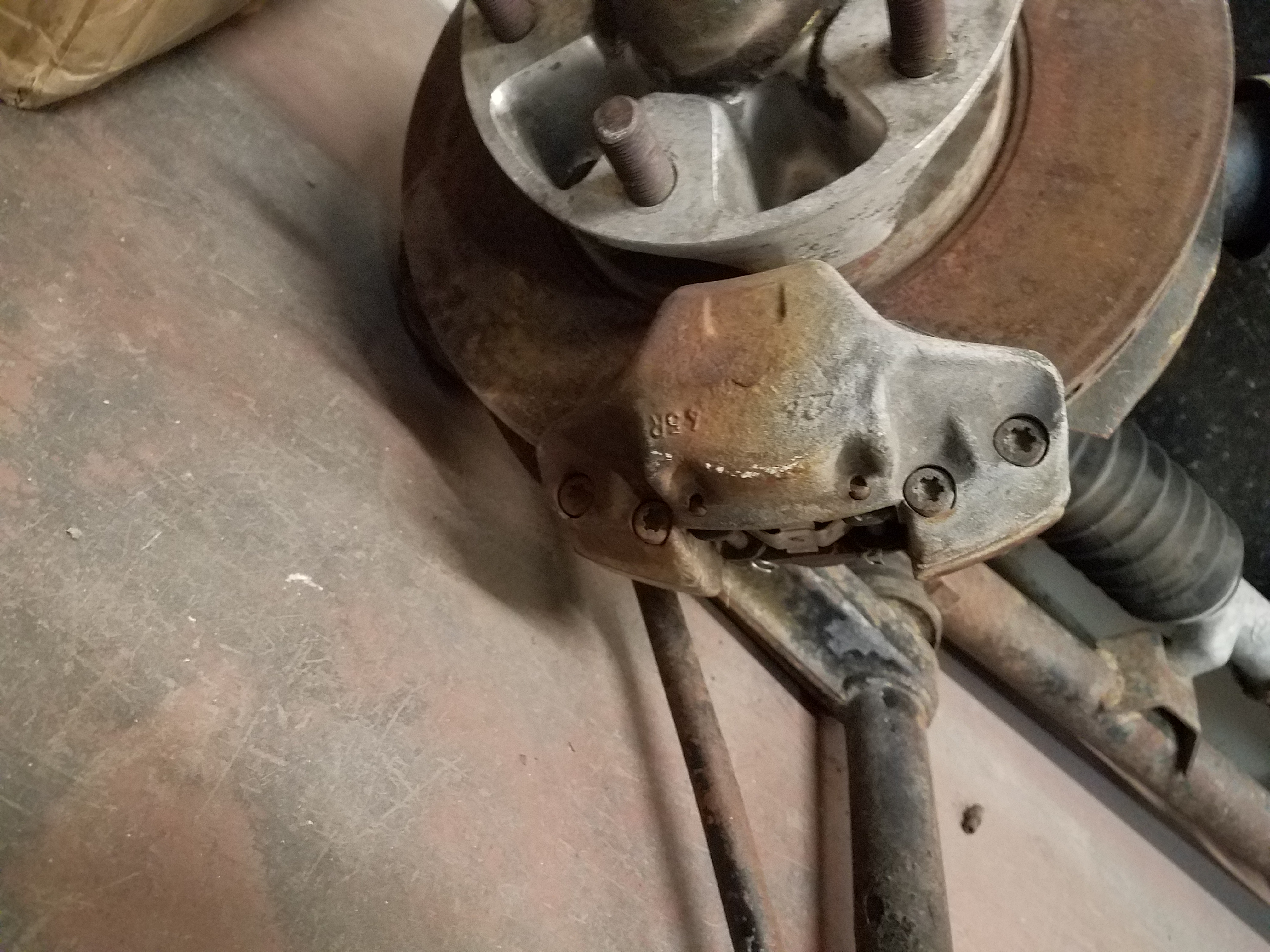

Does anyone know which version of 911 M-caliper brakes are these? The 69 model year or the non-69 model year?
AZBanks
post Jul 4 2018, 12:56 AM
Post #48
Posts: 1,079
Joined: 7-December 05
From: New River, AZ
Member No.: 5,245
another brake pic

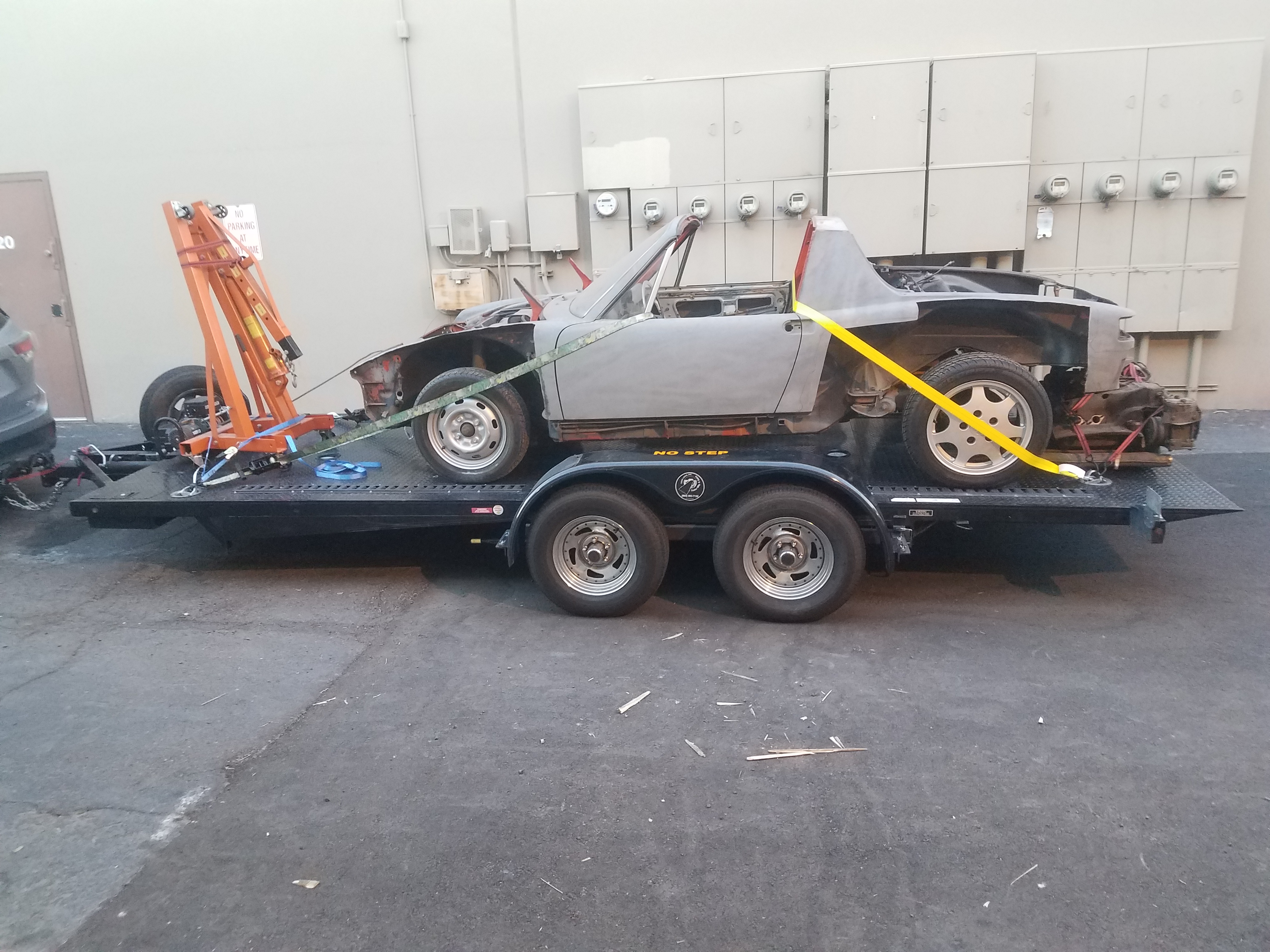

I replaced the single gate to the back yard with a double gate and closed down the shop in central Phoenix. Spent the last two weekend building a shed and moving the car/tools/parts/etc home. The car is now right next to the house where we can work on it much faster and easier.

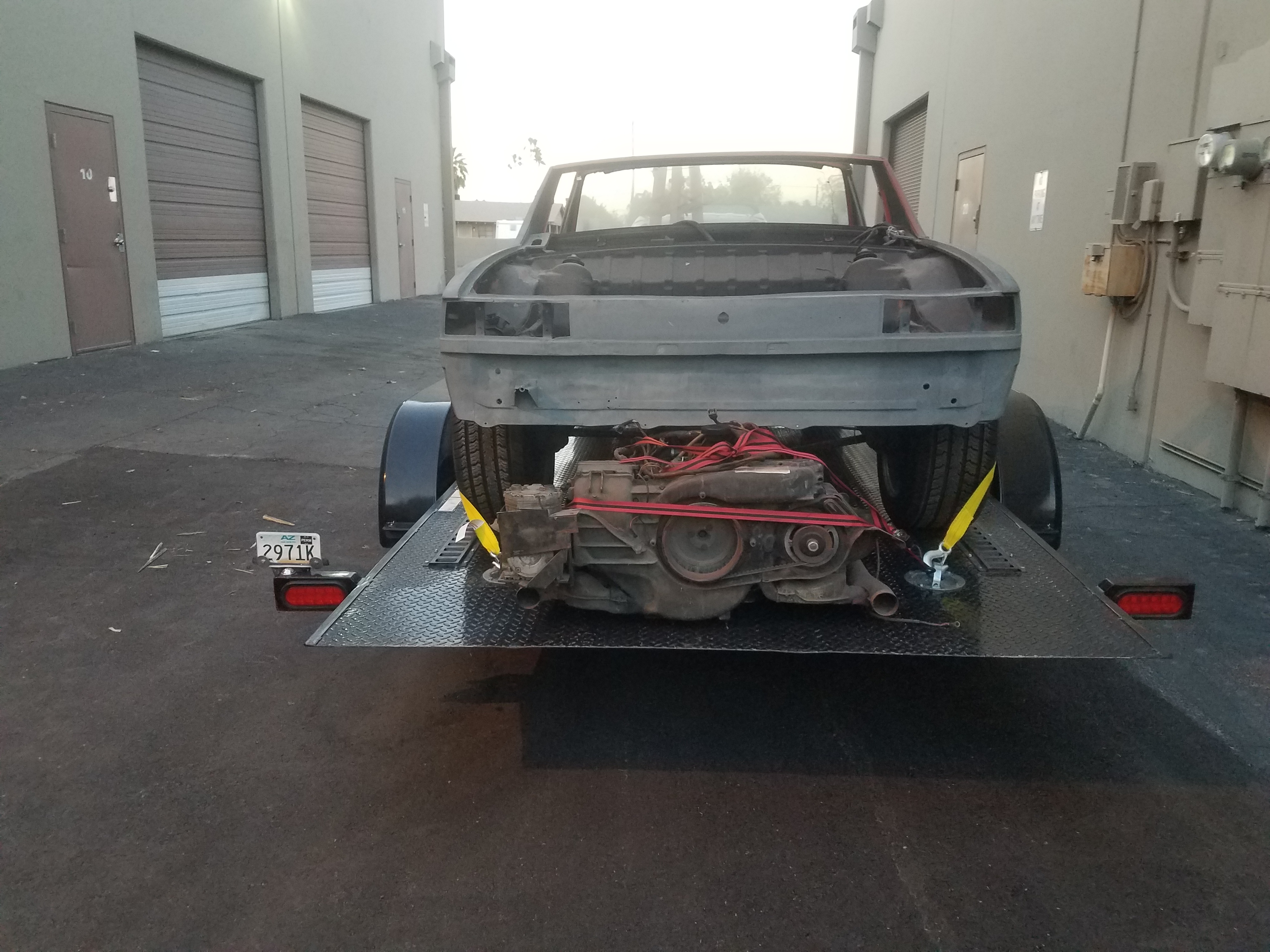

Engine in the back, must be a 911.
