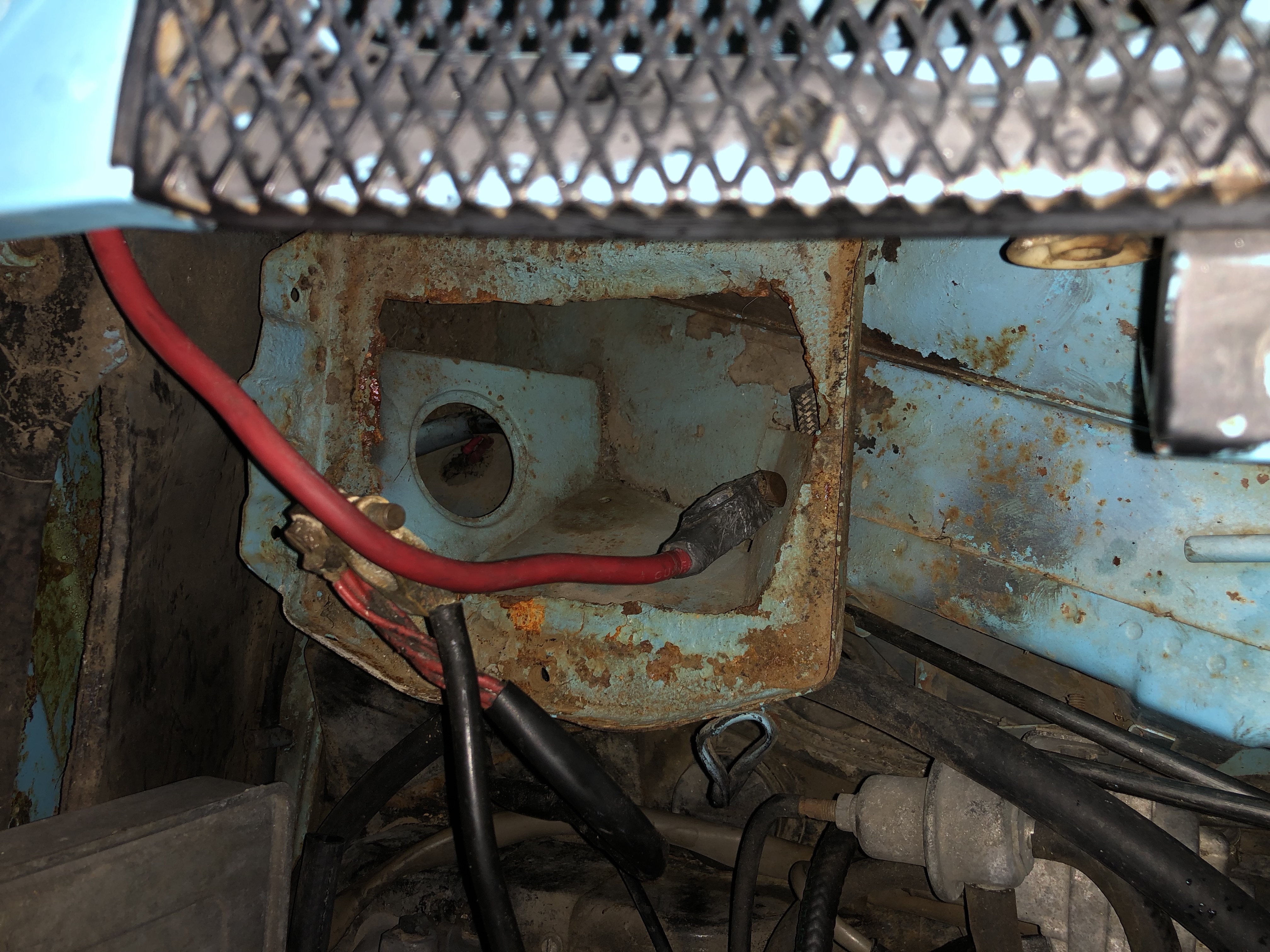

I'm new to the 914 world and am looking at a '73. The car is from Colorado and was dry stored for 23 years. Car is relatively rust free with the exception of a small area by the drivers door sill. I've attached pics of the battery area. Would do you think?

DickSteinkamp   Looks like someone torched out the floor of the ba...   Aug 18 2019, 10:04 AM
rjames   The battery tray can easily be replaced. What does...   Aug 18 2019, 10:06 AM

bbrock   A couple thoughts from the jamb/sill pic. That is...   Aug 18 2019, 10:20 AM

JawjaPorsche   There is a lot of rust you can’t see. I would c...   Aug 18 2019, 10:43 AM
Larmo63   :agree: Walk away unless you have lots of patien...   Aug 18 2019, 11:37 AM

Superhawk996   :agree: Run Forrest, Run . . . .   Aug 18 2019, 11:56 AM

rjames   Owner has had it less than a year and is now tryin...   Aug 18 2019, 12:06 PM
DickSteinkamp   I've seen worse. After a careful inspection...   Aug 18 2019, 01:30 PM

bbrock   I agree with pretty much everything already said. ...   Aug 18 2019, 02:44 PM

PanelBilly   And don’t be afraid to ask for someone to do an ...   Aug 19 2019, 09:25 AM
rjames   Keep in mind that these cars are old and require...   Aug 19 2019, 10:54 AM
dr914@autoatlanta.com   an easy repair. The new tray can be spot welded to...   Aug 19 2019, 11:25 AM
Rand   I'm really surprised to hear this from an exp...   Aug 20 2019, 07:21 PM
mepstein   When the sill looks like this, it’s usually the ...   Aug 20 2019, 08:28 PM
Rand   Shh, George could sell you a new sill plate. It wi...   Aug 20 2019, 08:40 PM
rhodyguy   $20k in fixes, new parts and upgrades will NO...   Aug 21 2019, 09:28 AM
sixnotfour   youall this is the kill shot....... battery tray i...   Aug 21 2019, 12:37 PM
