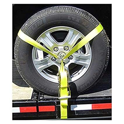

Like this?

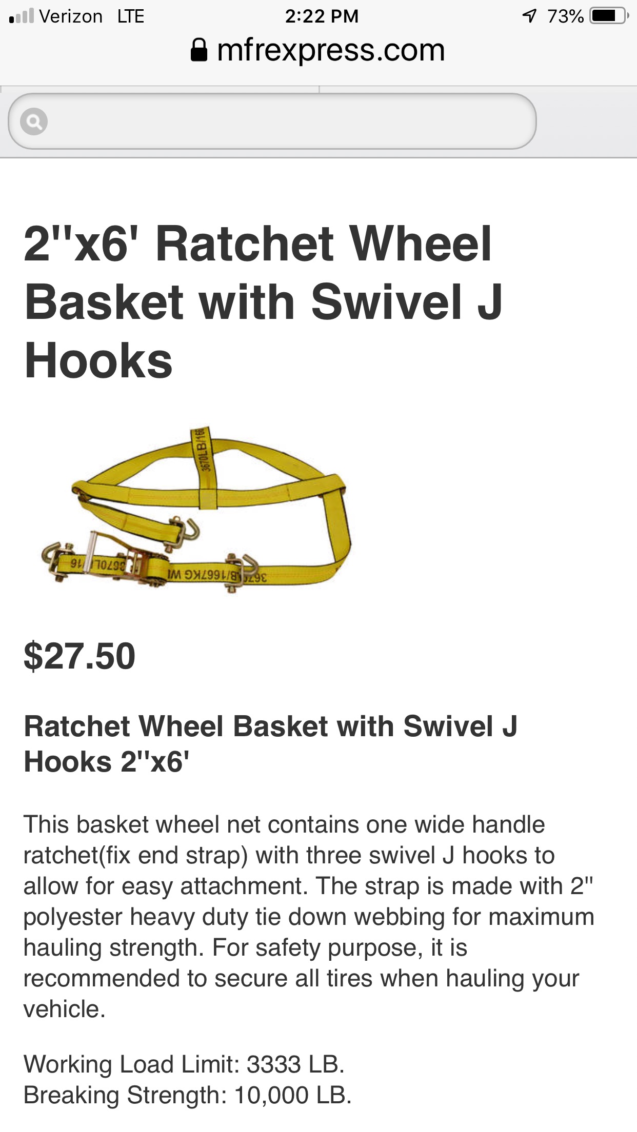

sixnotfour
post Sep 20 2019, 02:22 PM
Posts: 11,184
Joined: 12-September 04
Member No.: 2,744
basket style side pull,,,never tried them ...

Thanks guys- Mark posted what I was thinking of. The problem is I don't want to have a strap running through the actual rim because I am afraid it would mess up the finish. I had not thought about using the regular straps and just going through the lower A arm and the training arms to secure it. You don't think that would hurt anything? I know nothing will bend. I was more concerned about the finish on the A arms and the trailing arms. Yeah....but seriously, I am driving this car. I almost thought about driving it home from LA but Highway 5 is brutal. Tons and tons of big rigs throwing stuff everywhere.
Hopefully this is the one and only time it will be towed once it is running. (IMG:style_emoticons/default/beerchug.gif)

The basket side pull kind sixnotfour posted scare me. The load paths are really wonky and because of that the 1670# working limit seems pretty slim if you have an emergency stop-think I'd stay away from those.

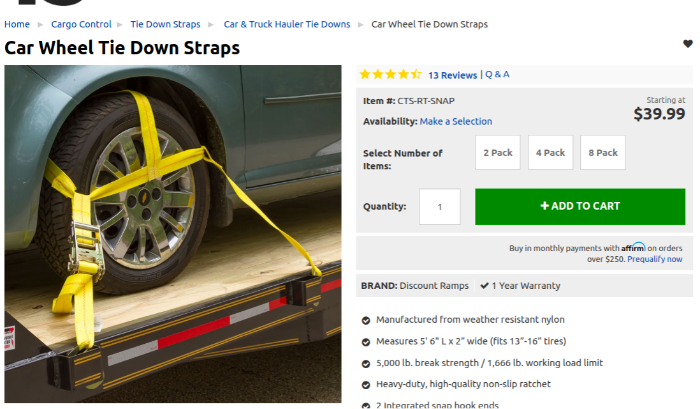

http://www.macscustomtiedowns.com/category/WheelNets
Best I've used

I have 3 sets of tie downs from this company. They have everything, you will need. You will have to look and see what works with the trailer. I have done the through the wheel, but only once. Over the wheel worked better for me.
https://www.truckntow.com/auto-hauler-suppl...ler-straps.html

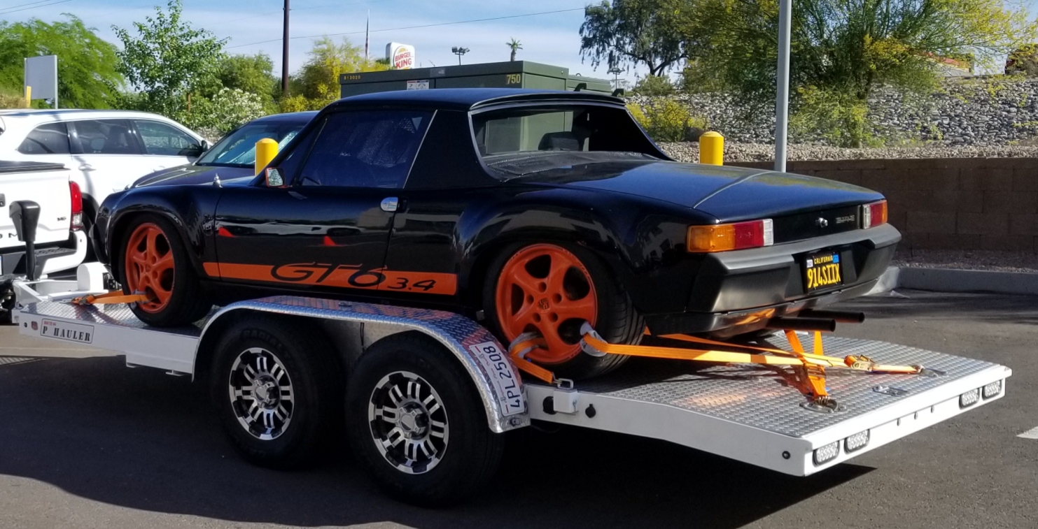

Please be careful, I have first hand witnessed this issue, but strapping down the tires only leave the suspension of the vehicle unloaded and free to move around - imagine the car bobbing all over while hitting every bump and curve. We had a case (stacker with 2 early vintage Porsche race cars strapped down the same way) where the cars moved enough to throw off the weight of the trailer and pushing the rear end of the tow vehicle almost causing a major wreck. Thankfully had a cool headed and experienced rig driver to regain control and get the vehicle stopped. This team always straps all cars from the suspension points now.
You’ve got a big tow rig, light car and heavy trailer that’s not so top heavy, so not as much of an issue, but please be aware and careful towing that beautiful car.

With those basket straps, you still have to be careful. As said before the entire car will still be going up and down as the suspension moves when the trailer goes over big bumps and things. I recently had my car towed by a professional flat bed guy who used the over the tire basket straps. I destroyed one side of my front valance as the car came down hard on one of those straps. So make sure you have loads of clearance when using those basket straps with any and all of your bodywork. Those straps don't move much when they are cranked up tight, and if your valance or fender comes down on one of those....the strap will win.
