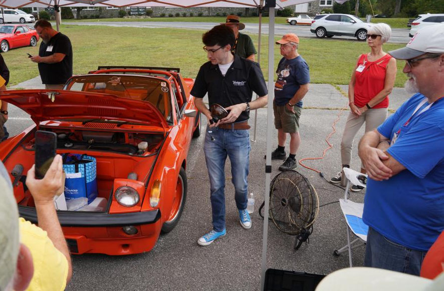

Please give Vintage Car LEDs a look... these guys actually support the 914 community.
Shown here installing a set of LEDs on a 914 at Okteenerfest.
EDIT: looks like mtc911 had the same idea while I was searching for a photo :-)

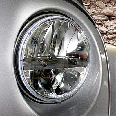

Another possibility are the Trucklites LEDs 27270C 7"
Advertised for Jeeps but bolt right into our cars (at least on mine it did )
on low beams only the top half lights up when you click to high beam the bottoms come on also.
I found them very bright.

QUOTE(Olympic 914 @ Nov 27 2019, 01:54 PM) *
Sorry I don't have any pictures of them installed right now..
I think the GE Nighthawk LED headlights are the same as the Trucklites.
