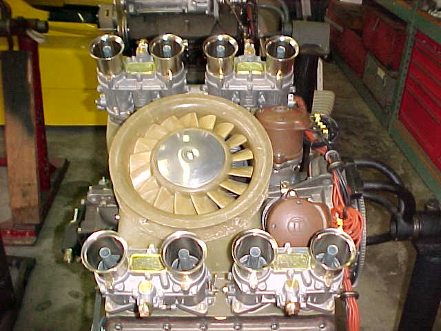

908 replica engine group buy anyone?

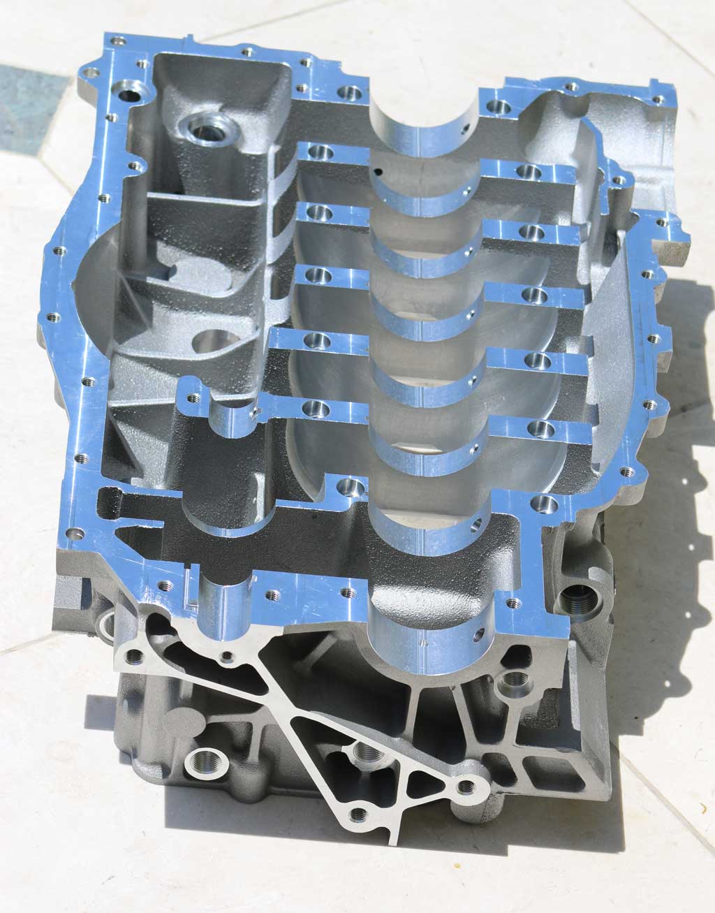

Ask Catorse how much he has into the tooling for new 3.6 cases. I think it's north of quarter mil. (IMG:style_emoticons/default/blink.gif)
Also ask him how "easy" it was to do.
https://www.taorminaracingdesigns.com/produ...-6-engine-case/
(IMG:http://www.914world.com/bbs2/uploads_offsite/rennlist.com-419-1502636405.1.jpg)
(IMG:http://www.914world.com/bbs2/uploads_offsite/www.taorminaracingdesigns.com-26-1579442177.1.jpg)
