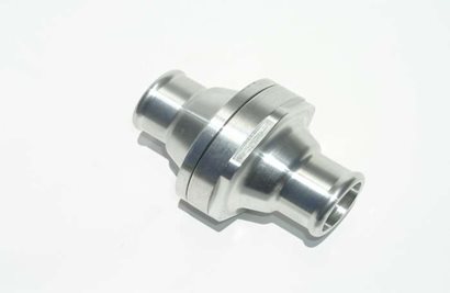

Needs to go on the high pressure hose going to the radiator .
here is what I used

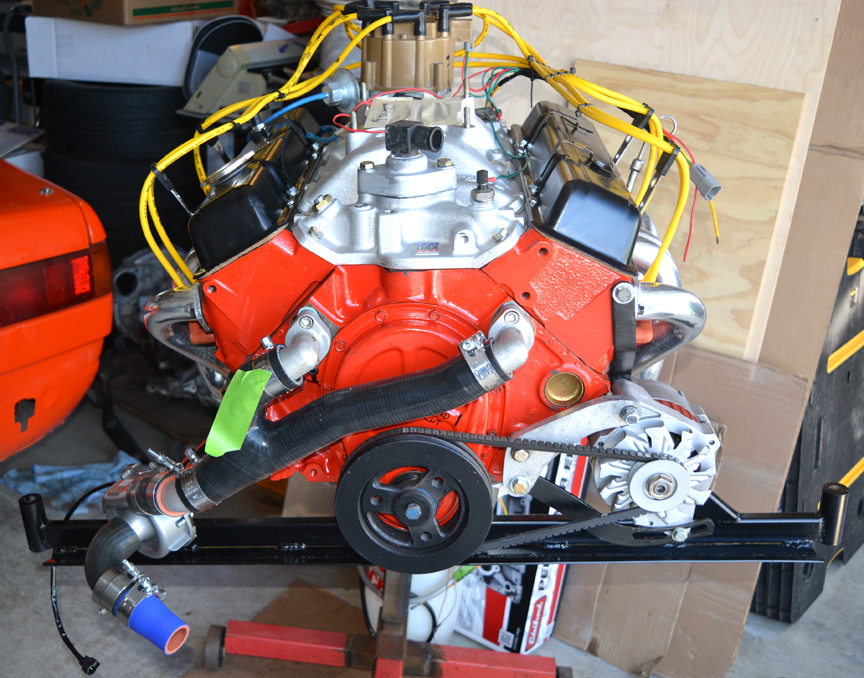

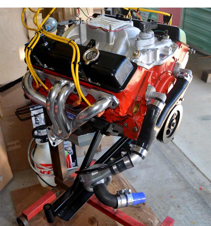

This is what I did for a friends car, it is a 1st gen 350 so I do not know much about the LS swaps.
I have called Renegade a couple of times for advice, they do not give any out. You have to call have your kit invoice # - proof you have one of their kits before they will help you-me.
The water pump is a Davis Craig unit out of Australia - got it and their header - manifold system from Summit. The water pump comes with an electronic control box that lets you pick:
temp pump starts running
Temp fan starts and stops
How long pimp and fan runs after engine is shut off.
So far we have only got the engine to fire up - still have a lot to do to be able to drive it.

BigKat... that is the housing I have... now, which is the high pressure hose & where in that hose should it be put?
Seems like it should be as near the engine as possible.

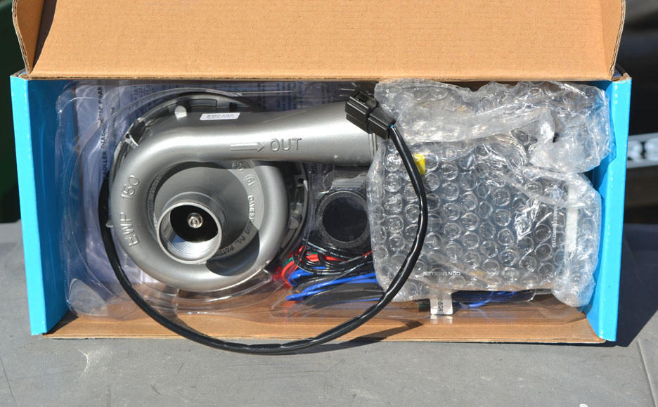

The electric pump is a Meziere with a 1.25" center port & 2x 1" ports above & below that. Does the pump take coolant in thru the large center port, or push it out.
Knowing that I would know where to locate the t-stat.
Thanks... Terry

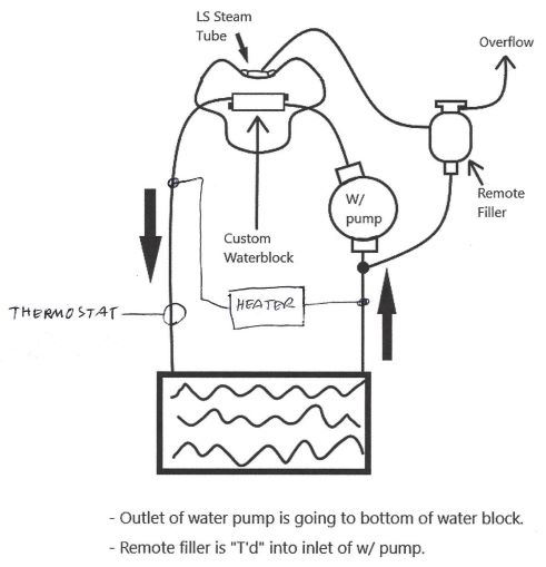

DickSteinkamp
post Feb 18 2020, 10:17 AM
Posts: 500
Joined: 27-February 17
From: Bellingham, WA
Member No.: 20,876

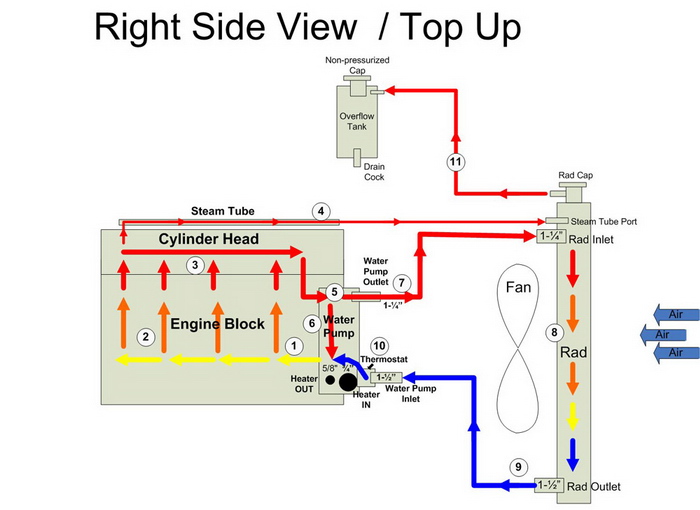

I think Daryl has a traditional small block.
It looks like an LS does things the opposite of the traditional Small Block and restricts the water coming into the water pump from the rad...not the other way around...
LS cooling system
"The thermostat is located in an area between the engine and the radiator. The classic small-block Chevy V8 located the thermostat on the "outlet" side of the motor, in the intake manifold. When cold, the thermostat was closed, and this prevented flow of coolant to the radiator. When the engine warmed up, the thermostat opened and coolant was allowed to flow to the radiator and back to the engine. The newer third- and fourth-gen GM V8's locate the thermostat on the "inlet" side of the motor - specifically in the inlet housing of the water pump. With this design, when cold, coolant is pumped through the rad, but is prevented from returning to the engine until the temperature of the thermostat has been reached, at which point the thermostat opens and the cooled coolant returns to the engine."
LS Thermostat
dwillouby
post Feb 18 2020, 10:42 AM
Posts: 395
Joined: 27-December 02
From: Mt Washington, KY
Member No.: 29
Hello
This is how Renegade said to plumb my LS2.
I have the inline thermostat up near the radiator on the hot side.
DavidAttached Image
Daryl32
post Feb 18 2020, 07:58 PM
Posts: 133
Joined: 14-January 20
From: Southern California
Member No.: 23,827
Ok Terry - Dick is correct. I did not know how a LS pump went on and worked.
Sorry - I need to look at this more for my own knowledge.
Daryl32
post Feb 18 2020, 08:02 PM
Posts: 133
Member No.: 23,827
QUOTE(dwillouby @ Feb 18 2020, 08:42 AM) *
Hello
DavidAttached Image
This looks correct - basically the same as with a older v8 - stopping/controlling the water going into the radiator from the engine. So that it can warm up to correct operating temp.

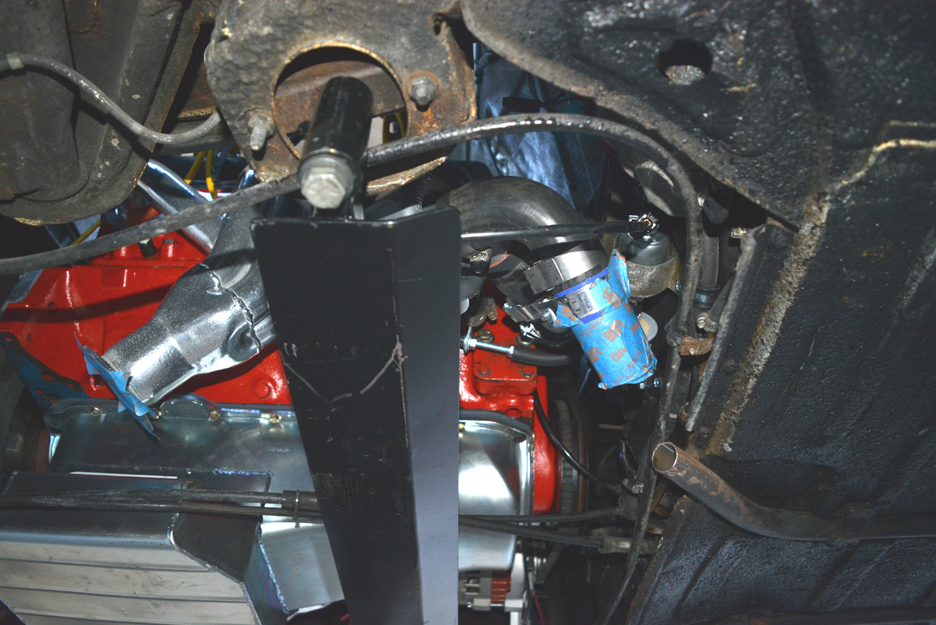

I've tried 2 locations so far: 1) just ahead of the upper radiator connection... fail, engine overheated before hot water got far enough to open the t-stat. Made me wonder if a bypass type t-stat might work better... eliminate the pressure stoppage behind t-stat. 2). below the Renegade collector box where the hose to the inlet side of rad starts... same result. Again, a bypass t-stat might work. I can make one & try it if it comes back to that.
However it appears the LS system places the t-stat in the return line from rad, just before pump.... any comments ?
I'm still undecided what to do next, but would like to make it my last & a successful attempt !
(914-4 me... great link (video) about the steam lines on the LS engines. Mine has 2 at the front corners of the engine that vent into the pressure canister (fill tank)
that has a pressure cap & may act as a pressure tank as mentioned in Dicks link.
