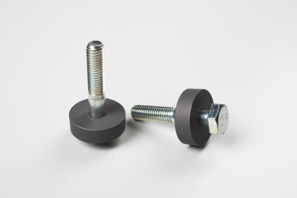

Bump steer kits usually consists of two thick spacers that go under the steering rack and longer bolts.

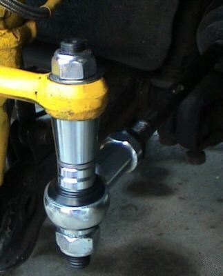

The $300-400 kits are for when you raise the control arm on the strut.

You can do it, by chance you own a metal lathe?
Lots of details in that kit, and I do not like them as a single sheer point. Properly done with another arm welded at the bottom of the strut, to make it a double sheer situation. Oh the leverage going on with that setup.
Making the proper bump-steer kit like shown by Mark is easier. I never did it, but thought about it long and hard, is to measure it, setup tests with washers, get the right height with Zero bump steer, and then machine a spacers the proper height.
One item of note, I have removed the center rubber steering spacer to get the geometry back in proper place. My last setup, I did that and removed the shaft under the dash, and sectioned it, then welded the tube, ground it down, and added a sleeve. That allowed the U-joints nit to bind under the dash. With out this I got an effort sine Waze going as I turned the car.
Last version I was going with the kit much like you see there, but in double sheer. I left the rubber isolator out of the steering.

The bigest hurtle is a metric thread ball joint and a couple of machined spacers. You might be able to retap or timesert a SAE balljoint.
I have a 996 here with a kit, it has actual turnbuckles, unfortunately 914 has a much smaller OD and shorter rod.
There is a wacky looking kit from elephant, but it's not cheap.
How low do you want to go? You can get pretty low without issues with spacers, from there most cut and weld the struts to raise the spindles.

Please don't use those. It's the worst way possible to go about correcting the steering geometry.

Those spacers i was talking about (the ones posted by 914Sixer above) don't go on the tie-rods, they are used to drop the whole steering rack itself.

I believe those spacers raise the steering rack.

Not sure unless you do not fix all the issues it causes.
Things bind on the steering U-joints if you do not move them around a bit. Or if radical, need to change things like cut and welding the shaft. If you can get it perfect then moving the rack up a bit solves the issue.
Much easier solution to change tie rod ends.
I am not going to get into the physics off moving the rod location and what that does to the loads applied. I will stick with the extra arm at the bottom and not worry about flex induced into the steering system or the loads it produces.
The elephant kit has that lovely extra surround that is there for some reason, my guess is that they found they needed it. Why goto that extra engineering if you don't need to.
Heres the kit I use, and like. They also make a basic kit, for a bit less adjustment that is a single sheer setup.
