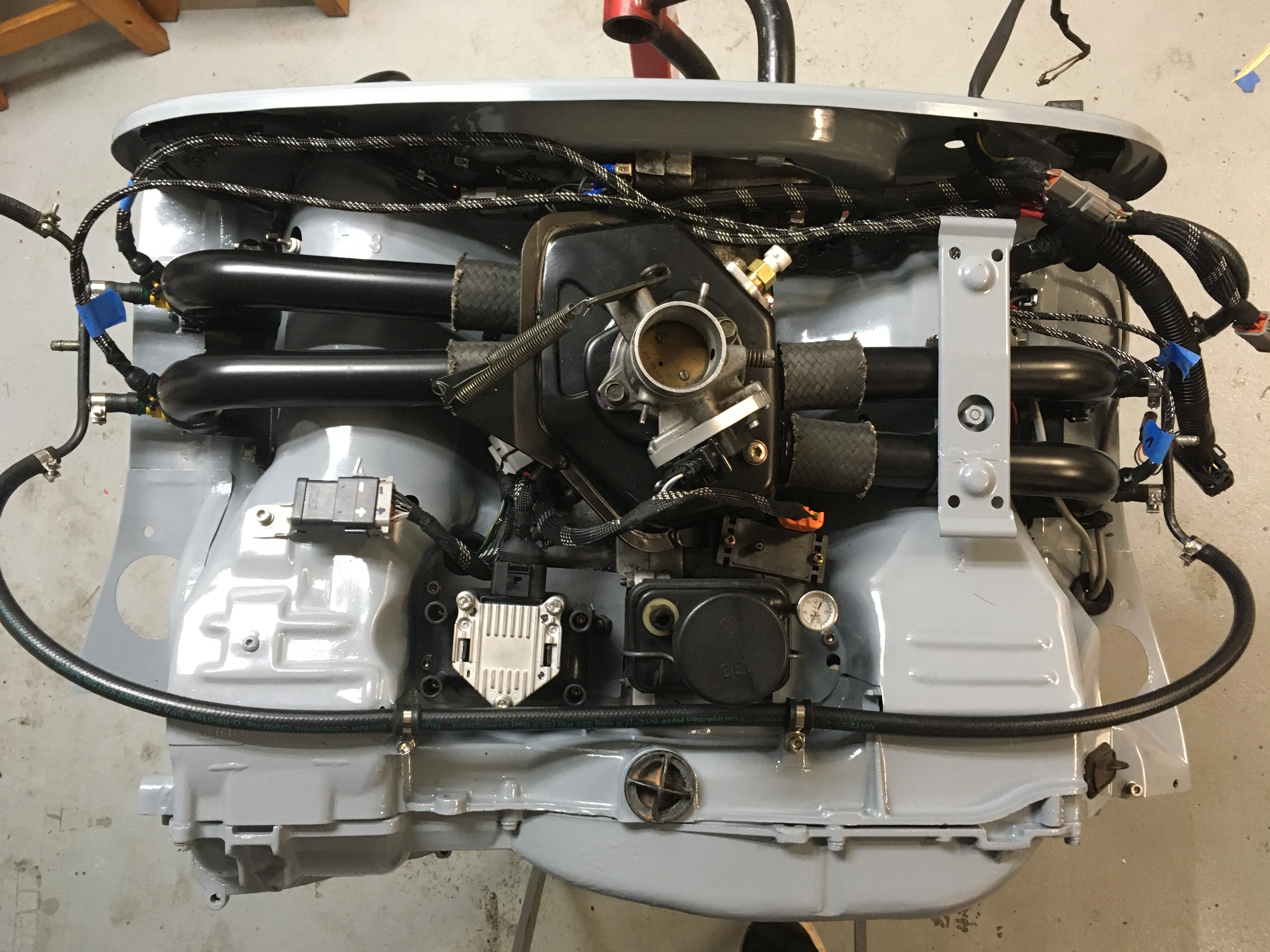

Thats a real clean install you have going so far, I dig it! I like your coil location choice. Working on something similar for my next refresh but using a newer VW 4 coil pack. Great minds....

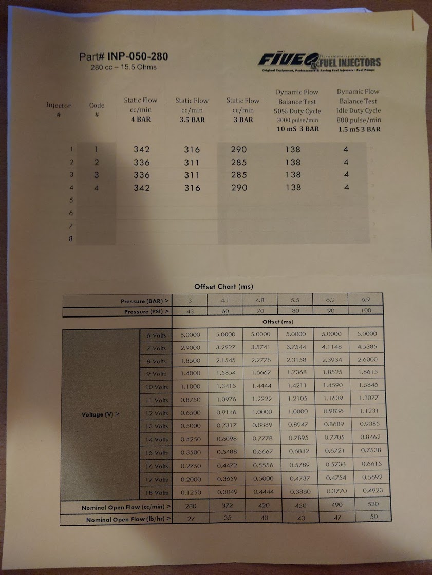

Just remembered I still have the paperwork for mine...
No minimum pressure listed, but looks like they should be good for way over 43.
Highly suspecting that they have the same pressure range based on this.
Original recommendation stands... I would find a way to get the rest of your fuel system up to run them at 43psi (realizing that was your original intention here).
