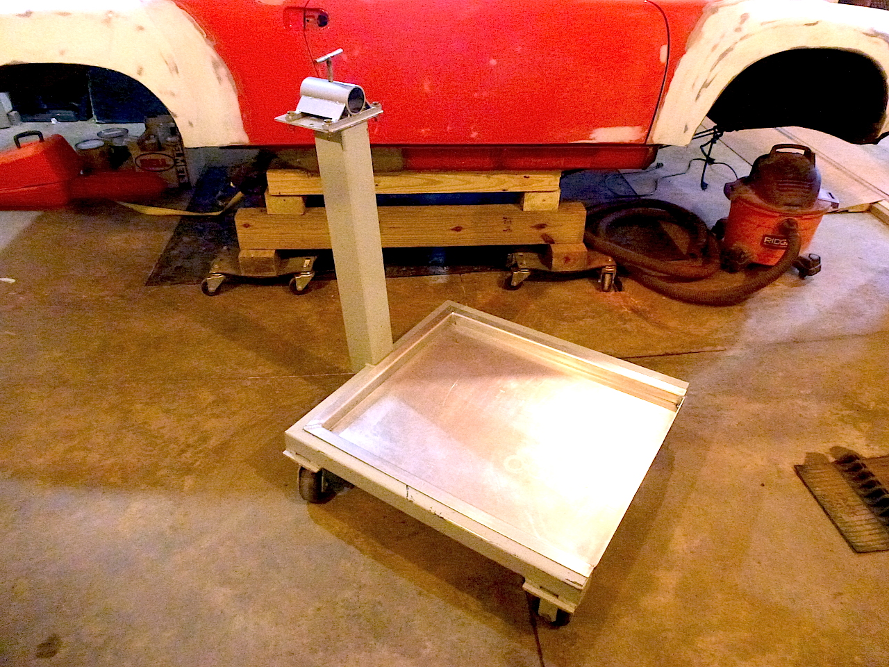

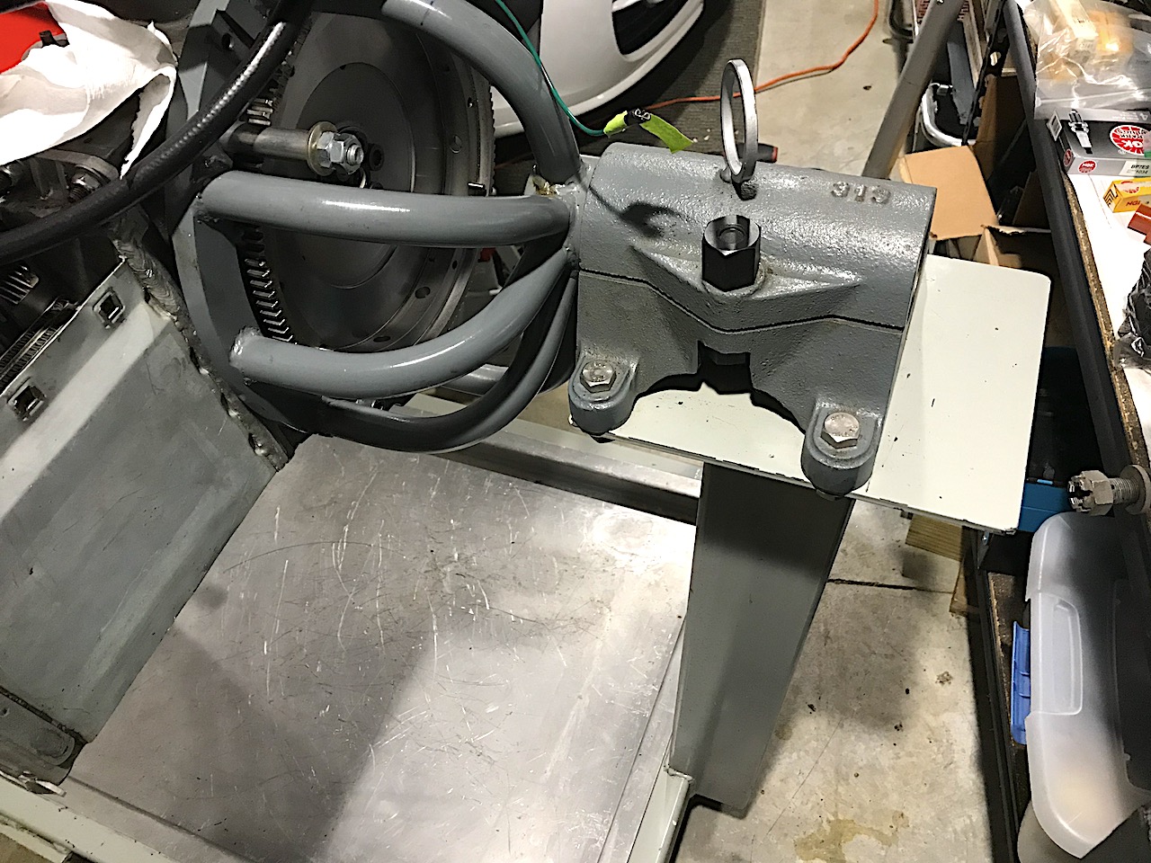

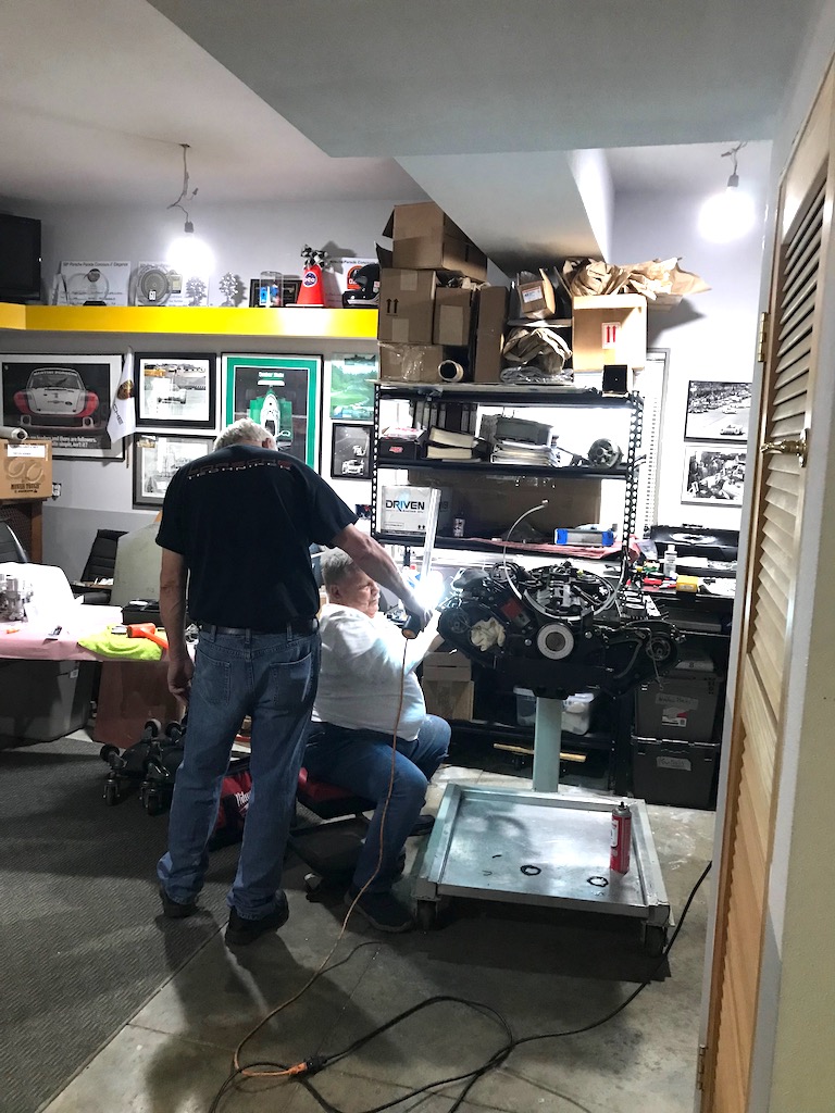

Just have one made. I went to Jerry Woods/Bruce Anderson engine building class fifteen years ago and asked Jerry if I could copy the engine stands they had (answer yes). So came home and had three made for myself and two buddies. Heavy duty, easily holds a 930 engine, nice drip pan design. still have mine today.Attached Image Attached Image

If people are interested, I will take better pictures and measure the tubing and overall size to replicate. I would not weld one of these up unless you are a Pro, I'm not so I had them done by a professional.

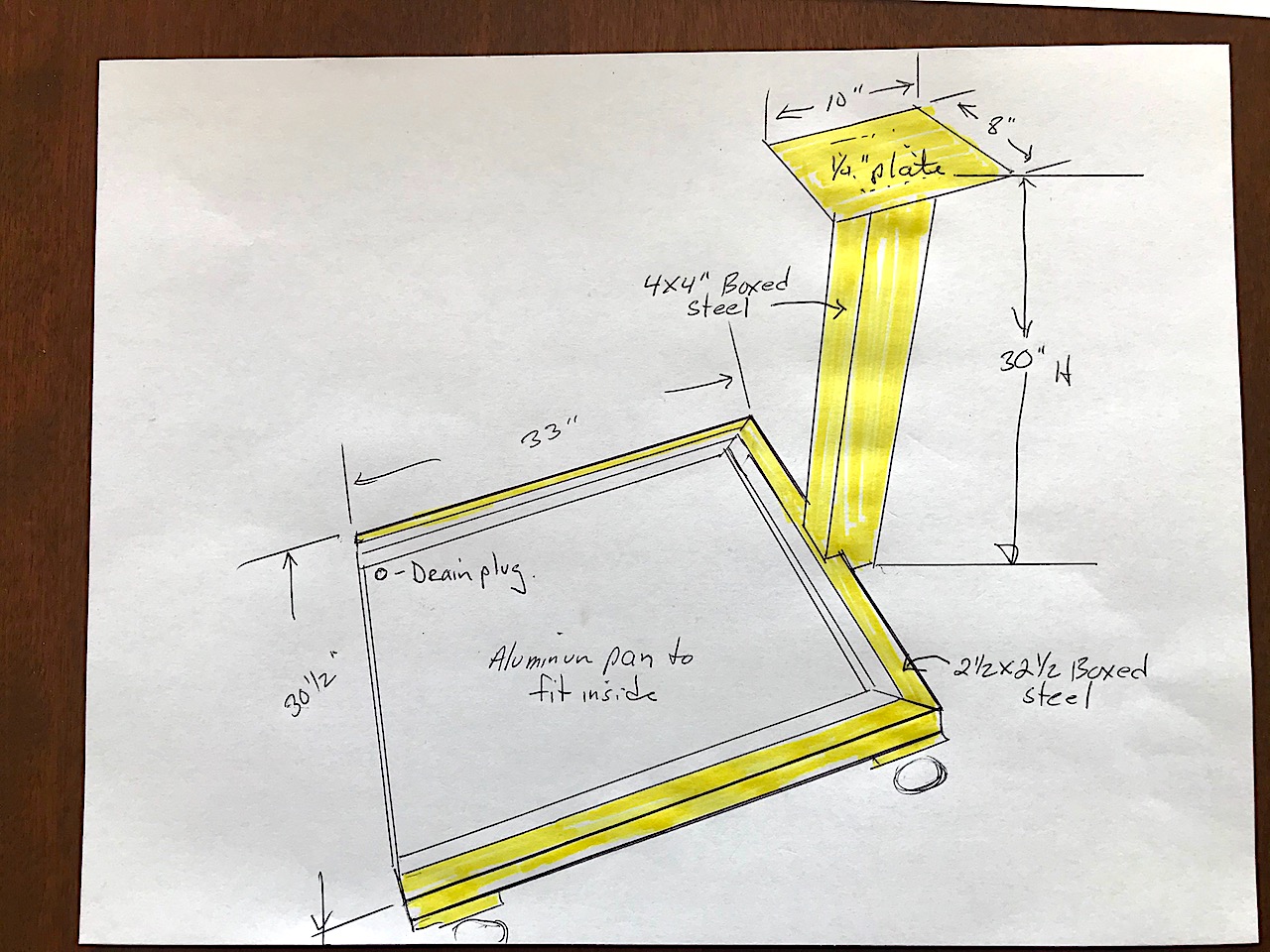

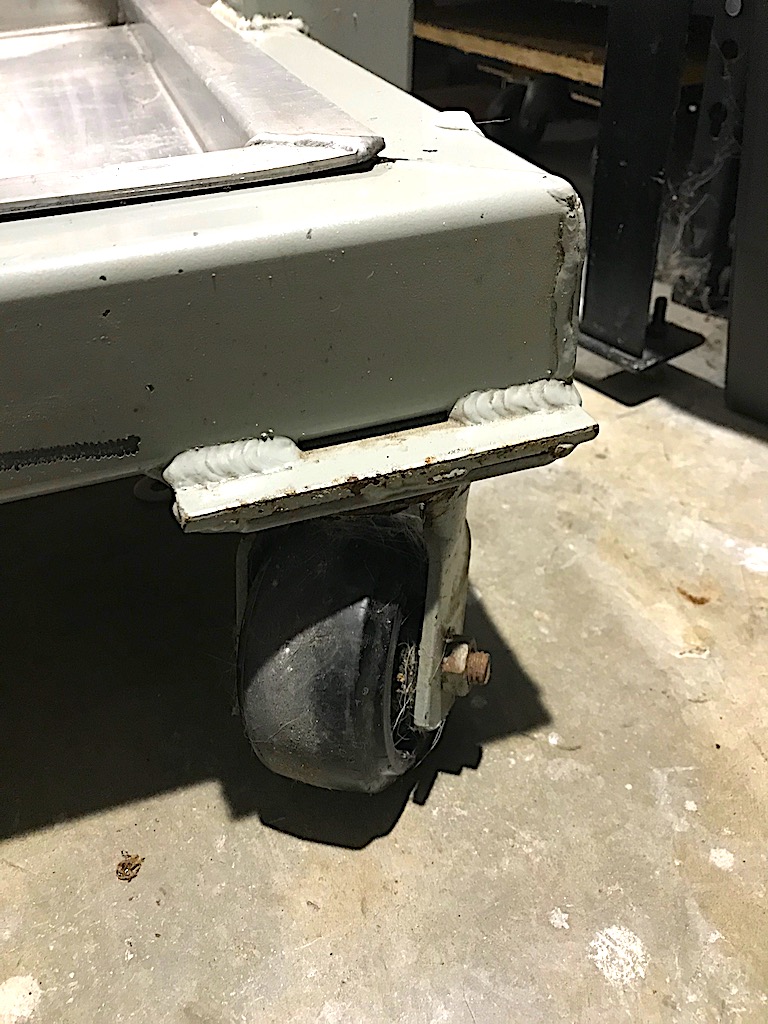

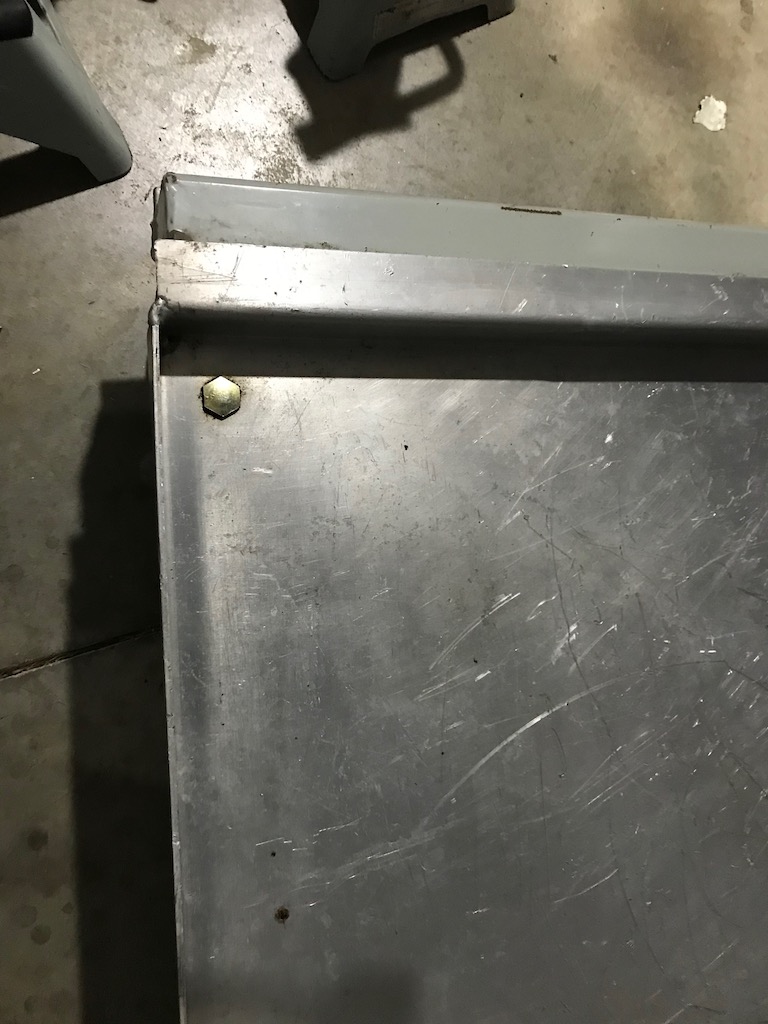

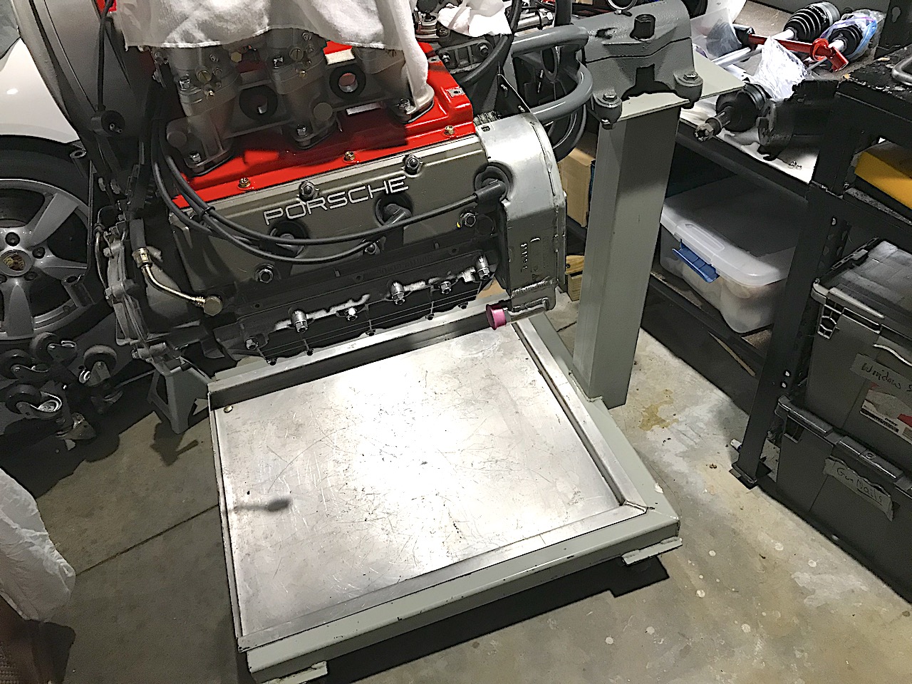

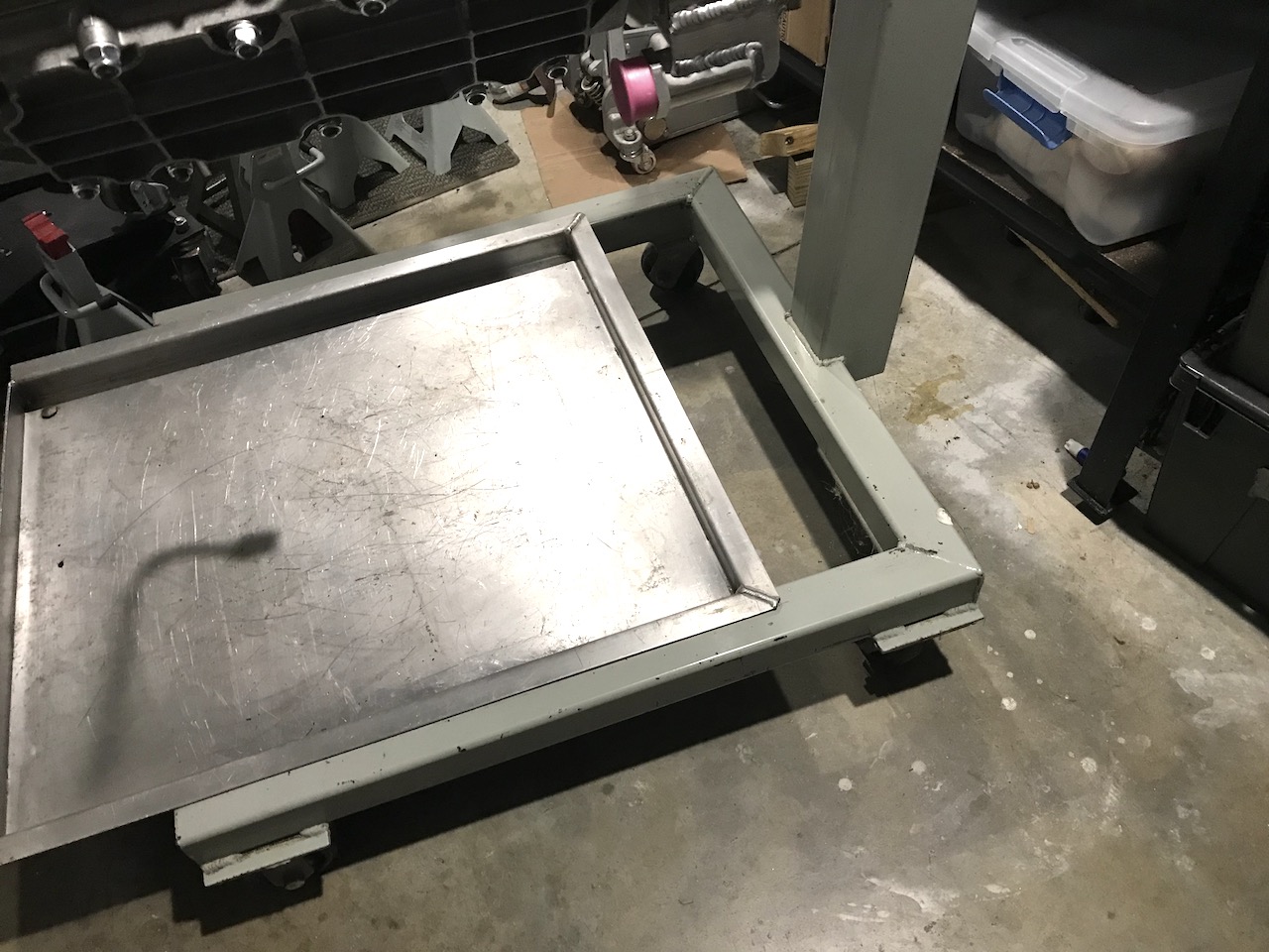

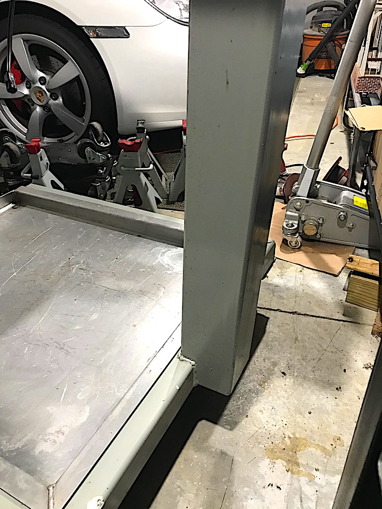

Ok, here's the picture and a drawing with dimensions. All boxed ends are welded up and pretty heavy casters. The 4 x 4inch center post for engine is titled back at 97 deg. Best, markAttached Image Attached ImageAttached ImageAttached Image[attachmentid=737

Thanks for posting the dimensions. Morrie hit me up on this as something we can make, standing 6 feet apart of course...
In looking at the dimensions I don't see any angle built into the vertical support? Every engine stand I have had has a rear-ward sweep to the vertical support. Does anyone now why this is?
Is your vertical support at an angle greater than 90* to the legs?
Is there anything different that you would do. I am looking to also utilize this for a turbo motor which is slightly heavier than a 912/914 motor.
mlindner
post Apr 1 2020, 04:32 PM
Posts: 1,748
Joined: 11-November 11
From: Merrimac, WI
Member No.: 13,770
This is at 97 deg. or 7 deg back from 90. And being this in the tool of choice for large 911/930 used by Jerry Woods it should work. Mark
