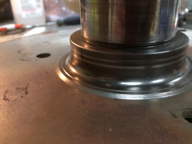

> flywheel groove, fix, leave or trash
malcolm2
post May 13 2020, 12:15 PM
Posts: 2,749
Joined: 31-May 11
From: Nashville
Member No.: 13,139
I know I have read about this somewhere. Flywheel has a couple grooves. The top one can be felt with my fingernail. So what do you folks think?
Mblizzard
post May 13 2020, 12:31 PM
Posts: 3,033
Joined: 28-January 13
From: Knoxville Tn
Member No.: 15,438
Well as long as they are not super deep I say polish the out and run.

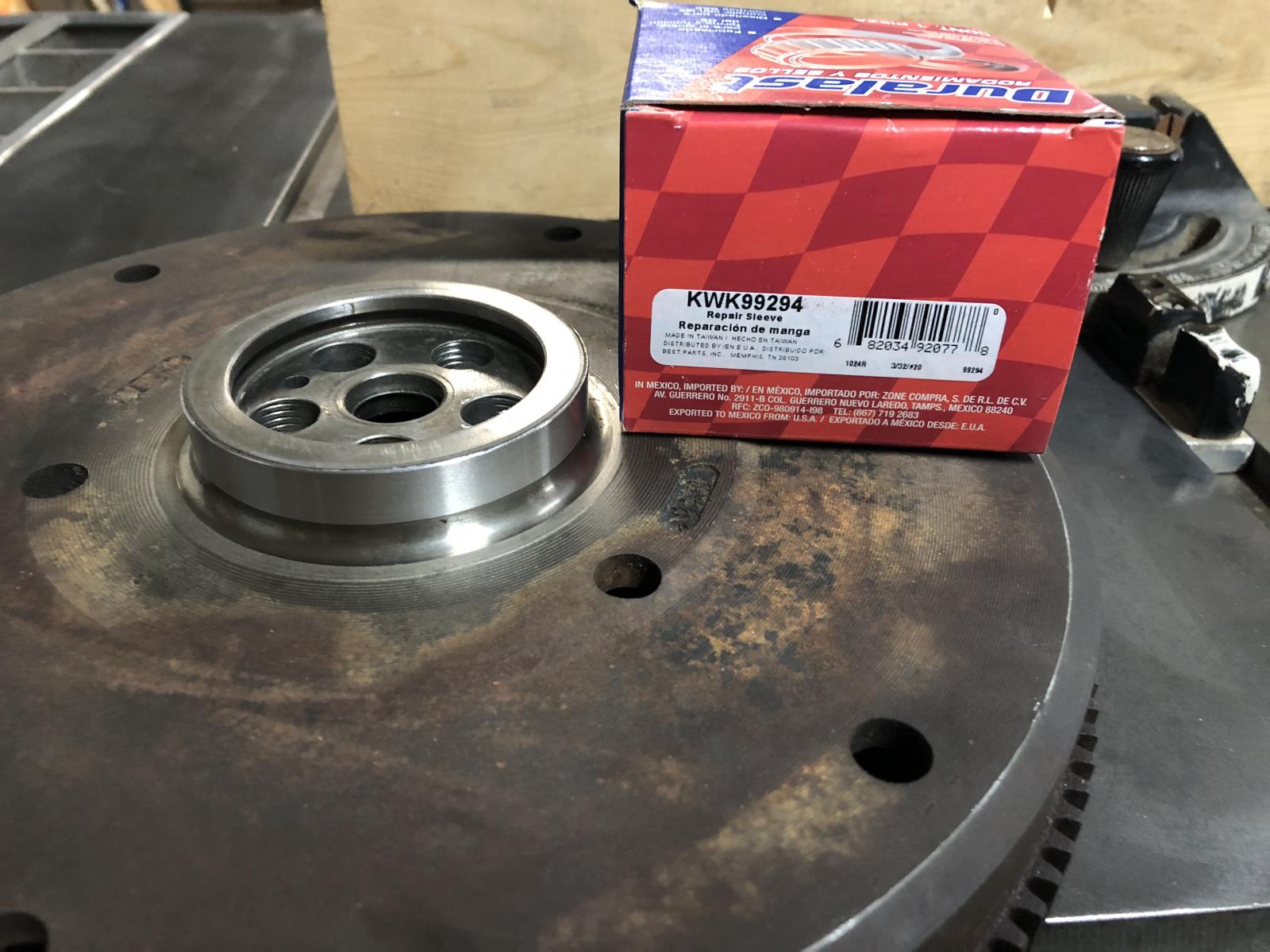

malcolm2
post May 13 2020, 12:46 PM
Posts: 2,749
Joined: 31-May 11
From: Nashville
Member No.: 13,139
speedi sleeve ??
anyone ever use something like this? I think Autozone has one too.
Superhawk996
post May 13 2020, 12:55 PM
Posts: 7,767
Joined: 25-August 18
From: Woods of N. Idaho
Member No.: 22,428
Replace. You'll thank me later.
iankarr
post May 13 2020, 12:59 PM
Posts: 2,595
Joined: 22-May 15
From: Heber City, UT
Member No.: 18,749
(IMG:style_emoticons/default/agree.gif) New ones aren't crazy expensive...and if you re-use that one, oil may get past the seal, creating a mess and ruining your clutch.
IronHillRestorations
post May 13 2020, 01:30 PM
I. I. R. C.
Posts: 6,926
Joined: 18-March 03
From: West TN
Member No.: 439
If you can feel it catch on a fingernail, it's a base for a homemade stand or scrap metal
malcolm2
post May 13 2020, 05:34 PM
Posts: 2,749
Joined: 31-May 11
From: Nashville
Member No.: 13,139
Not mine, but here is the Autozone sleeve...
Mine is a type 4, but it is a bus flywheel. NLA at 200mm in the samba post, the dude said it added 0.5mm to the diameter and provides a proper surface friction vs a polish.
Superhawk996
post May 14 2020, 03:50 PM
Posts: 7,767
Member No.: 22,428
There's always a po' man's shortcut. 914's are famous for it. (IMG:style_emoticons/default/happy11.gif)
Usually a flywheel that is that worn on the sealing surface has other wear issues on the clutch surface.
I've been broker' than broke. I understand. I really do. But, penny wise pound foolish is also a lesson I've learned from the school of hard knocks! (IMG:style_emoticons/default/stirthepot.gif)
It seems to me that three new failure modes have been added.
1) Eventual weepage between the sleeve and the flywheel. Tech sheet says: Pressure seal up to 50 psi: Suitable
for higher-pressure sealing applications; typical industrial shaft seals can handle only up to 5 or 10 psi. Should be OK. Won't have a gusher but I think weepage would still be a risk.
2) The added diameter of the sleeve will pre-load the RMS lip more and may accelerate the seal wear.
3) Position of the seal and the sleeve need to be set properly at install to allow for crank end play and the final at rest postion of the RMS such that the sleeve is always under the seal.
SKF is a decent company and probably has some testing behind these but I suspect they are intended for industrial maintenance scenarios where keeping equipment up and running is sometimes the critical task while proper replacement parts are ordered and then scheduled maintenance is done at a convenient time.
Any follow up on how this holds up over time would be cool! Always willing to learn if there is a better way.

You can offset the seal depth, but you can see this has already been done on the OP's fly.
I've never used a speedy sleeve, but you're actually suppose to cut the fly sealing surface down enough that once you install the speedy sleeve the end repair comes out at correct spec.

MartyYeoman
post May 20 2020, 12:41 PM
Posts: 1,546
Joined: 19-June 03
From: San Ramon, CA
Member No.: 839
QUOTE(malcolm2 @ May 13 2020, 11:46 AM) *
speedi sleeve ??
I have used SpeedI-Sleeves in the past. You need to be careful when cutting it to the correct length, making sure the leading edge is free of any burrs. Any roughness can jeopardize the RMS lip. The seal seems to be able to take the larger ID just fine.
