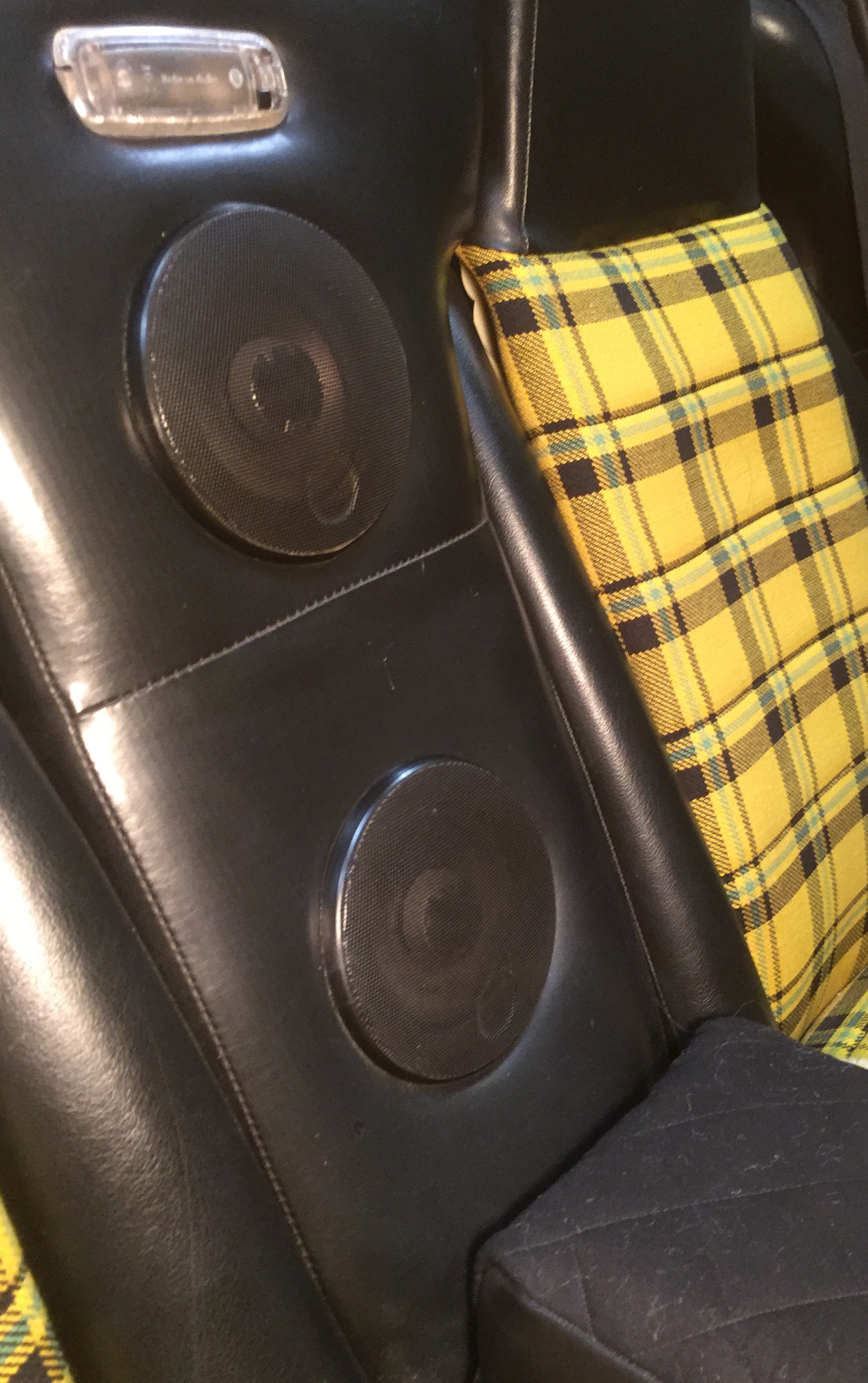

I love my two 6 inch speakers in the center of my back pad. In addition to the front footwell speakers, one back pad speaker is wired to the left rear channel and the other to the right rear channel. These pad speakers are up nearer my ears and I can balance the four channels at speed with the roof off so it sounds like surround sound inside!

Looks like a good idea. How did you mount them up? Wood and a little foam over them?
oakdalecurtis
post Jun 28 2020, 11:18 AM
Oakdalecurtis
Posts: 1,407
Joined: 5-June 15
From: Oakdale, Ca
Member No.: 18,802
QUOTE(Mikey914 @ Jun 28 2020, 07:49 AM) *
It was a long time ago I mounted them, but as I recall, I just used some small machine bolts from the front of the speaker frames through the pad's backer board. I guess you could cut some thin wood veneer circles to go through if your backer board was weak. I didn't use any foam over the back either.....

What I was getting at is the upper speaker position would have quite a bit of foam behind it before the pad in stock configuration. As it looks to be about stock. What did you do there? It looks good.
If I understand correctly, you used a "standoff" to hold the speaker in position just cutting the stock foam?

QUOTE(Mikey914 @ Jun 28 2020, 11:12 AM) *
Hey Mike, as I recall, I just used long enough machine bolts to go through the speaker frame, foam and backing and drew the speaker down into the vinyl.

Looks good, it's simple. I like it.

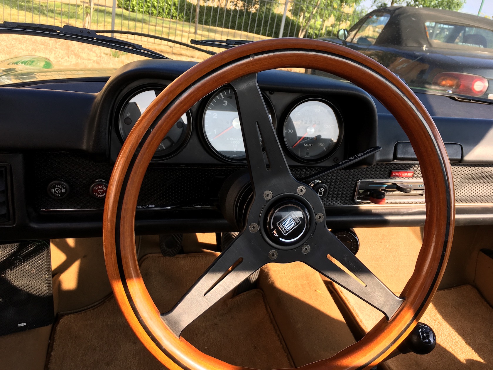

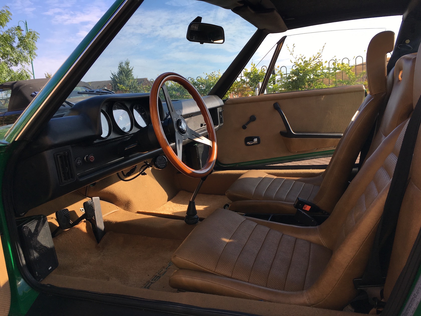

I have been using these as desktop monitors at home and they fit really nice and snugly in front of the heater pipes if you remove the speaker pods... and they are real monitor speakers: full sound and proper bass. They're around $60-100 on ebay... They have a groove round them so easy to attach them with some thin wire...
Heco Legato. Come in black or white... They are tapered in the back which enables them to fit so well: square speakers would stick out...
sorry they are in the corner of the pics!
