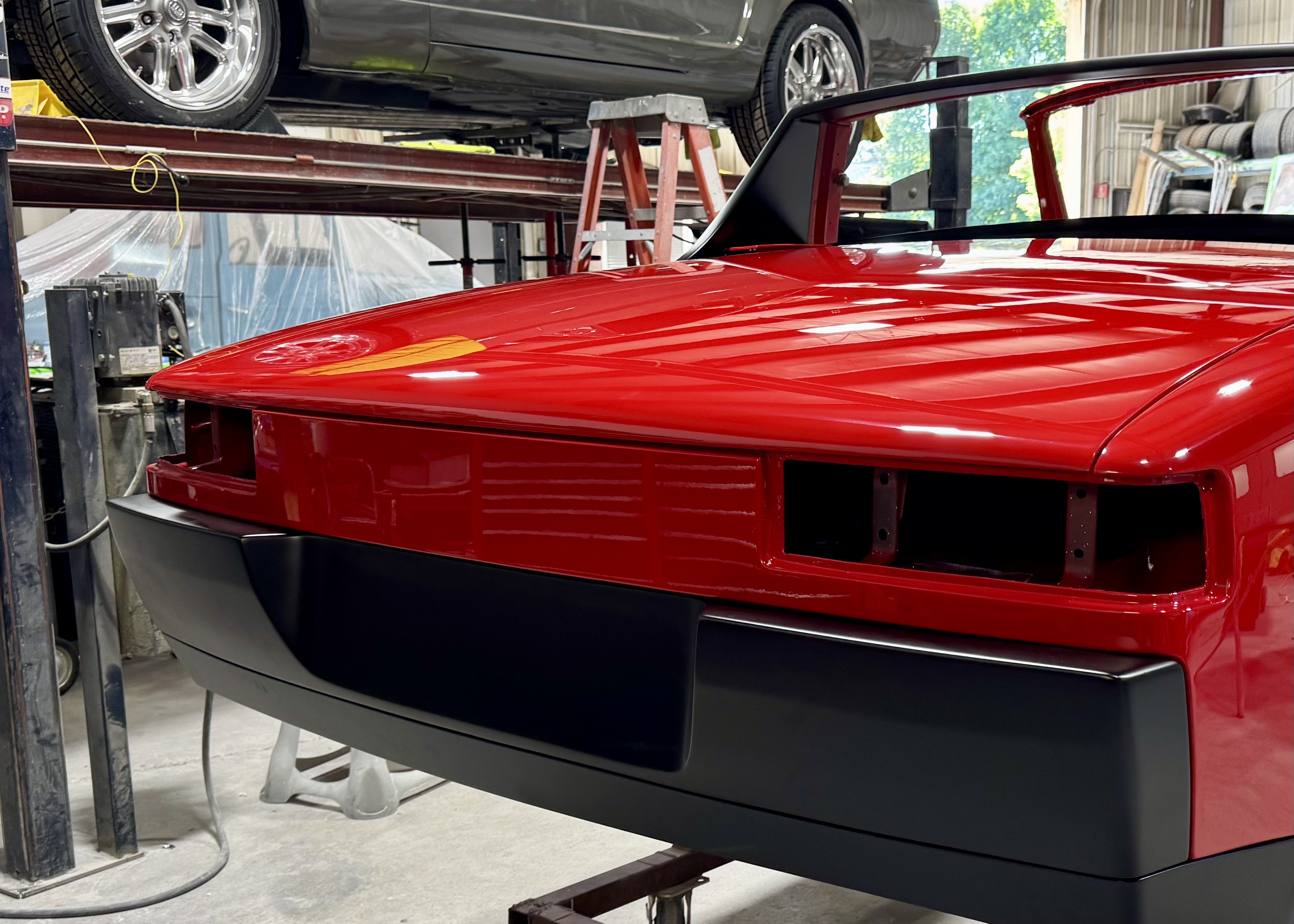

Hi all,
I’m bringing this topic back to the top in hopes of tracking down a rear trunk release kit—ideally the Engman-style mechanical pull kit.
I’ve eliminated the factory push-button by replacing that entire section with custom metalwork (similar in shape to the PORSCHE reflector, but all steel and blended flush with the trunk and tail lights). So now I need a clean, internal way to release the trunk. I’ve searched extensively and haven’t been able to find an off-the-shelf solution from 914Rubber, JWest, etc.
If anyone:
• Has an Engman kit for sale
• Knows where to get one
• Would be willing to lend or share dimensions/photos so I can reverse engineer and fabricate my own
…I’d really appreciate it.
Thanks in advance!

I’m bringing this topic back to the top in hopes of tracking down a Rear Trunk Release kit —ideally the Engman-style mechanical pull kit.
If anyone:
