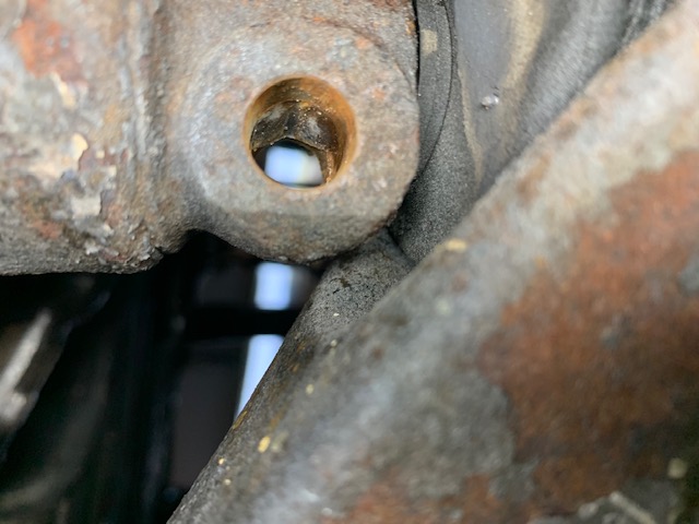

Plan to replace a arm bushings. Started removing the front driver a arm but my ball joint spindle won’t budge from the carrier. Tried tuning fork, map torch, pbblaster, and two opposing BFH. It’s rusted in there. Anybody got alternative strategies? Perhaps I need a special tool although I don’t think the tie rod remover will work here?

mepstein   I’ve removed at least a dozen pairs from very ru...   Jul 16 2020, 12:52 PM
Stltri   I’ve removed at least a dozen pairs from very r...   Jul 16 2020, 06:35 PM
Jack Standz   [quote name='mepstein' post='2834376' date='Jul 1...   Jul 17 2020, 09:22 AM
mepstein   More heat on the strut and then using a piece of m...   Jul 16 2020, 06:59 PM
Stltri   More heat on the strut and then using a piece of ...   Jul 16 2020, 07:21 PM
mepstein   The hole for the ball joint just needs to be clean...   Jul 16 2020, 07:41 PM
cuddy_k   :agree: When you're ready...there's an A-...   Jul 16 2020, 10:15 PM
Stltri   :agree: When you're ready...there's an A...   Jul 16 2020, 11:04 PM
Stltri   I finally got ball joints free. Instead of hammeri...   Jul 17 2020, 07:47 PM
mepstein   OEM foam seal. You can buy from Porsche for ~...   Jul 17 2020, 08:40 PM
jonferns   Felt washer/seal. Mine was disintegrated as well, ...   Jul 17 2020, 08:40 PM
Stltri   Interesting. Anybody have a pic or part number? Do...   Jul 17 2020, 10:06 PM
mepstein   Interesting. Anybody have a pic or part number? D...   Jul 18 2020, 05:13 AM
jonferns   Interesting. Anybody have a pic or part number? D...   Jul 18 2020, 09:10 AM
914e   Interesting. Anybody have a pic or part number? ...   Jul 18 2020, 11:05 AM
mepstein   [quote name='jonferns' post='2834882' date='Jul 1...   Jul 18 2020, 11:15 AM
Stltri   Just an update and a few question.. got the arm bu...   Jul 22 2020, 08:21 AM
mepstein   Reuse the ball joint nut and washer if they are in...   Jul 22 2020, 09:21 AM
Stltri   Reuse the ball joint nut and washer if they are i...   Jul 22 2020, 12:46 PM
mepstein   Reuse the ball joint nut and washer if they are ...   Jul 22 2020, 01:00 PM
