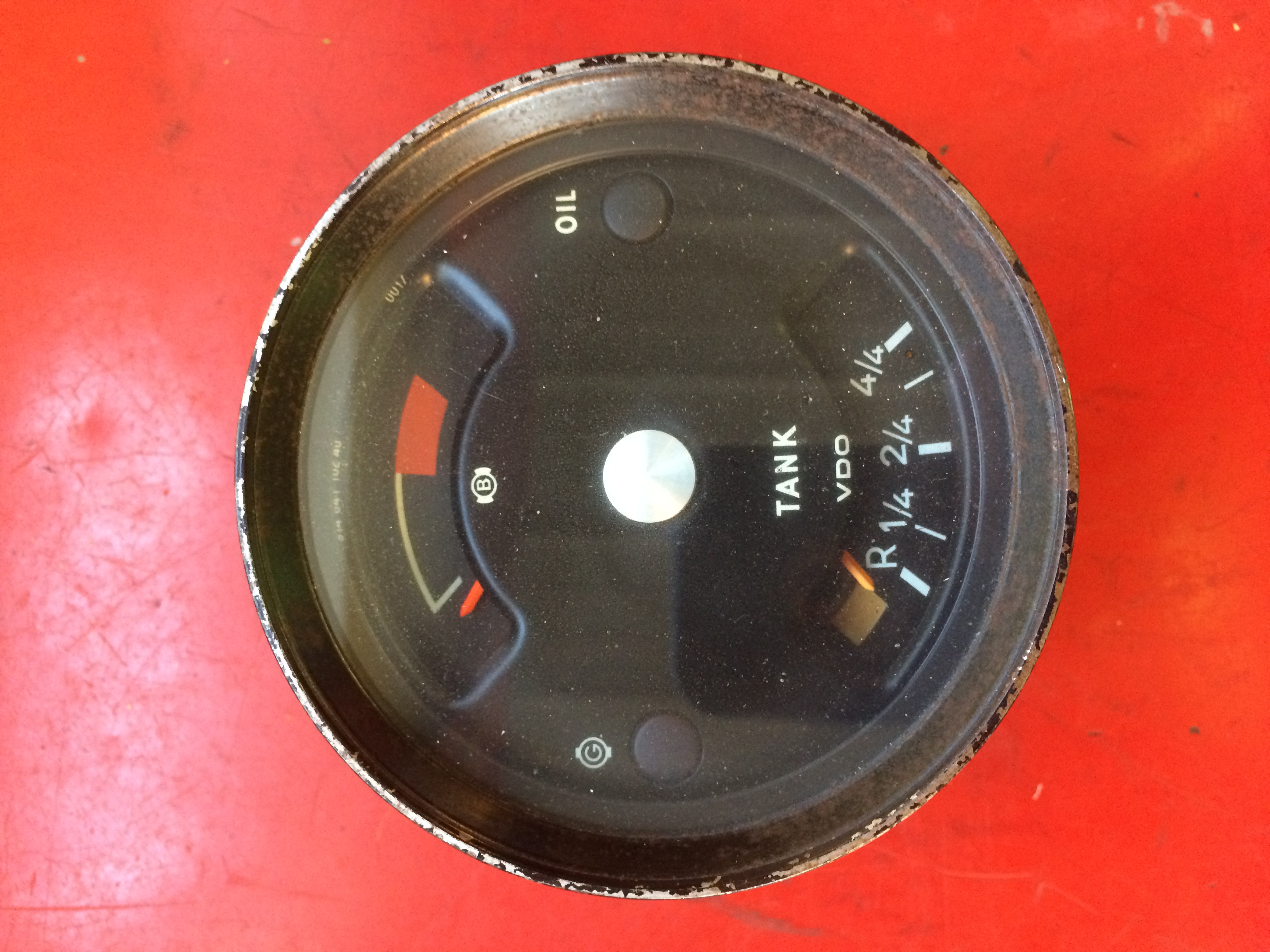

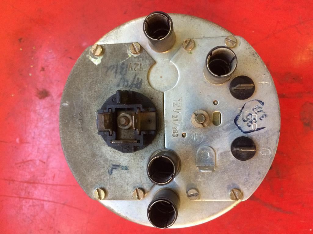

I have a gauge that I got from Slits to use in my street car
I still have not installed it, and its been a few years now
my 1st question:
-what can you tell me about this gauge?
is it 1972 or 1973?
silver dot
so maybe a really early 73 appearance gauge?
I'm not selling this one, just curious and for my own use
2nd questions:
-how do I determine if my current senders, or which senders will be needed.
Currently I have a -6 fuel/oil temp gauge in the dash
its wired to the correct sender in the taco plate
it was 20 years ago... so I'll need to pull the sender to find out which model number it is.
any way I can tell from the numbers/model of gauge which sender is correct to use with this one ?
the fuel side of this "new to me gauge." Its a 914/4 gauge, with a stock 914 fuel tank and sender. I'm betting it is within the correct 90 -0 ohm range since it likely use the stock sender in the fuel tank. How can I verify that, or what do the experts and charts indicate as confirmation?
thank you in advance everyone!

That looks like a stock 1973 914-4 combo gauge. You can tell the difference between 73 and the later years because the "red" zone is much wider, and of course the silver dot. It was slimmed down to a fraction of that in 1974 because people were getting alarmed that their engines were overheating when they weren't.

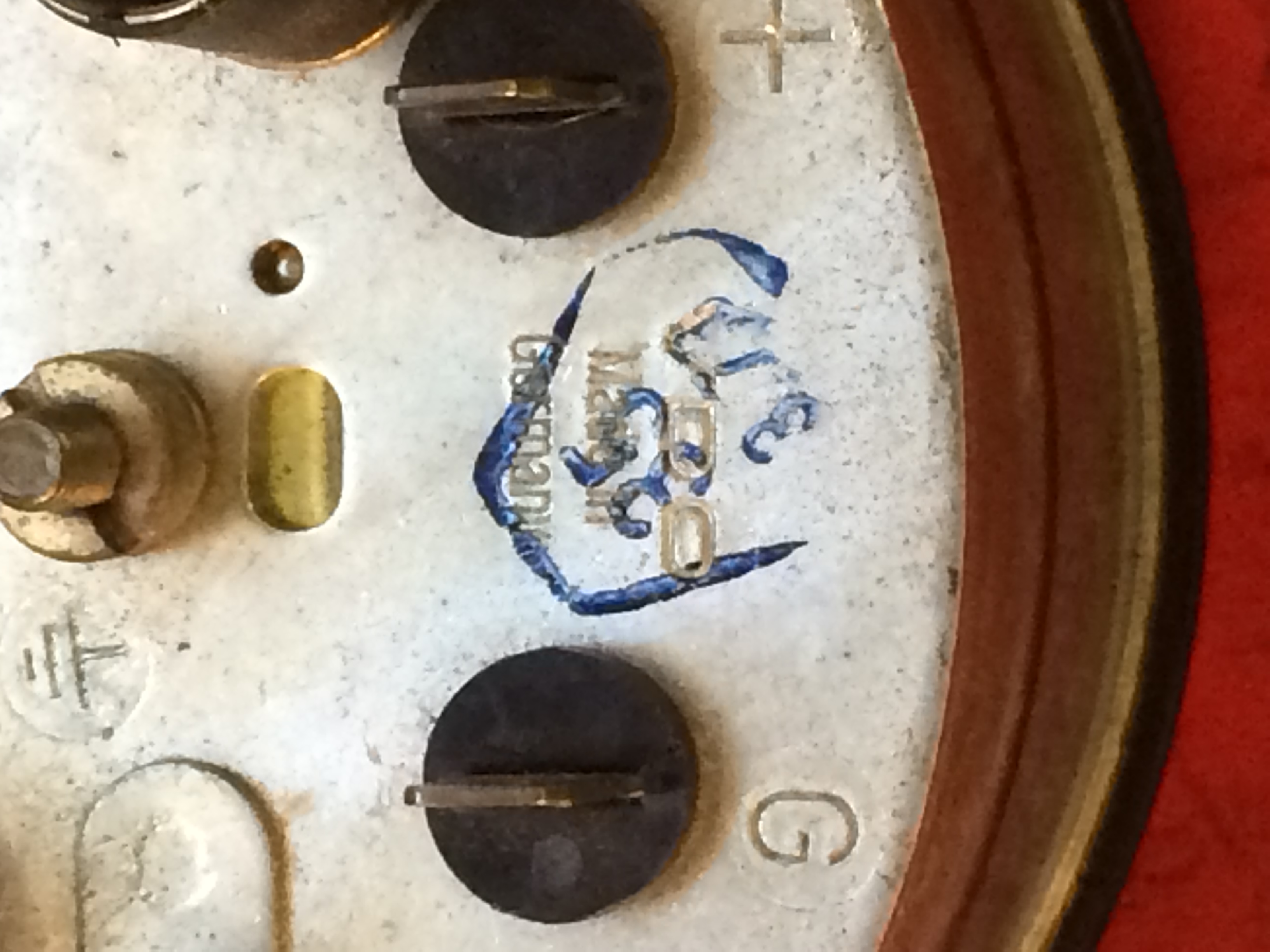

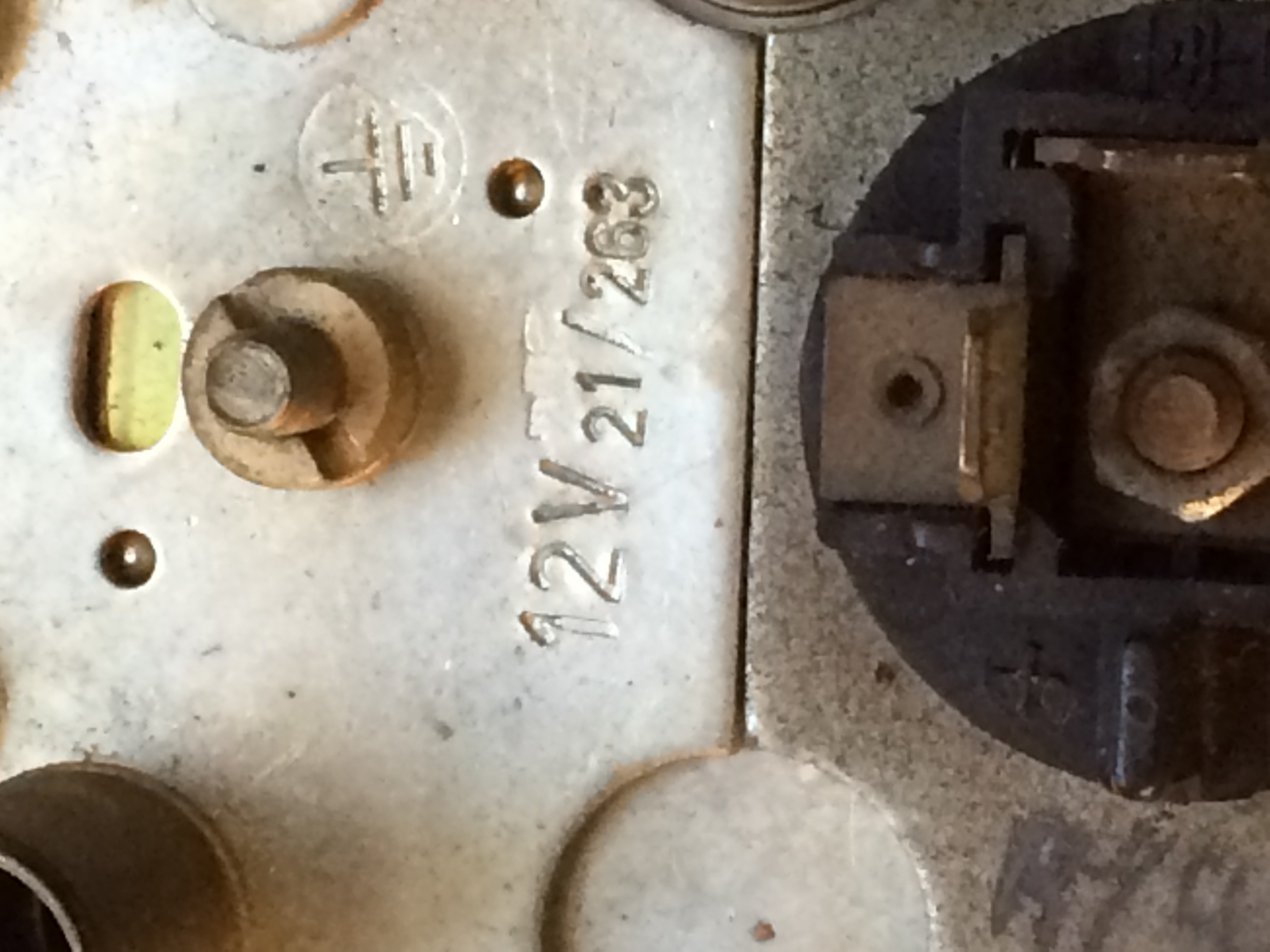

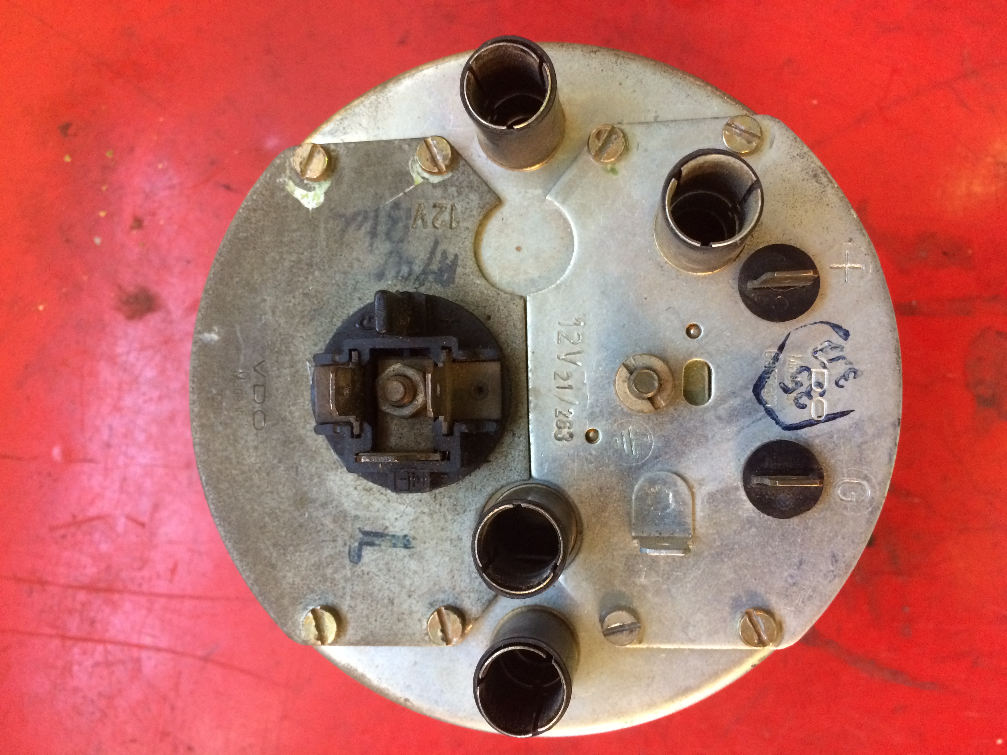

Brant - minor word of caution here: this size and style of gauges was used over several models and over a number of years; also, it is relatively simple to pull the mechanisms from the back and swap them out, but to compound that, it also easy to swap around the fascias too. In other words, the gauge mechanism you think may be inside MIGHT NOT not be what you're expecting...
So looking at the shots you posted, the variation in corrosion of the two gauge halves MAY be an indicator that one of them has been swapped out? Usually the pattern of corrosion tends to be uniform, as all metal components are exposed equally. Another clue is that when new, VDO (usually) put some green gunk (technical term) on each of the fastener screws to thread lock them; on untouched, pristine units you can usually still see remnants of this in place - again, the shots of yours indicate the securing screws have been removed at some point.
Again, comments are cautionary. Please don't take this as negative or critical intent!

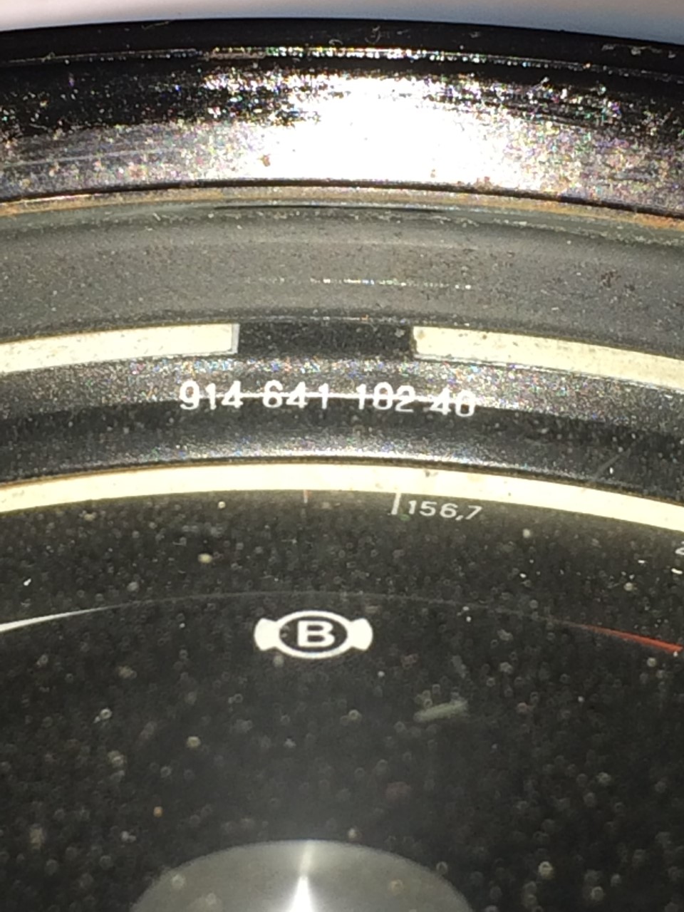

If you tip the gauge up and look at the area just above it, you will see a part number. A good parts guy can cross reference that gauge part number with the correct sender.
@partsguy22 can help if you give him the part number. It's not really clear in the picture.

post Jul 24 2020, 12:16 PM
Posts: 12,167
From: Colorado
Member No.: 47
Tony,
I just got the thing from the garage and took another look
I can see that the screws on the back have all been molested... driver marks from a poor fitting screw driver.
how do you recommend I tackle this?
to find the correct range oil sender to match my gauge
brant

post Jul 24 2020, 12:17 PM
Posts: 12,167
From: Colorado
Member No.: 47
picture of the part number for the gauge

QUOTE(brant @ Jul 24 2020, 01:17 PM) *
@partsguy22 , can you help here?

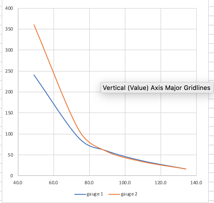

One approach is to get the sender you think is right, hook it up with the gauge on a bench and do a temp check - room temp and boiling water at a minimum. All of these sensors work by changing their electrical resistance as temp varies; I have access to a programmable resistance box, so I can use that as a "dummy" sender to see what any target gauge is ideally expecting as a sender, so - for instance - a 911 combo gauge expecting a 901.641.632.00 sender would look like this:
..where the horizontal axis is indicated temperature (degC), the vertical scale is "ideal" sender resistance (ohms). Data for 2 different gauges plotted. Note the two "identical" gauges differ a bit at low temps, but are consistent where it matters.
So I can characterize a gauge: The REAL trick is uncovering the specs of the various senders we know and love to match the above type of plot. VDO publish some data, but it would be great to find a comprehensive source of part number vs. transfer function over temp. Anyone...?
- Tony

also - @brant - Notice there is the "B" symbol under the top section - this tells me this was originally a standard combo gauge and the brake warning section has been replaced with a temp gauge....right?

after looking closer at the screw heads, broken green Loctite, different amounts of tarnish... I'm pretty sure the "B" brake warning light is different from a 914 combo gauge. it might have been made out of parts? dunno
so It looks like there are really only 2 different oil temp sensors
I don't want to drain my fresh oil.
so I'm going to get the 300 degree... test it with the gauge in boiling water
before install at the next oil change.
