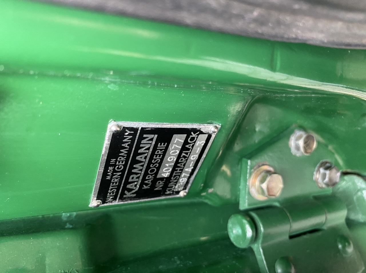

I am just getting round to registering the car over here in the UK now the restoration is complete
I have the certificate of title but cant find the date of original registration, is there a way of establishing this please?

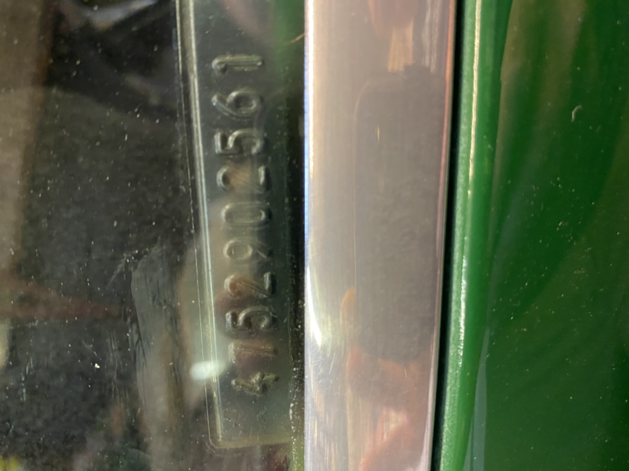

dt4
post Jul 27 2020, 06:25 AM
Posts: 503
Joined: 26-May 19
From: England
Member No.: 23,161
Region Association: England

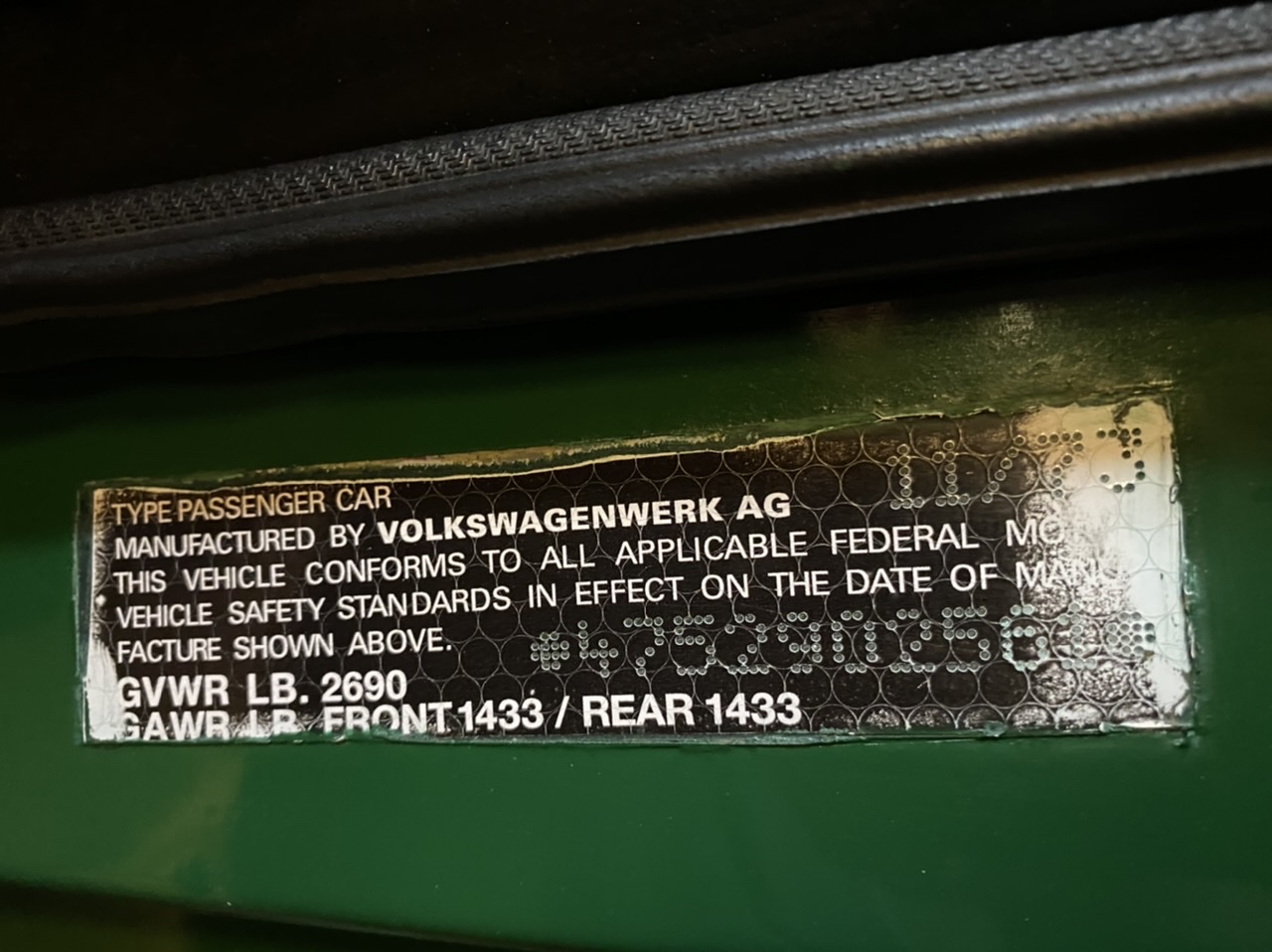

The door jam sticker
How is the date interpreted from this pleaseAttached Image
Cairo94507
post Jul 27 2020, 06:34 AM
Michael
Posts: 10,609
Joined: 1-November 08
From: Auburn, CA
Member No.: 9,712
@dt4 That is the Compliance sticker which is required in the USA for registration. It shows the date of manufacture of the car in the upper right corner, 11/73 on that particular sticker. Of course then it has to get put on a boat and sent to the USA and get transported to a dealership and then sold. It was not uncommon for 914 models to sit for months and months at dealerships awaiting purchase by someone.
If you could narrow it down with any kind of paperwork you might find in the car to a specific state in the USA you could contact their Department of Motor Vehicles, (responsible for registering all cars on their roads) and see what they show for first registration. But that may be a long shot.
You might get lucky by posting the VIN, (the long number on that sticker or the metal ID tag along the A-pillar) here and pictures of the car and see if anyone remembers the car.
In the sticker posted there is something not right. The manufacture date appears to be in 11/73 and the year model, according the the VIN is a '75. So the VIN is easily verified by the metal plates and stampings on the chassis. The manufacture date has likely been messed with. (IMG:style_emoticons/default/beerchug.gif)

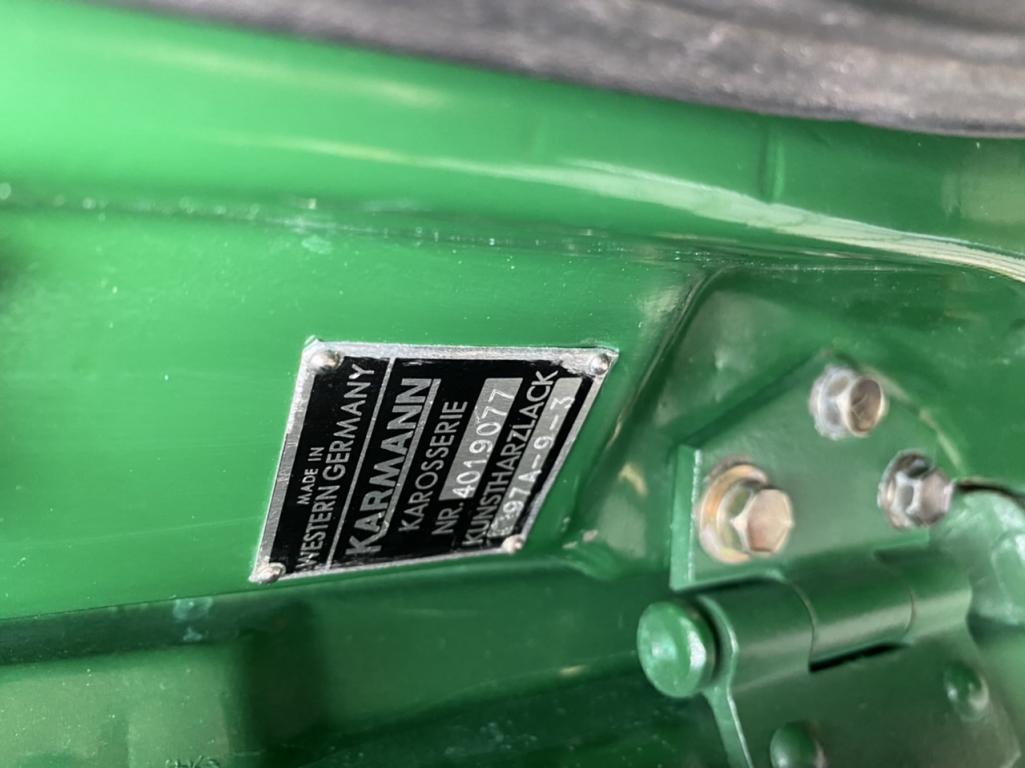

The Karmann ID tag will tell you the date of production for your car.

QUOTE(Cairo94507 @ Jul 27 2020, 05:34 AM) *
That's a weird one 11/73 would be a 1974 model year, with the amount of differences between a 74 and a 75 it should be not too difficult to see which set of numbers is incorrect.

The VIN is in the photo and stacks up with the door jam and the plates in the front of the car and title

QUOTE(dt4 @ Jul 27 2020, 12:39 PM) *
Based on the pictures, I would bet that the emissions sticker was punched with the build date in error. We have people on here that make replacement sitckers, I would get one with the proper build date and replace it.

It's possible that the Compliance Sticker should have been 11/74 instead of 11/73. The VIN indicates an early production 1975 model year so the 10/74 build date from a previous owner also makes sense. Maybe the the stamping mechanism for the sticker was off one digit for both the month and year of manufacture.
Unless you are required to submit further documentation for the initial registration date I would be creative and just pick an appropriate date and submit the application. Let them prove it's accuracy.

QUOTE(KELTY360 @ Jul 27 2020, 07:45 PM) *
I am inclined to go with 01/01/1975 and then if necessary can provide the Karmann plate photo for build date and title has the year as 1975

I would be inclined to go with the production date from deciphering the Karmann tag as that is the date the car left the factory. As was already said, it would have been registered some months later but that gives you a solid and provable date to show the car is vintage. It will also verify if your compliance sticker was punched wrong.
FYI, there are 4 places the VIN number would appear. In addition to the two you have shared, there is also the plate riveted inside the front trunk and also stamped into the chassis on the right front wheel well inside the front trunk. https://bowlsby.net/914/Classic/PLM.htm

QUOTE(bbrock @ Jul 27 2020, 08:26 PM) *
thanks, I have checked them all and they coralate
dt4
post Jul 27 2020, 01:47 PM
Posts: 503
Joined: 26-May 19
From: England
Member No.: 23,161
QUOTE(dt4 @ Jul 27 2020, 06:39 PM) *

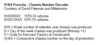

wouldnt the numbers on the plate equate to week 40 day day 1 number chassis 77 and 1975?

QUOTE(dt4 @ Jul 27 2020, 04:25 AM) *

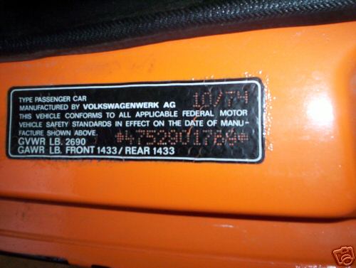

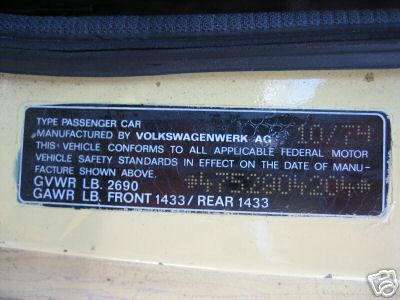

The date on the Compliance decal is 11-73, and means November 1973.
However, that has to be an error; about the third error I know of with these compliance decals for a 914/4.
In the range from 4752901769 to 4752904204 all have decal dates of 10/74
It is possible that the chassis was delayed for some time and was actually completed in November. They may have needed to make up a special decal for it and made an error with the date. 4752902561 is very obviously a 1975 model year car, so a 1973 production date is totally out of the question. Just accept that the month is correct and go on from there.
The actual date of first registration is either known from paperwork included with the car, or has been lost forever.

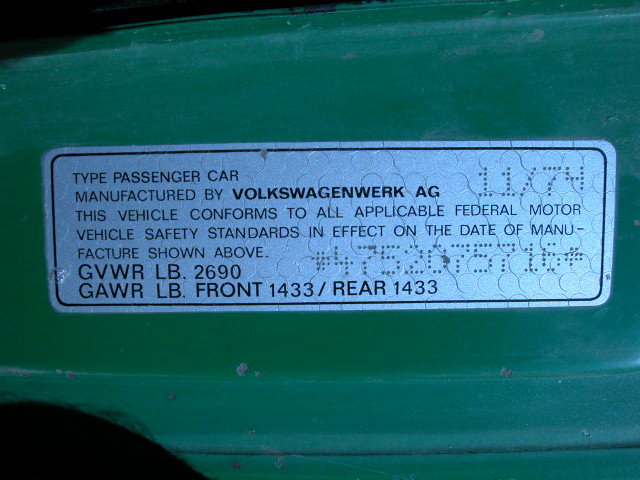

here is one of the other errors at the same time
dt4
post Jul 28 2020, 08:51 AM
Posts: 503
Joined: 26-May 19
From: England
Member No.: 23,161
@davep
would the numbers on the plate equate to week 40 day day 1 number chassis 77 and 1975
