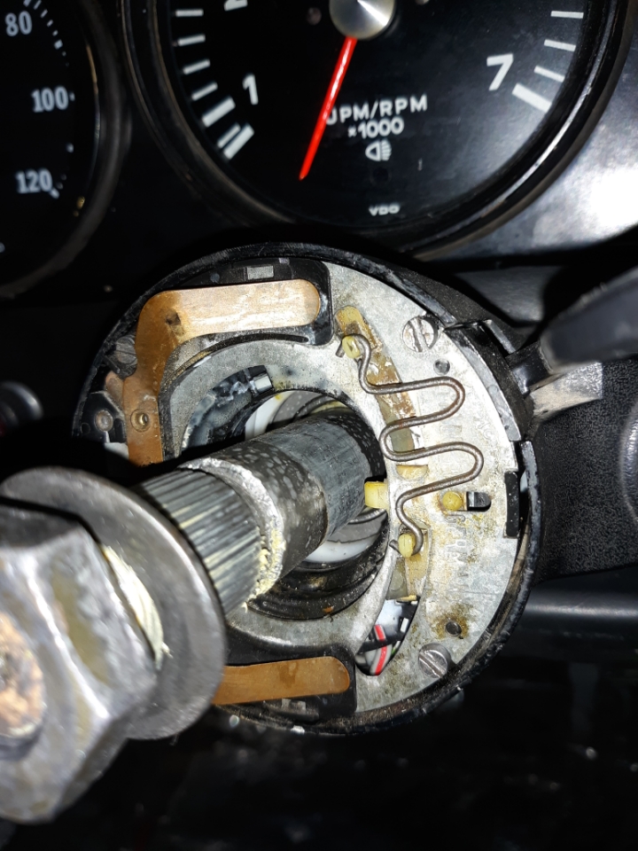

post Aug 8 2020, 08:54 PM
Posts: 1,619
Joined: 7-September 06
From: Grand Island, NE
Member No.: 6,787
All tabs look ok. Loosened the 4 screws a bit, but still drags a bit. I sprayed some contact cleaner in there. Seemed to help, so might use the air hose to blow anything else out?
Seems like it might just be gummed up?
FlacaProductions
post Aug 8 2020, 09:26 PM
Posts: 2,176
Joined: 24-November 17
From: LA
Member No.: 21,628
i'd loosen the 4 screws a bit more and wiggle the switch back toward you 1/8-1/4 inch or so if you can. see if that makes the turn signal stop binding. if so...slide it back in and just barely tighten the screws down. blowing out the crud and a little lube can't hurt.
