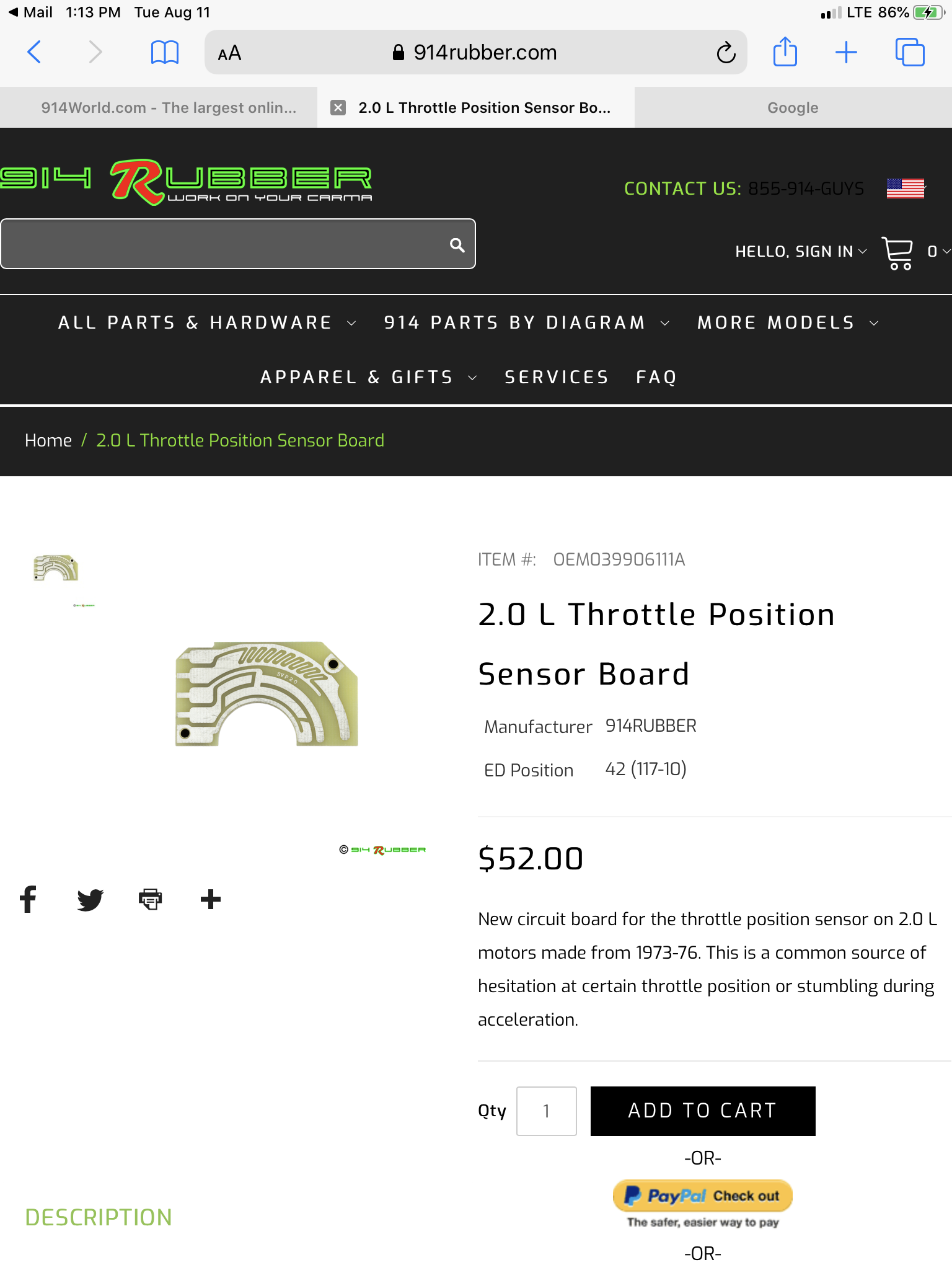

New TPS boards can be purchased now from 914 Rubber or a few other sources. I'm sure others will chime in.

Yep
It is a simple process to replace worn boards
We have both 1.7 boards and the 2.0.
Here’s a link to all the boards
https://914rubber.com/search/?q=TPS

He is asking for the throttle body bushings to be replaced, not the boards!

The TPS does not get rebushed only the throttle body.

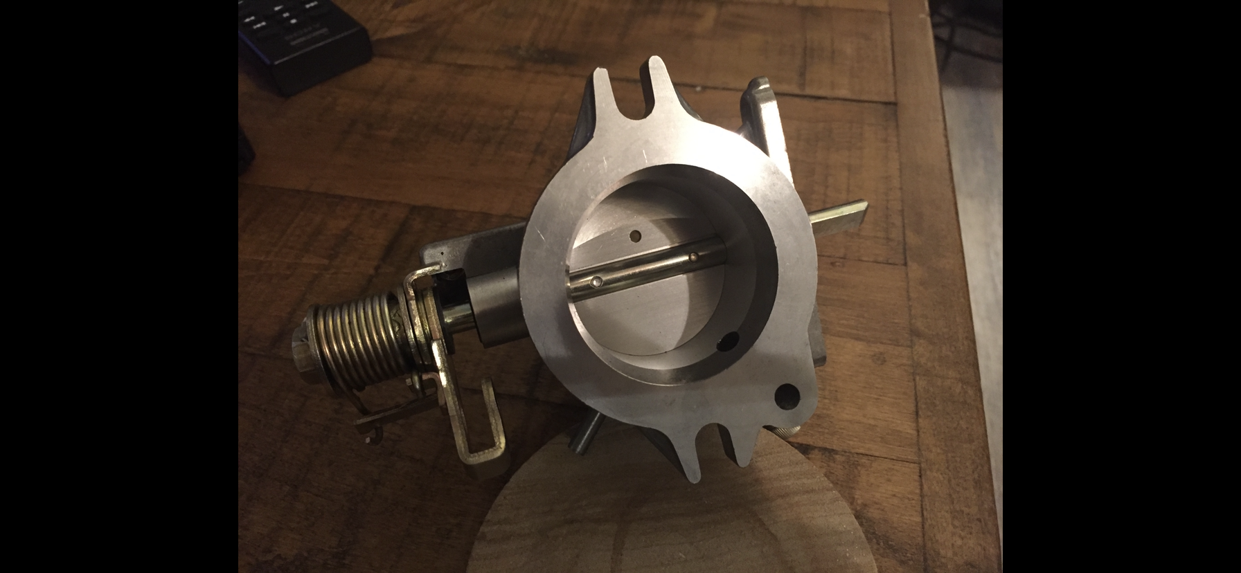

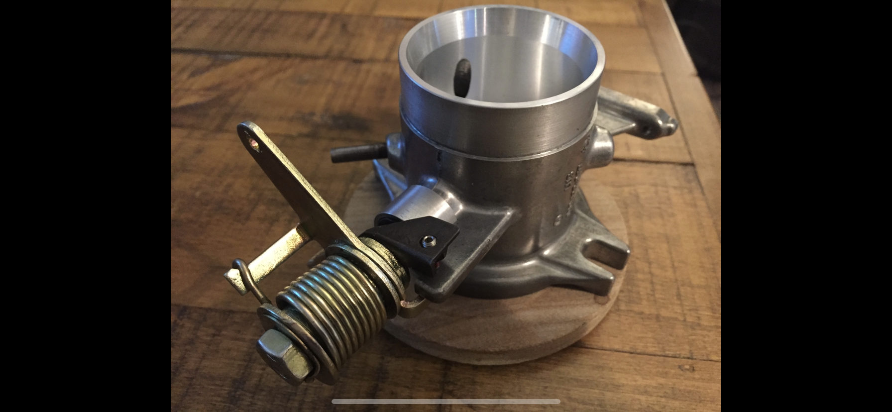

i had mine done by Phil Eslin, he is the guy in NM, screen name is @Whip618
but he did a full clean, polish, new bushings all new shaft, butterfly valve, springs etc etc, and its better than new. Yes it was a bit pricey, i think about $350 2 years ago, but worth it in my opinion.
if i can find a picture i will post it. but for my d-jet car, with this, a new TPS, new wire harness and rebuilt MPS from Jeff Bowlsby, and all new tin and heater bits from bdstone, and a 123ignition distributor, it runs like a new car. And if you want a good running 914 2.0 d-jet i think you have to do all these things.

a couple pictures after the work was completed

one more...
