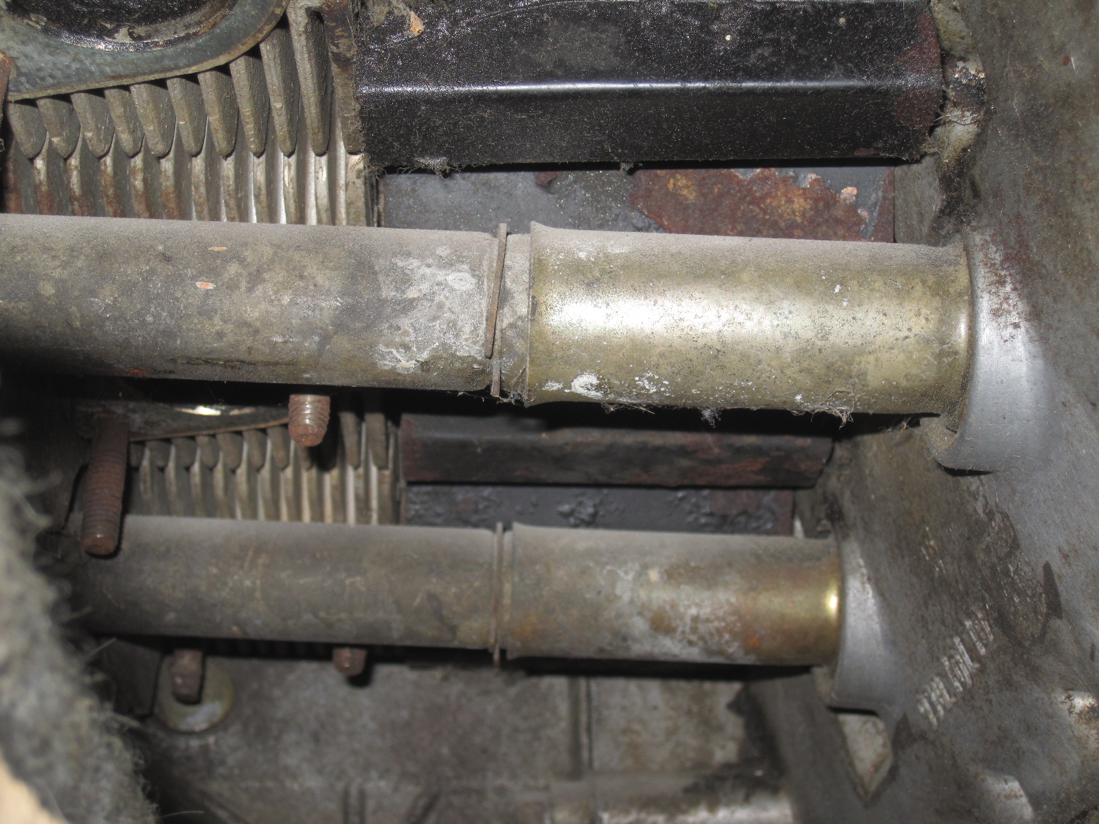

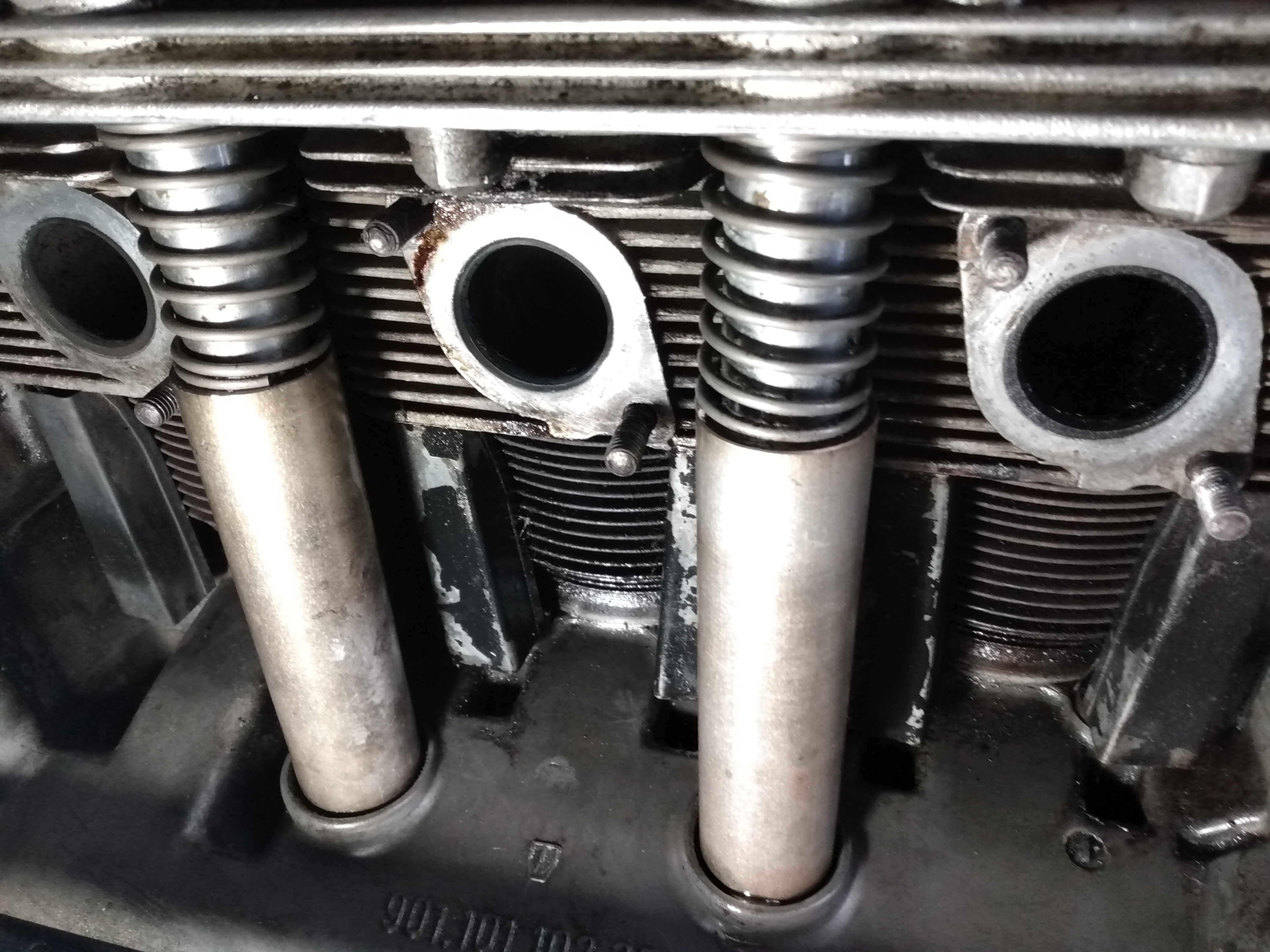

Thanks. So can anyone identify these? At least 30yrs old, probably closer to 40+ if they aren't stock. Pretty sure one or more are leaking at the case end, but it only seems to happen after the car sits for a long time and the oil drains back into the sump (hence the reason I'm doing the check valve). I'm not really up for pulling them and finding out I can't get new seals so they have to be replaced. Attached Image

Never saw that type. The o rings look black. Never saw springs. The newer o rings tend to be green.
There has to be a seal some where inside to seal the two tubes against each other, also probably an o ring.
Might be worth trying new o rings and seals, but this is a PITA job you only want to do once.

I've seen two versions of the expandable tubes. One is made in steel other in aluminum. I'm not sure which is better but I do know that they are a real pain to install. As for removing the old tubes I only did one before. What I did was crush the old steel tube and bent it enough to slip out of the cam tower. Have fun installing the new one. Another pair of hands helps. One person holds one side that's seated while the other tries to seat the other end while trying not to crush the new tube. Use the green o-rings with some type of lube. I've used the DOW corning 55 and seamed to work fine.
As for the tubes on your engine, I've never seen them with the external springs like that. Best of luck.

your tubes with springs are aftermarket
I've never seen that style before... but some aftermarket design that didn't last through the years.
the current aftermarket design works well
so you may want to consider switching over to that
or reuse what you have with the right o'rings
but definitely yours are not stock from the factory style.

I've never seen or heard of ones with springs.

Well, I may have done them in the late 70's when I had the top end apart, or George/AA did them in the late 80's when I had him do some work on the car. Either way, they certainly have lasted and no apparent corrosion. At this point I don't think I'll "fuch" with them. No leakage from the outer side, and it appears the case/inside only leaks when the tank was draining back into the sump and filling it up.
To my mind, a spring loaded assembly like this would be better than a rigid tube. I'll pull them if it starts to leak badly or when/if I do an engine rebuild. I want to get it back running before the snow flies.

I too have never seen that type used before,on a VW T1 yes but not on a 911 motor,if you can turn them thats most likely your leaks.
I used the alloy external spring type on a T1 1600 and they worked well,they were used when I got them so I replaced the internal "o' rings which turned out to be an odd size,ended up getting them from a hydraulic repair company.

I just tried turning them to be sure they weren't stuck. Maybe an O ring on each end, possibly cracked at this point. Still thinking I don't want to mess with them right now so I can get back on the road for a little bit.

If the leaks are small that's most likely the best thing to do,don't think you have a cracked "o" ring as you really know about that,most likely they have dryed out and shrunk a little in diameter.
Don't worry about oil leaks,I fix a couple then others start but you get there,I have one I can't fix but not losing sleep over it,cheers.

(IMG:style_emoticons/default/agree.gif) , how can this not be better than no spring at all, at least for after market? I've seen 'em before too.. but maybe it was type I, not sure. Do we know for sure that Type I's have different dimensions? I might be interested in getting some.
