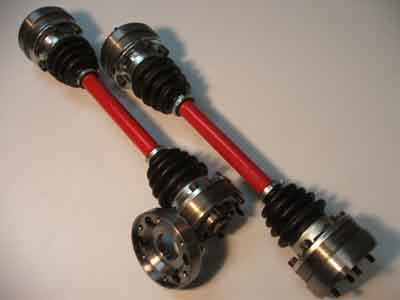

If you really want to do it right and never worry about it again, then while not cheap. The Tarett Racing replacement axles are hard to overlook.

QUOTE(Mblizzard @ Sep 4 2020, 04:18 AM) *
That is well worth the money. Maybe someday for me..

QUOTE(mb911 @ Sep 4 2020, 11:23 AM) *
I bit the bullet and got these. The6 are worth the cost and you will be hard pressed to make them fail.
