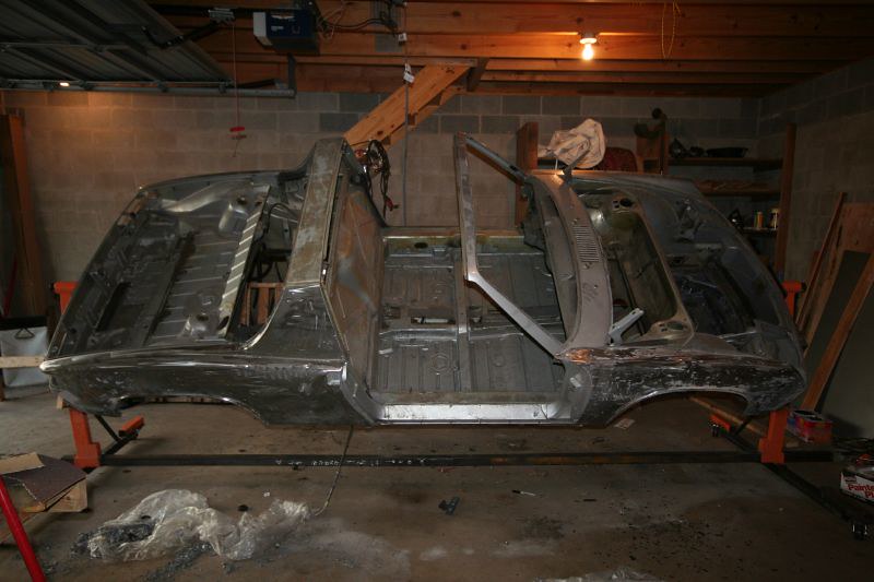

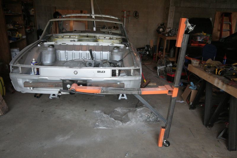

I did it.
Strip the car. Do the structural stuff and brace the hell out of it.
Since yours is a 75 this is stupid simple. Take the bumpers off and attach the rotisserie to the shock bumper mounts. That's exactly how I did it on mine.
(IMG:https://live.staticflickr.com/87/236318251_7c909895da_o.jpg)
This is when I was test fitting the one I built out of HF 700lbs engine stands.
You can see I just used a cross bar and bolted it directly to the bumper shocks. I stacked washers into the gap for the shock mounts to make sure the ears did not collapse. The balance point was SPOT ON.
(IMG:http://www.914world.com/bbs2/uploads_offsite/live.staticflickr.com-1435-1600792000.1.jpg)
I tied the two hacked up stands with a cross bar that used the existing front leg mount. Easy to build. When I was done I sold the Rot quick and for a profit to boot. Car was up on it for 2 years while I did the restoration.

In this picture the body of the car is supported on Jack stands front and rear. Only the back end of the rotisserie is attached as I was testing fitment. The rotisserie is laying on its side, not supporting anything. IIRC I wanted to be sure that once I had the car bolted on I would be able to rotate the car around the rotisserie and I did this by lifting the free end and making sure everything cleared as it spun on its axis.
Or am I misunderstanding? Are you concerned about mounting the car via the bumper mounts?
The car was on the rotisserie very stoutly, yet rotated easily on its axis.
Zach

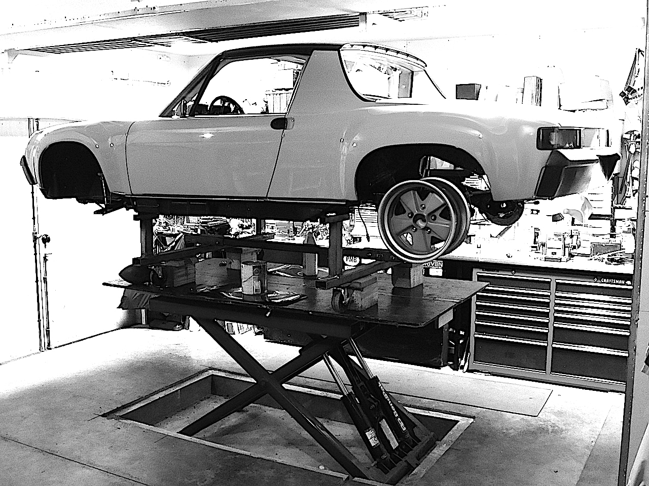

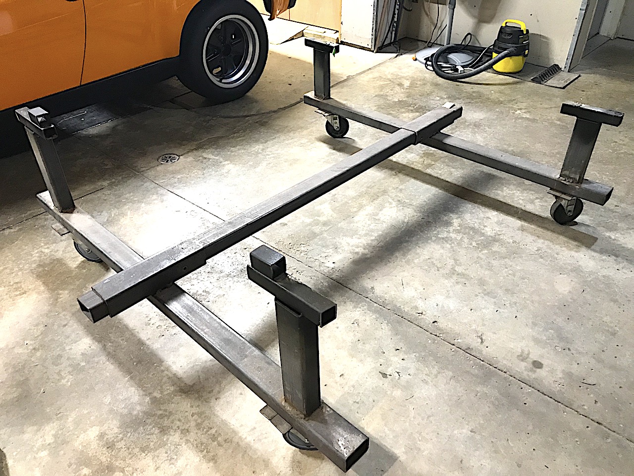

mlindner
post Sep 23 2020, 05:50 AM
Posts: 1,748
Joined: 11-November 11
From: Merrimac, WI
Member No.: 13,770
808, if you have a lift....then just build a dolly. Raised up you can get to all the under-sides and inner fender area. The dolly works great for everything else, moving around the shop, off to the painter etc. Best, MarkAttached Image Attached Image
