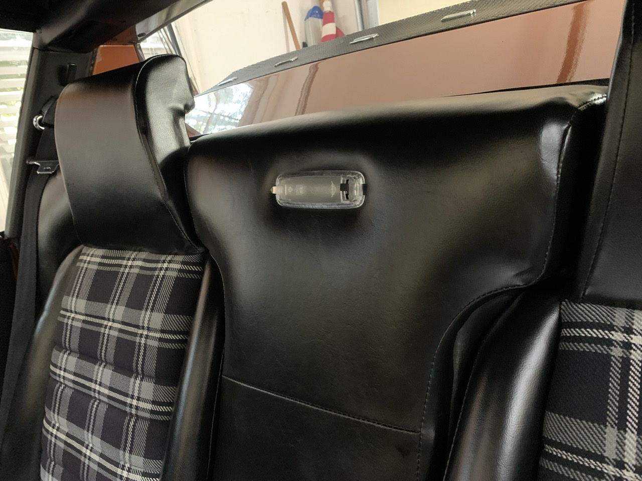

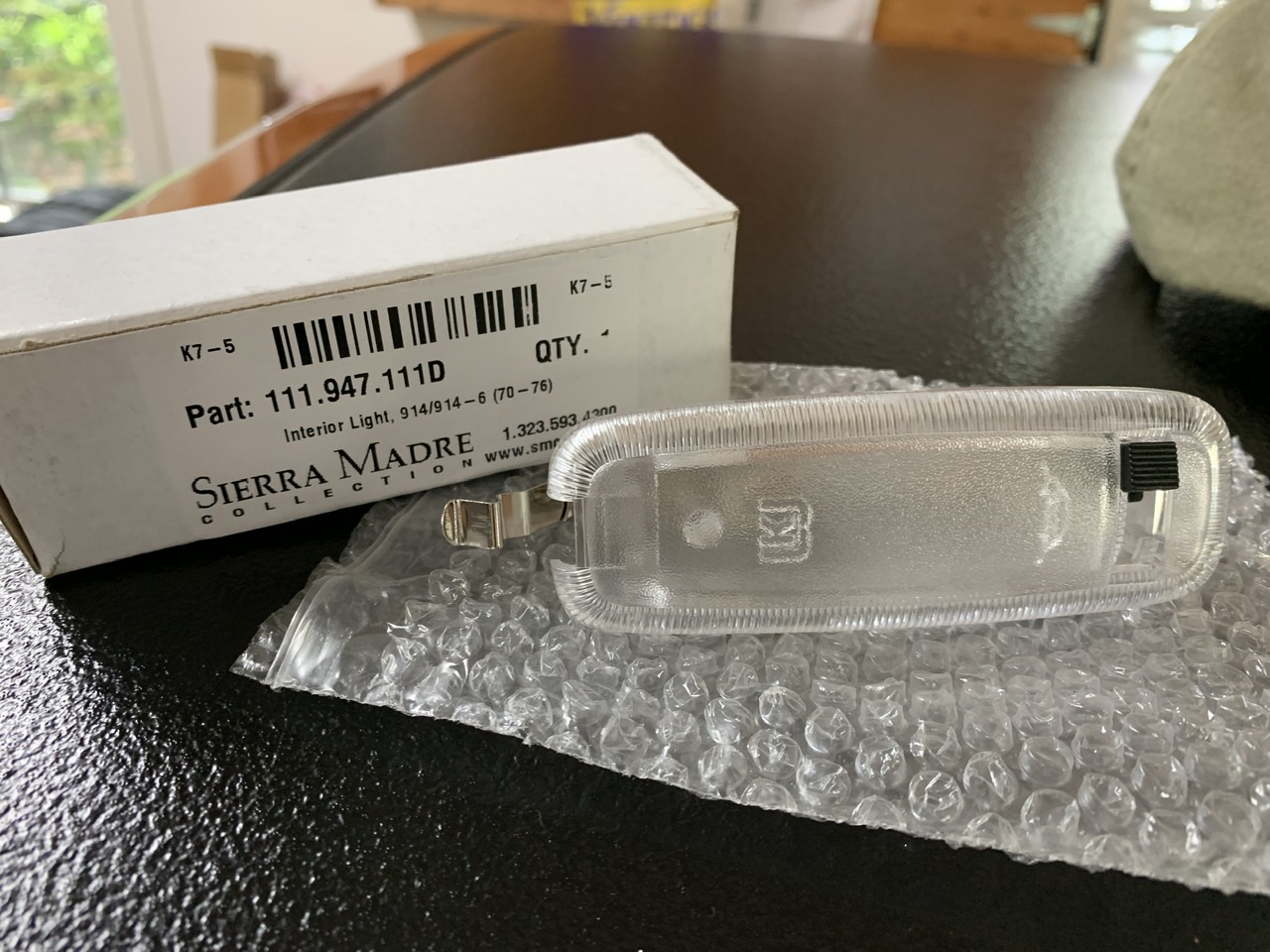

for mine from Sierra Madre, good price, perfect fit

I think I have a '74 original light and upholstery, I think I have it now, but the thing is a PITA as it doesn't give a good clip and pops out if you don't get it in far enough. I notice the clip is bent out further on the repop than mine.
Note that's a VW type 1 part number available from any early VW parts house. Window crank and inside pull handle...lots of small parts are air cooled beetle, mostly T1 & T4 parts.

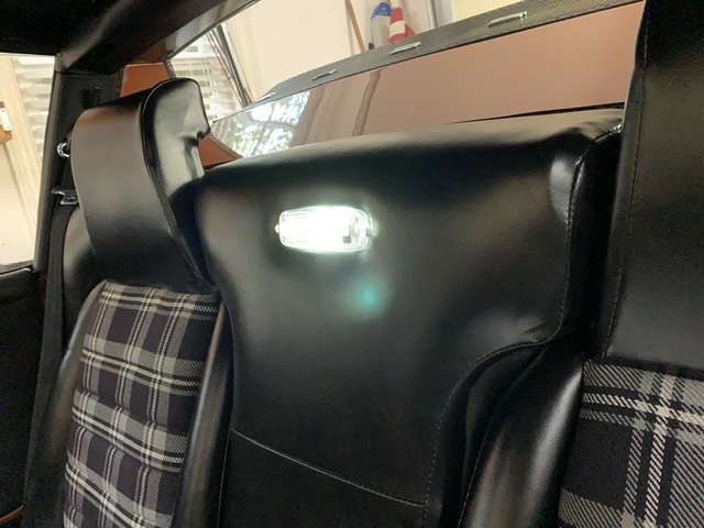

i know it’s VW, , but it works. i also just used an LED bulb so not enough heat a all to cause damage like incandescent bulb.

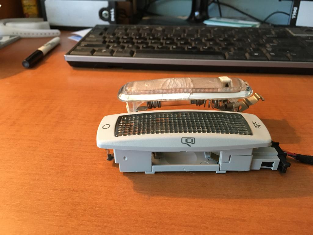

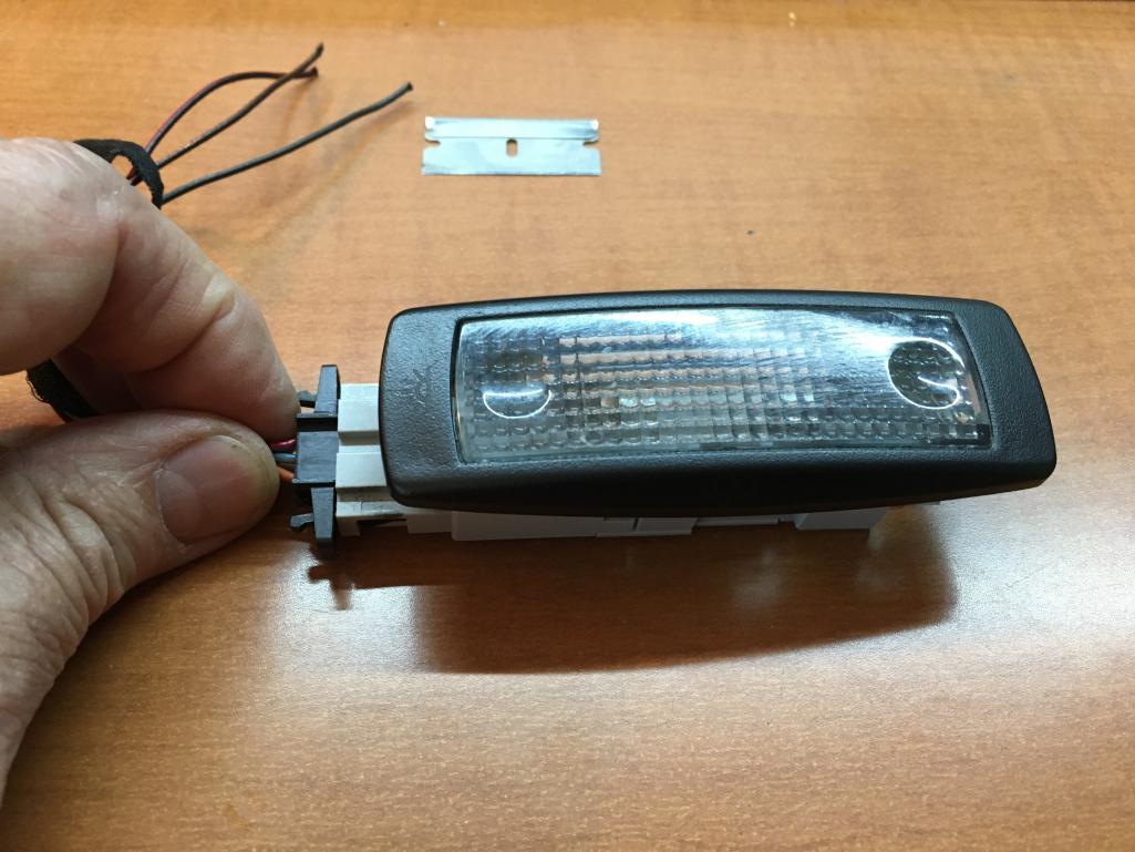

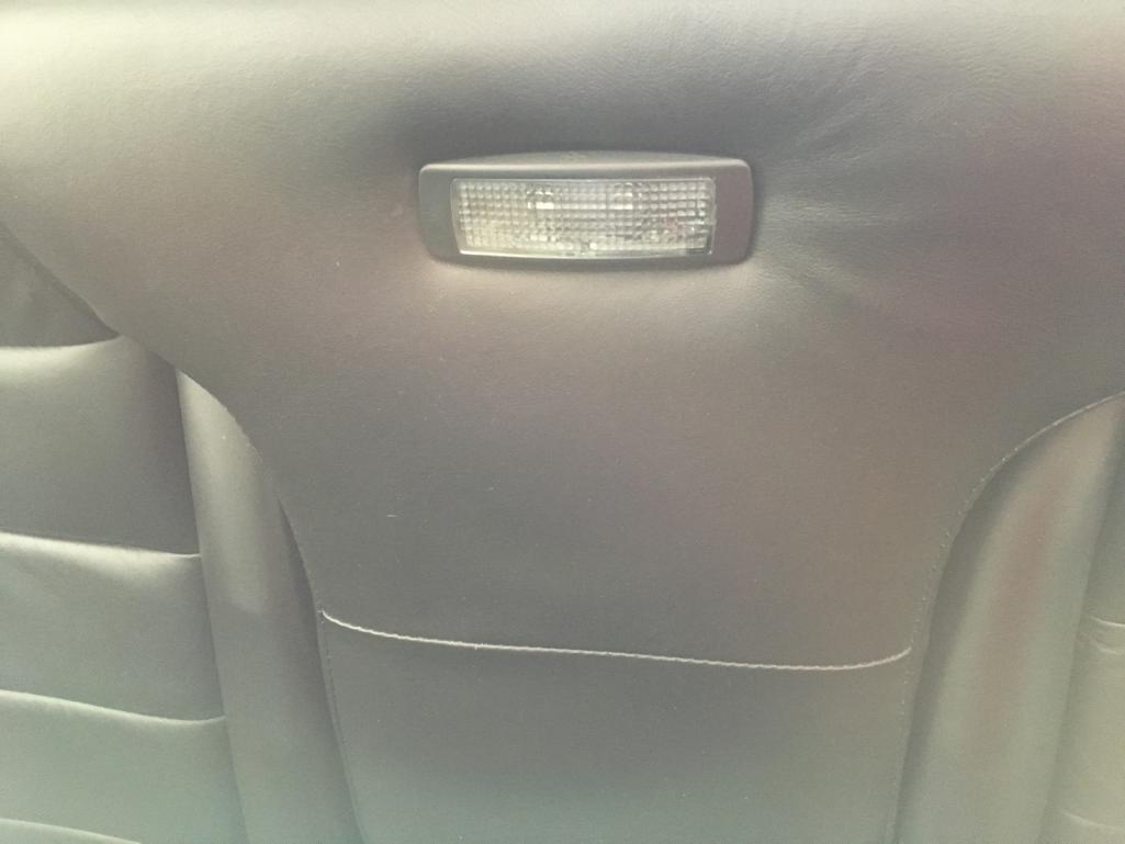

This is one I got from a new Bug and painted black

This is very slick @PanelBilly ! Did you do a thread? Does it fit the opening without any mods??

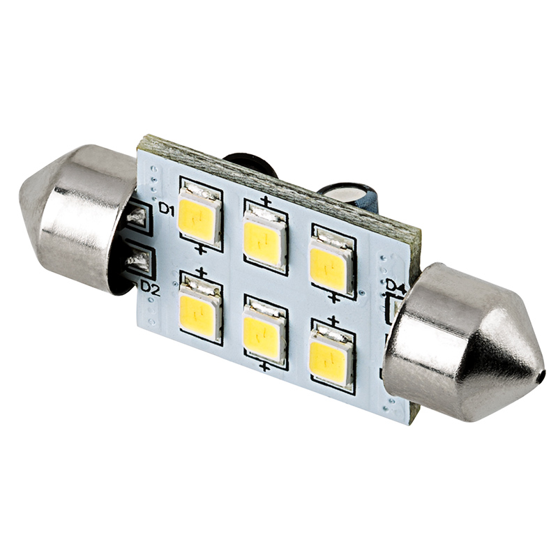

I bought the same one that Sierra Madre has from 914Rubber and it snaps in with a nice snug fit. By coincidence, today I received my order from Super Bright LEDs to replace all the bulbs in the car except headlights and instrument bulbs (already did those) with LED using their handy vehicle fitment wizard. It got every bulb on the car correct with a plug and play replacement EXCEPT the interior light. The bulb they claimed is a match is too long. This bulb should be the correct one but I won't know until my exchange is complete.
The bulb that is too long has 8 led chips and will burn your retina it is so bright. The assumed correct bulb has 6 chips so won't be quite as bright but should still be plenty to light the interior.

I like that a lot. How did it fit? Did the hole have to be enlarged?

@bbrock - I believe I have the 8-chip unit from superbright in mine and I don't remember any fitment issues. Maybe I just forced it! That's a good outlet and I have no doubt that they will easily make things right. keep in mind that there are LEDs on only one side of that board so you can rotate it a bit to direct the light to a less direct way. But really - can you have too much light coming from that fixture?!

Good to know. Their exchange process is super simple and nice so should be no trouble. They even have "incorrect information on vehicle bulb selector" listed as a reason for exchange.
I looked at just forcing the bulb in and I thought I probably could but didn't want to risk breaking the brittle plastic. I measured the bulb that came with the fixture and it is 38.5mm long where the replacement from SBL is 44.2mm. Since they have a 38mm version, I decided to try to get a better fit. I just need to print out the return label and pop it in the mail.

The light was a tight fit, but worked
