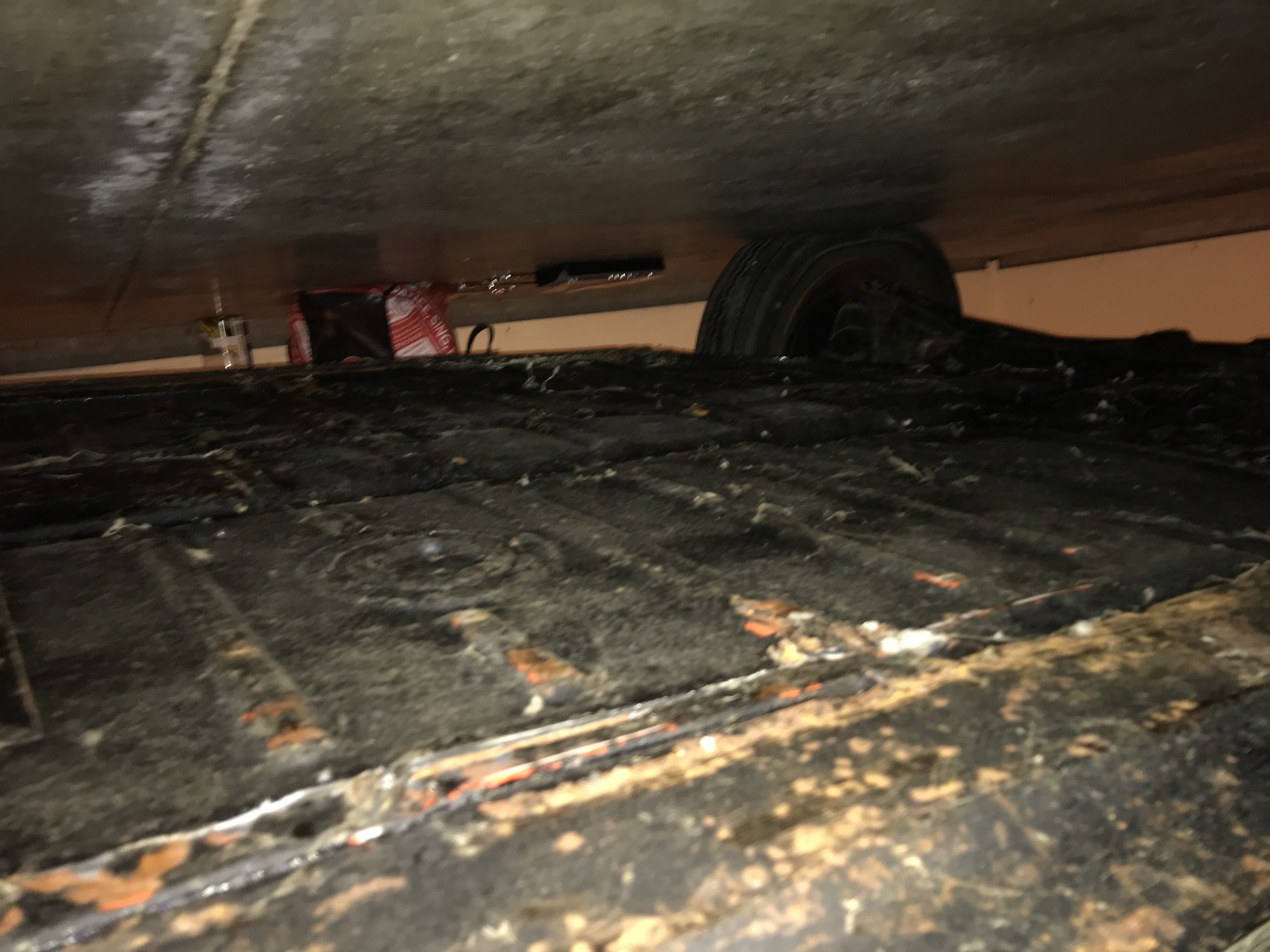

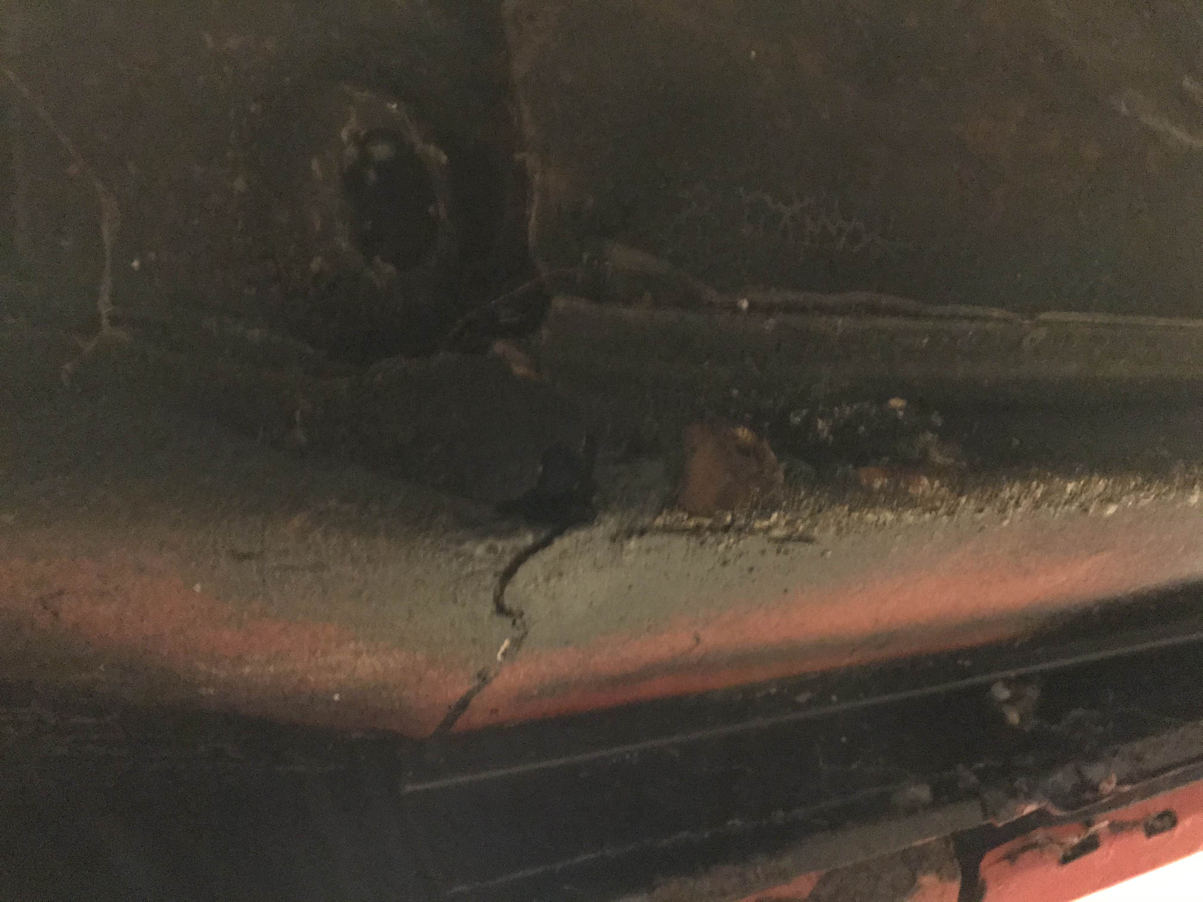

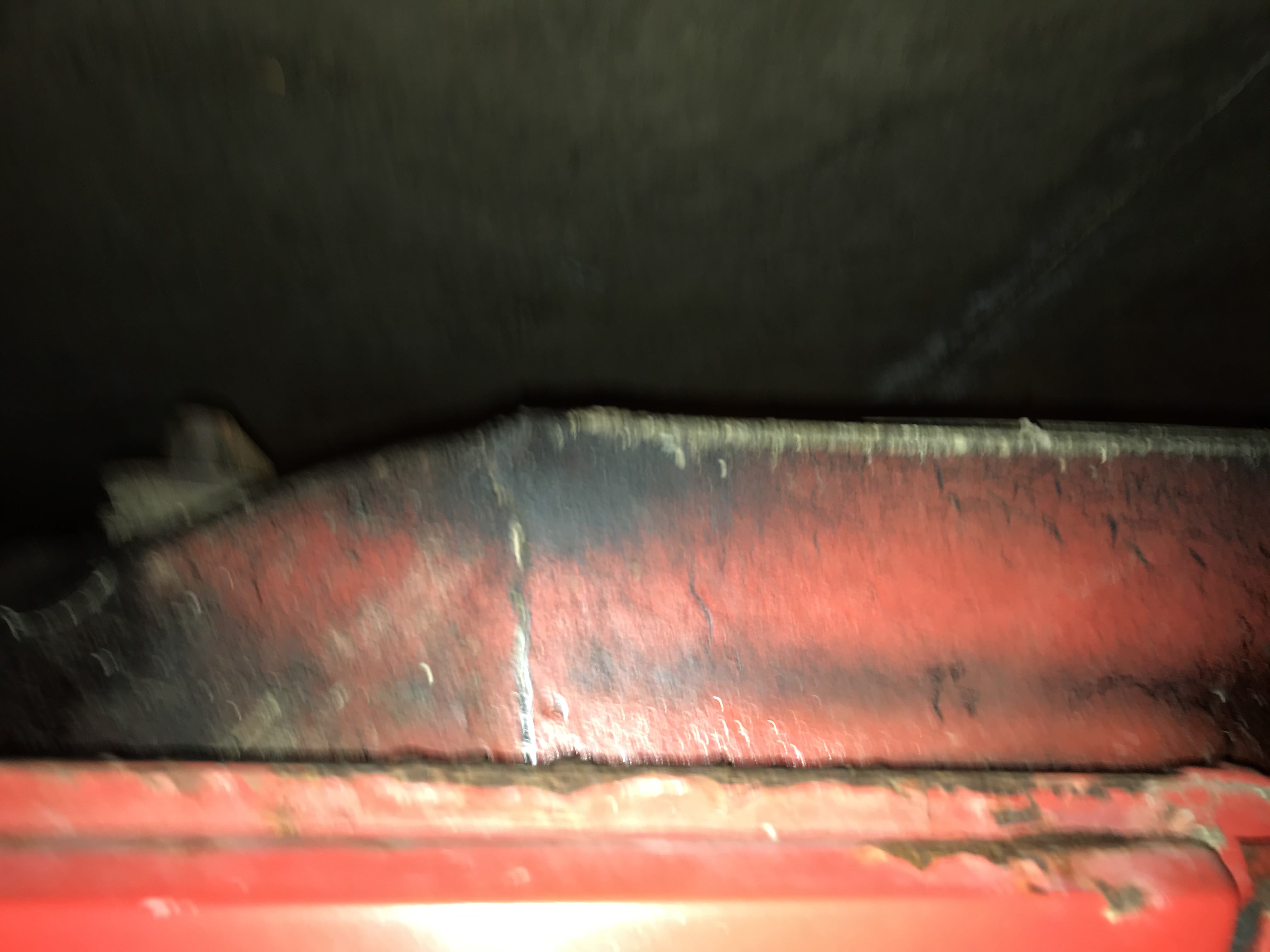

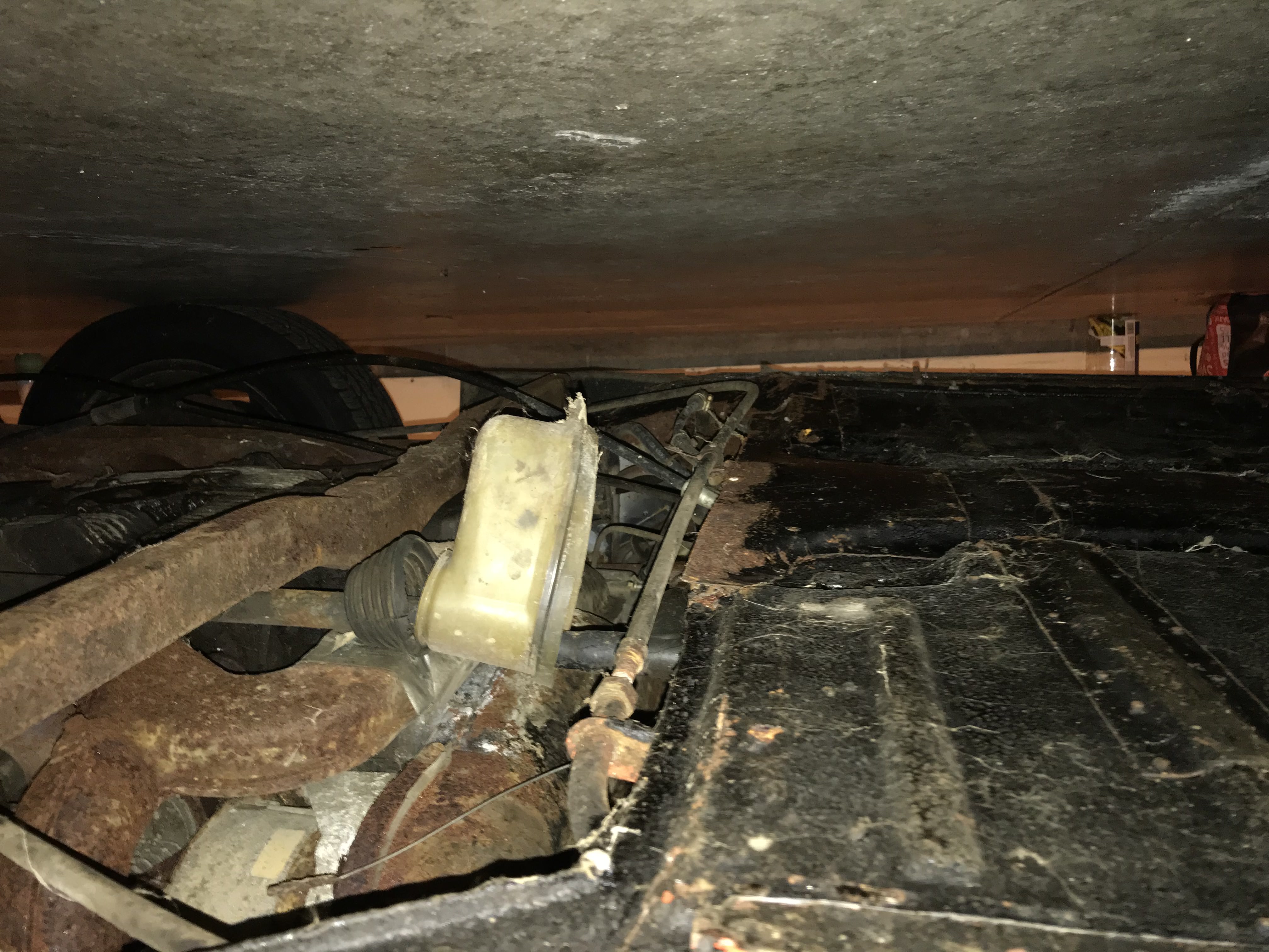

Hi all, thought'd I'd share my continuing progress on my college 914 project. I was able to get a better look underneath the car and poked around with a screwdriver, the rust looks to be mostly surface. I got the calipers off, they are def worn out and need a rebuild.

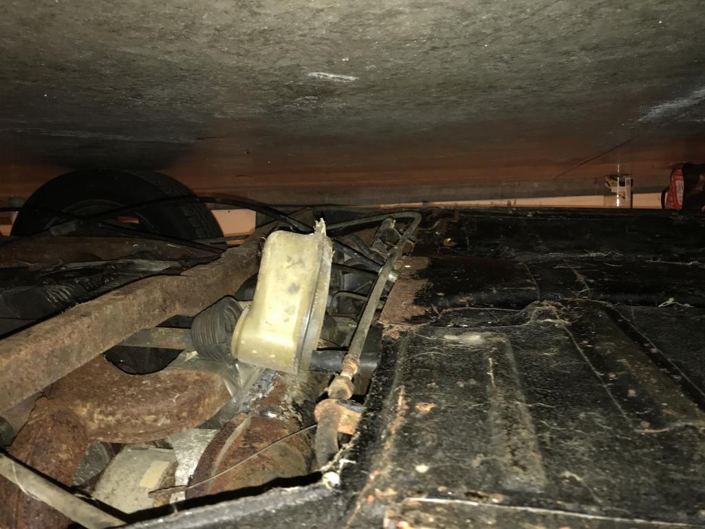

My question to you guys, is that crack in the long something that I need to be especially worried about and is it a good fix to remove the rust and patch it up with the TIG? Also, what's that plastic piece hanging from the underbelly of the car? Thanks guys Attached Image Attached ImageAttached Image Attached Image

Your long is not original. It's likely someone did a sub-par repair and didn't completely fix the previous rust issues. It looks like the the crack is the full height of the long? If so its likely the chassis flexing so yes it should be an area of concern. I recommend inspecting this area further to determine a course of action.
And the plastic piece hanging down is a cover that protects the shift linkage connection just outside the tunnel.

Are quality aftermarket longs available? I've found the ones on restoration-design but it seems to only be the inner longs. I supposed it would be possible to fabricate a solution but I'd not want to go this route if possible. At some point I certainly would like to remove the non-original repair work but as of right now, I only have a rented garage to work in so it's a little tough.
If the chassis is structurally sound, would it be advisable to do some rust removal, weld the crack closed and add a patch panel overtop? It looks like it was poorly welded to begin with and ended up breaking.

By any chance has the jack post and plate been removed?
The plastic piece is the shift linkage which should be up against the firewall.

On the plus side, you probably have time and energy to do the work even if you can only pull off a temporary repair. However, beware. Rusty longs compromise the seat belt restraint mounting points and even a low G impact could become injurious if the seat belt mount pulls though the long due to compromised sheet metal.

I'm a little skeptical you'll be able to just weld that crack shut. I would stab it with a screw driver like you are trying to murder it to see how solid the metal is. You can't weld rust and usually a crack on the outside means more rot on the inside.

The outer floor patches are not factory. Put 200 lbs of weight in the seat, see how the door operates and if the margins remain consistent. That appears to be a pretty rusty car. You're seeing the tip of the iceberg. what do the trunks look like? Invest in some good penetrant before you start turning too many nuts and bolts.
