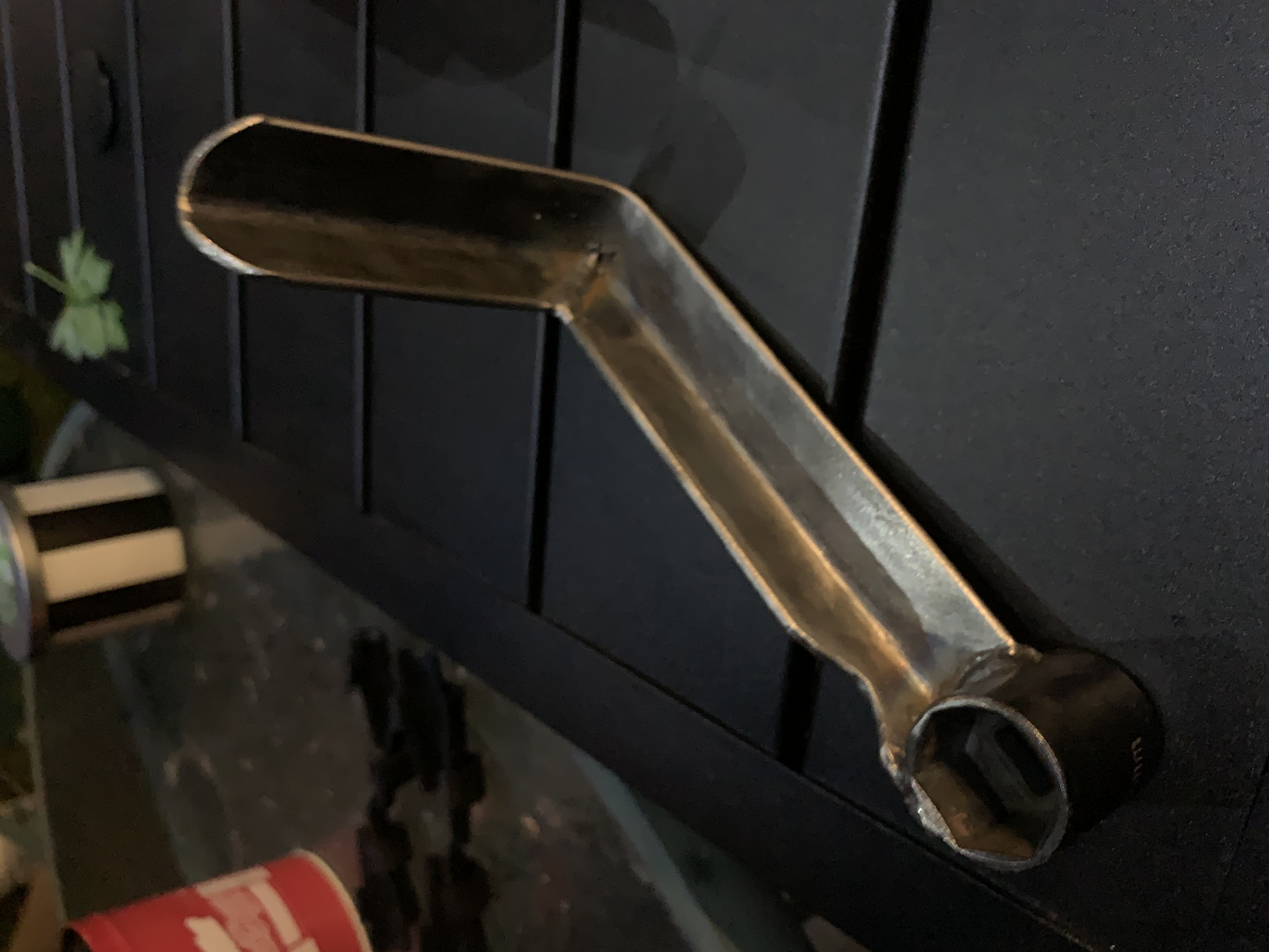

Someone had put a torch to a flat wrench and put some bends in it to access the nut. Looked pretty slick. I’ll try to find a pic.
Found it
I was thinking that one easy alternative to a hatch would be a 1-1.5” hole in front of the fan pulley nut. Just large enough to stick a socket or impact gun to the nut. You would still have to work all the parts on and off through the engine bay but it’s really loosening and tightening that nut that causes issues.

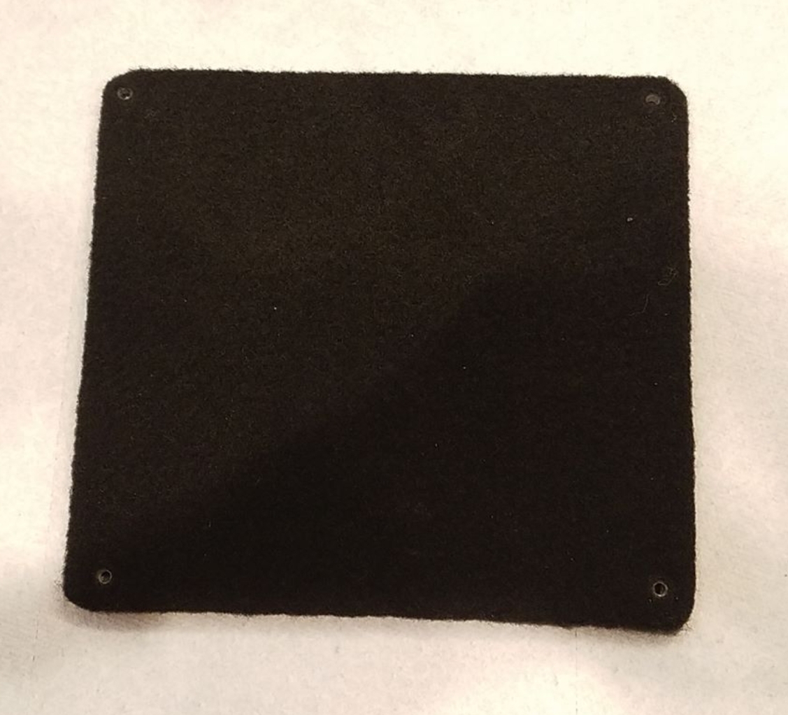

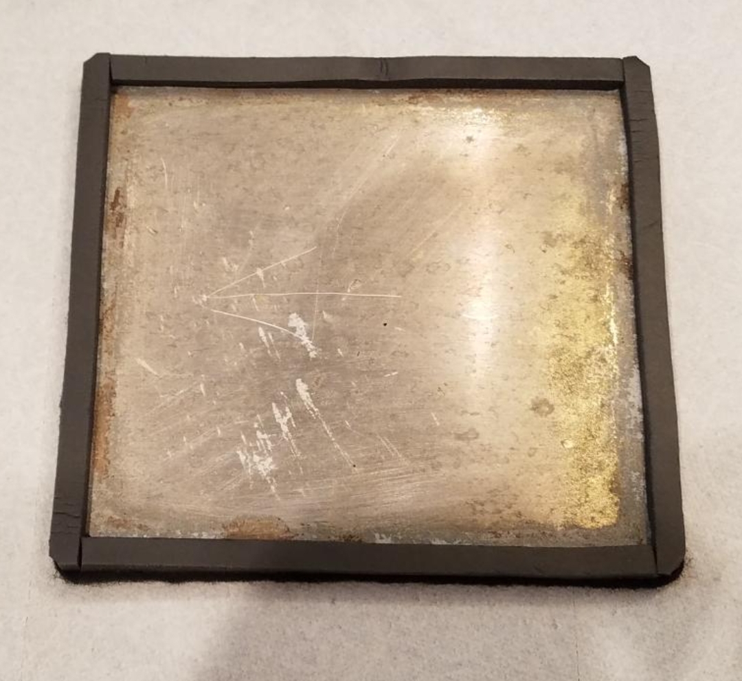

Small access plate on Sonauto #40

I also just got a closed end wrench for the pulley nut and bent it with a torch to get the needed clearance at the firewall. However, I think that dropping the engine and doing all the service needed at once is a much less frustrating choice.
