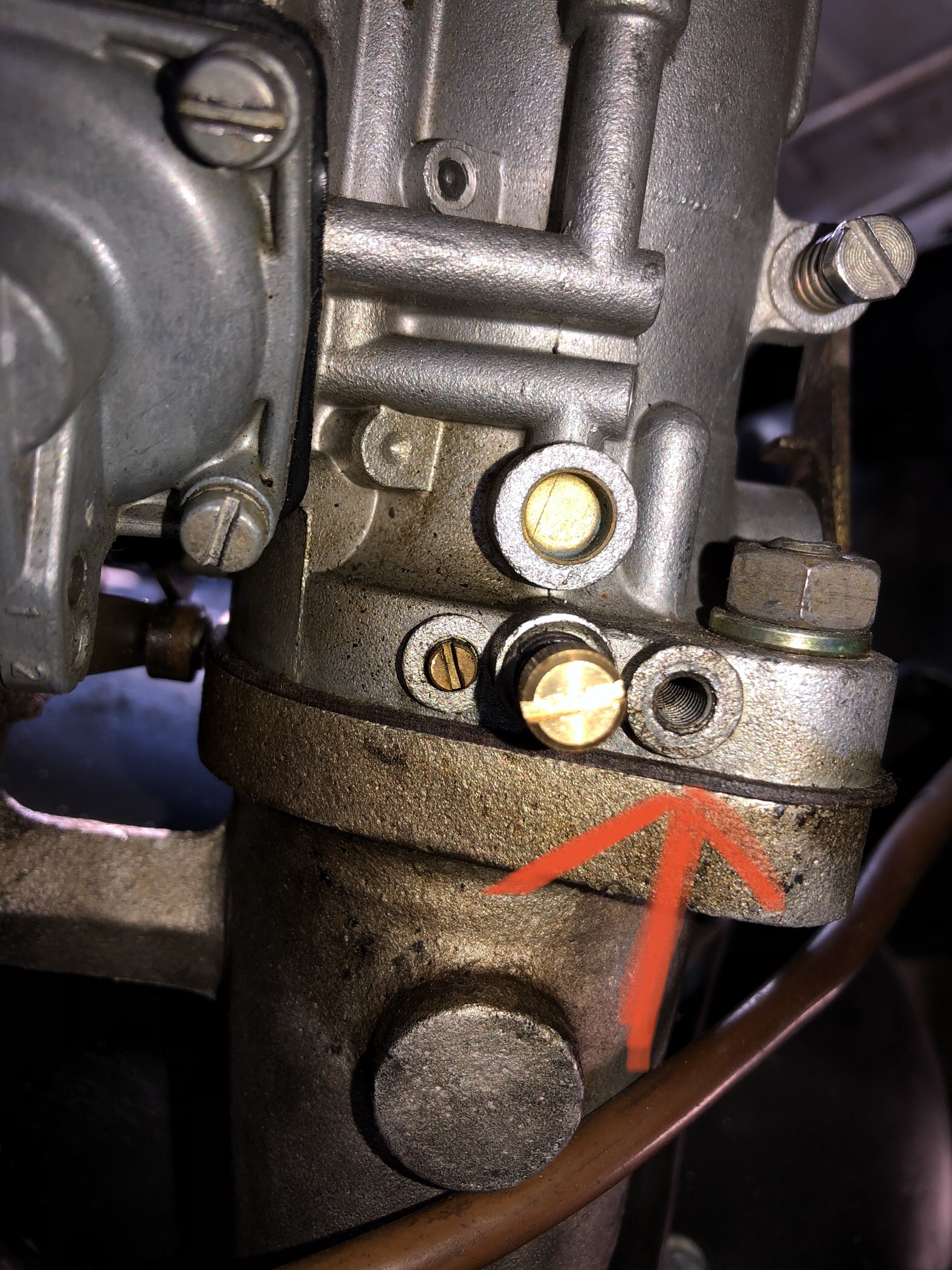

> Umm, shouldn’t I have something here?
Tdskip
post Nov 22 2020, 02:35 PM
Posts: 3,755
Joined: 1-December 17
From: soCal
Member No.: 21,666
Went looking for a port to connect a vacuum advance and found this on the Weber IDF.
That should be my idle air adjustment and jam nut, right?
Anyone know where to source the vacuum port that screws in to the blanking screw on the left?

That's where the air bypass screw should be. It's what you use to balance air flow between barrels
Thanks Perry.
Any idea on sourcing the vacuum tube that screws in?

Can’t seem to find a supplier - believe it is 4mm threaded nipple.
Fixed the missing air bleed screw with a donor part from a spare IDF already.

Very likely this guy will have it:
https://www.ebay.com/str/alfa1750scarburetorspartsstore
