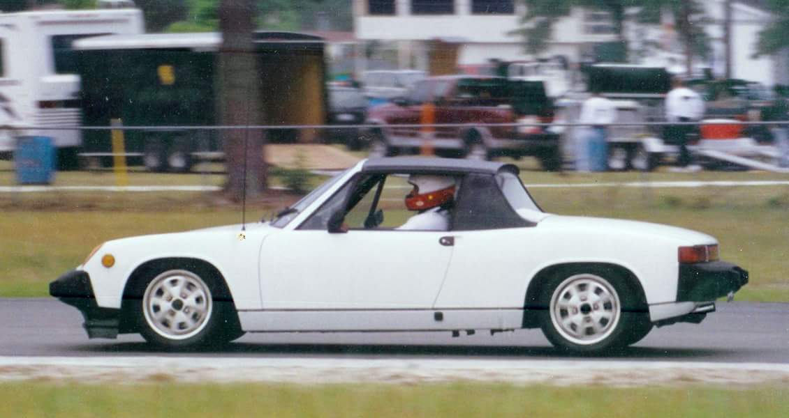

racerbvd
post Jan 11 2021, 06:23 PM
Posts: 2,376
Joined: 3-February 03
From: Sunny FL.
Member No.: 226
I have always liked 195/50/15Attached Image
