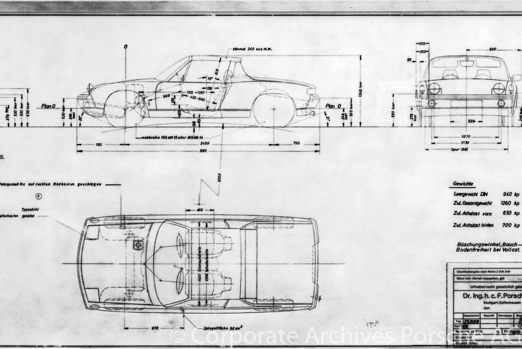

article has an interesting tech drawing in it.
if you are in aus.
looks like a rhd steering wheel?

QUOTE(wonkipop @ Jan 17 2021, 06:27 AM) *
if you are in aus.
thanks for the link. i've not seen before, maybe the pics in the 50 year book but i don't have a copy of that yet?
Looks like steering wheels on both sides. That could be interesting for shared drives.

@bkrantz
had not thought of the simultaneous arrangement.
if so obviously intended exclusively for aus market.
"empowering" back seat drivers to dual control status.
wonder if they had dual brake pedals in mind as well?

I'm pretty sure the drawings just show the layout for *either* left or right hand drive.
You can't really have two steering shafts merge into one and still expect them to operate independently.
So one side is only for show? That could be even more fun for some couples.

No, it means that instead of spending the time to do two almost identical technical drawings, one with the steering wheel on the left and one with the steering wheel on the right, you only make one drawing that shows how the linkage would run for either of those implementations.

i'd love to see more of those drawings for the rhd version.
its dated 1969.
think of the trouble they would have had to go to.
mirror firewall.
mirror fuel tank.
mirror back pad and passenger seat in interior.
mirror handbrake.
no wonder it never happened.
whereas a 911 is like a compromise rhd version (or is it a factory conversion?).
you would not believe how compromised the rhd 911s are.
you have to open the passenger door in a 911 to spring the rear engine hatch.
and thats in a 80s 911 they were flogging to stockbrokers (aus stockbrokers too!).
its great.

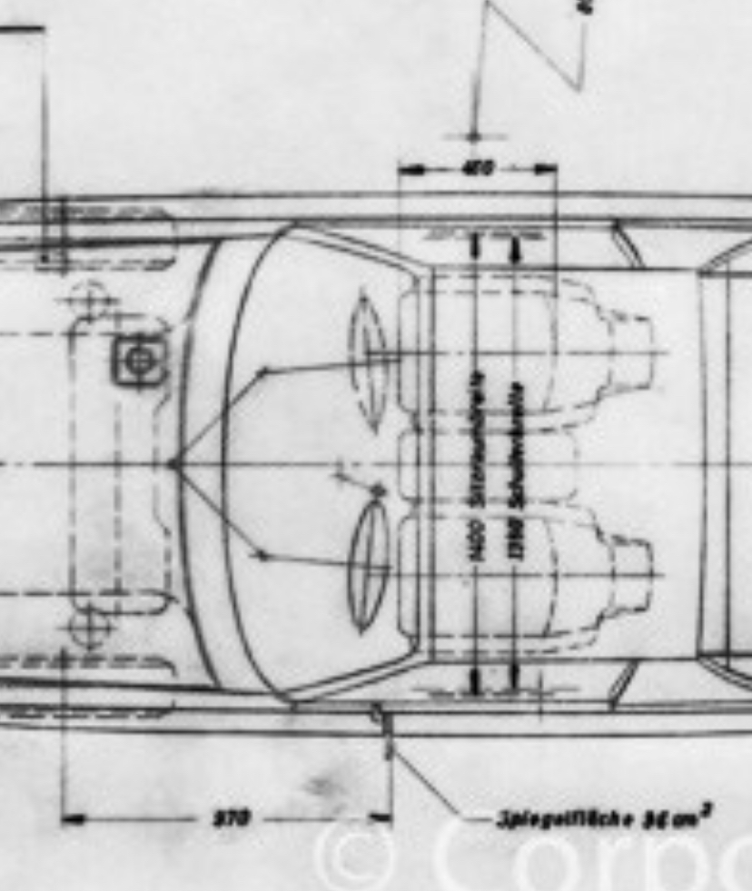

There’s no question in my mind that those drawings indicate that there was every intention to make rhd versions ex factory.
It was obvious to me when I did conversion on my car. The mirrored pedal box detents on the floorpan are a pretty obvious clue as well.
The seats in the drawing are seperate too and identical, not the weird bucket and bench seat arrangement that graced the first year of production.
The fuel tank shown in the above drawing is different to what went into production to my eye also. The production tank has the bulbous end on the right hand side that compromised the conversion. My feeling is that drawing came before the decision to build only lhd cars.
wonkipop

i reckon they are drawing a kind of all in one mirror drawing phillsteck - when it comes to the fuel tank, similar to the two steering wheels in the same drawing.
both would have had bulbs, but mirrors of each other.
its a purist car.
the only thing they would not have been able to mirror would have been the battery location in the engine bay.
know what you mean about the floor pan.
the seats are fascinating.
i'd go so far as to say the original idea was the way they first came out and they would do the rhd as a flip. but they were grappling with the idea of a perfectly balanced car with only a driver in it,,,, like a race car. so rhd was a challenge.
i'd love to see some more drawings from the archive on rhd.
