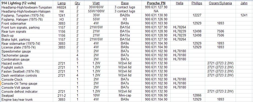

I was going through the list of all the light bulbs while thinking about LED updates, and decided to make a comprehensive chart. I don't know if this has been done before. Consider this version 1, and please let me know where I went wrong.

this is great, thanks for providing it. superbrightLEDs.com also has a neat little wizard for determining which bulbs you need

Looks great BK.
Here is mine from my webpage: https://bowlsby.net/914/Classic/TechNotebook.htm
Looks like we should reconcile/update these for a master list.

Hi, Jeff. Sorry I did not see your chart first. Feel free to use what I compiled, and let me know if you want me to send the xls file.

Are the charts above applicable for all model years?

Great lists - thank you, they will come in handy one day I am sure.
