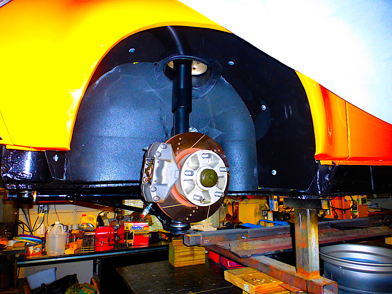

On my restoration/build, we dug all that foam out of the rear corners.
The entire underside of my car is coated in body color Raptor bed liner....including the fender wells and where that foam was sitting.
This Raptor is like granite, so should really hold up to debris and moisture.
On top of that, I just finished installing fender liners that are easily removable....couple minutes for each.
http://www.914world.com/bbs2/index.php?sho...amp;hl=raynekat
I used hex headed screws instead of the supplied rivets for easy removal.
When you need to inspect, it's a snap.

QUOTE(raynekat @ Feb 13 2021, 09:06 PM) *
I did the same. Forgot to mention that but I made sure I shot a good build up into that area. I do think the metal is pretty well protected between the epoxy and Raptor but still don't want it to fill with crap that can trap water.

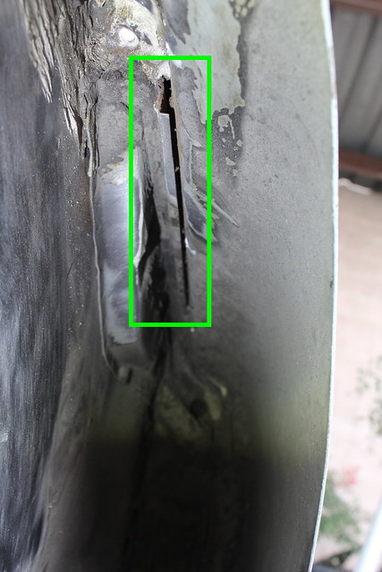

@Cairo94507 This is the other area I was wondering about, where the sail panel meets the inner quarter panel. Is it supposed to be open? It seems odd that moisture can easily get up their onto the foam inside the sail panel.
(IMG:http://www.914world.com/bbs2/uploads_offsite/live.staticflickr.com-17027-1613290847.1.jpg)
QUOTE(Cairo94507 @ Feb 13 2021, 01:35 PM) *

It just dawned on me that maybe I could use cavity foam, and then I came back on here and saw you mentioned it.
I guess another option to make sure it's fully coated could be to use something like Eastwood's internal frame coating and just stick the nozzle up into the space above the turn signal.
https://www.eastwood.com/internal-frame-coa...tBoCa5oQAvD_BwE
