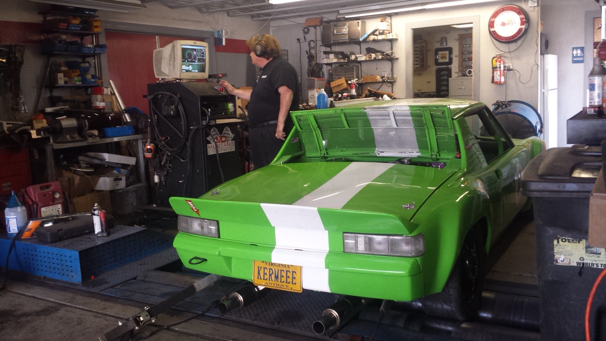

full open
not megaphones
I went from 2 separate exhausts to a cross over system
dyno'd at an additional 14 ft. lbs. back to back

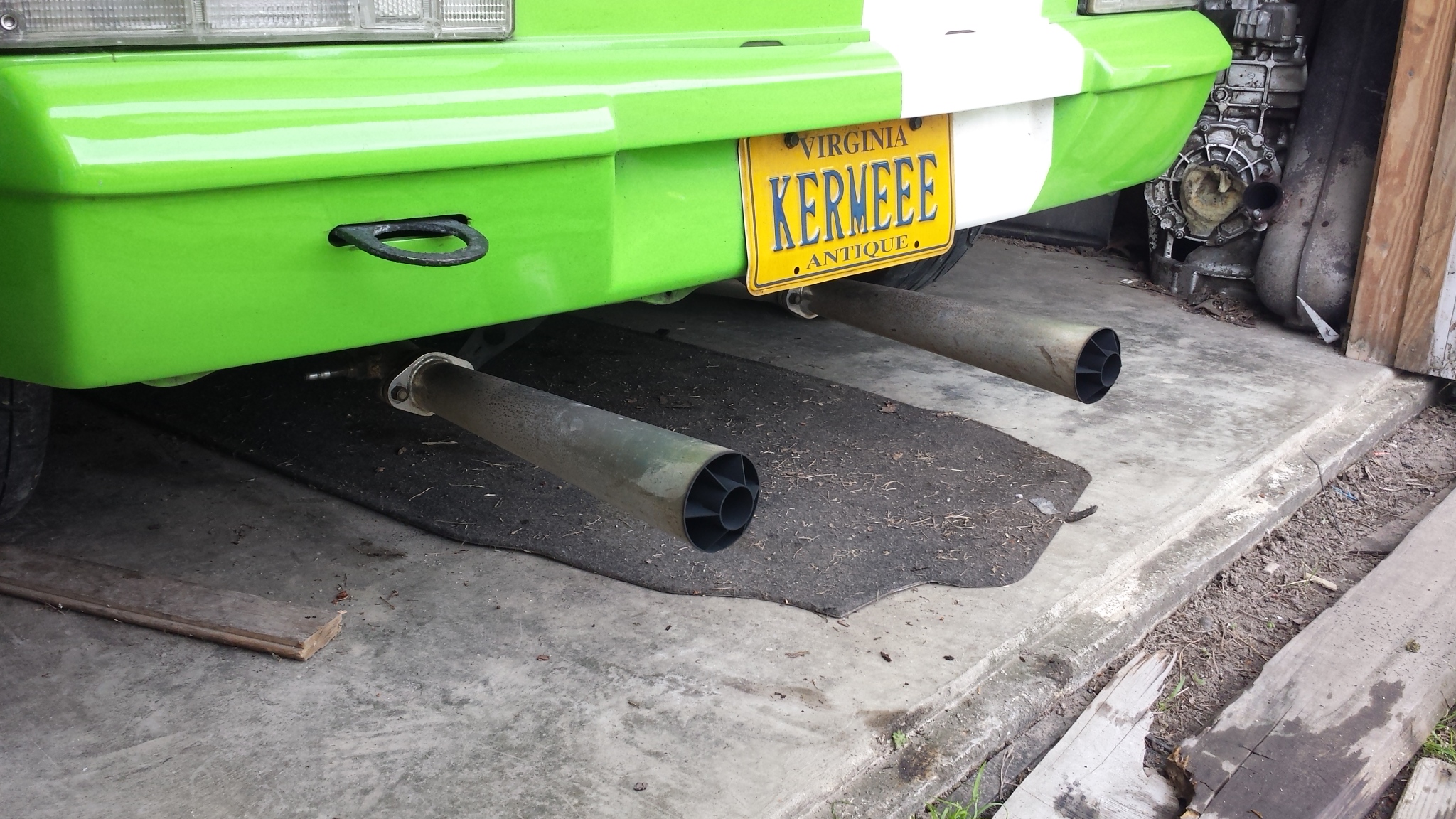

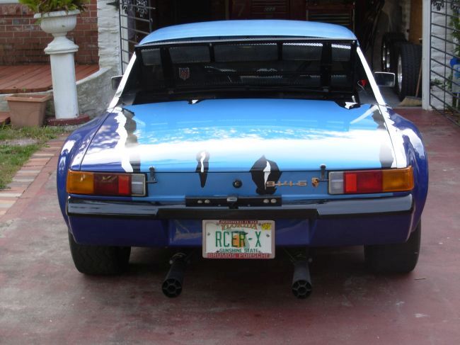

I'm running both megaphones and glass packs depending on my mood and the noise restrictions at whatever track I'm going to next....
Here's a couple of photos, not pretty but you get the idea....
The glass packs are "Jones Turbine" and are 2 inch inlet & outlet--had a local muffler shop weld on the flange.
Interesting to note....dyno runs with both show no difference...215ish so guess it's not the muffler that is controlling top end....

PS, Yes, that's Peter Dawe at the dyno.... (IMG:style_emoticons/default/pray.gif)

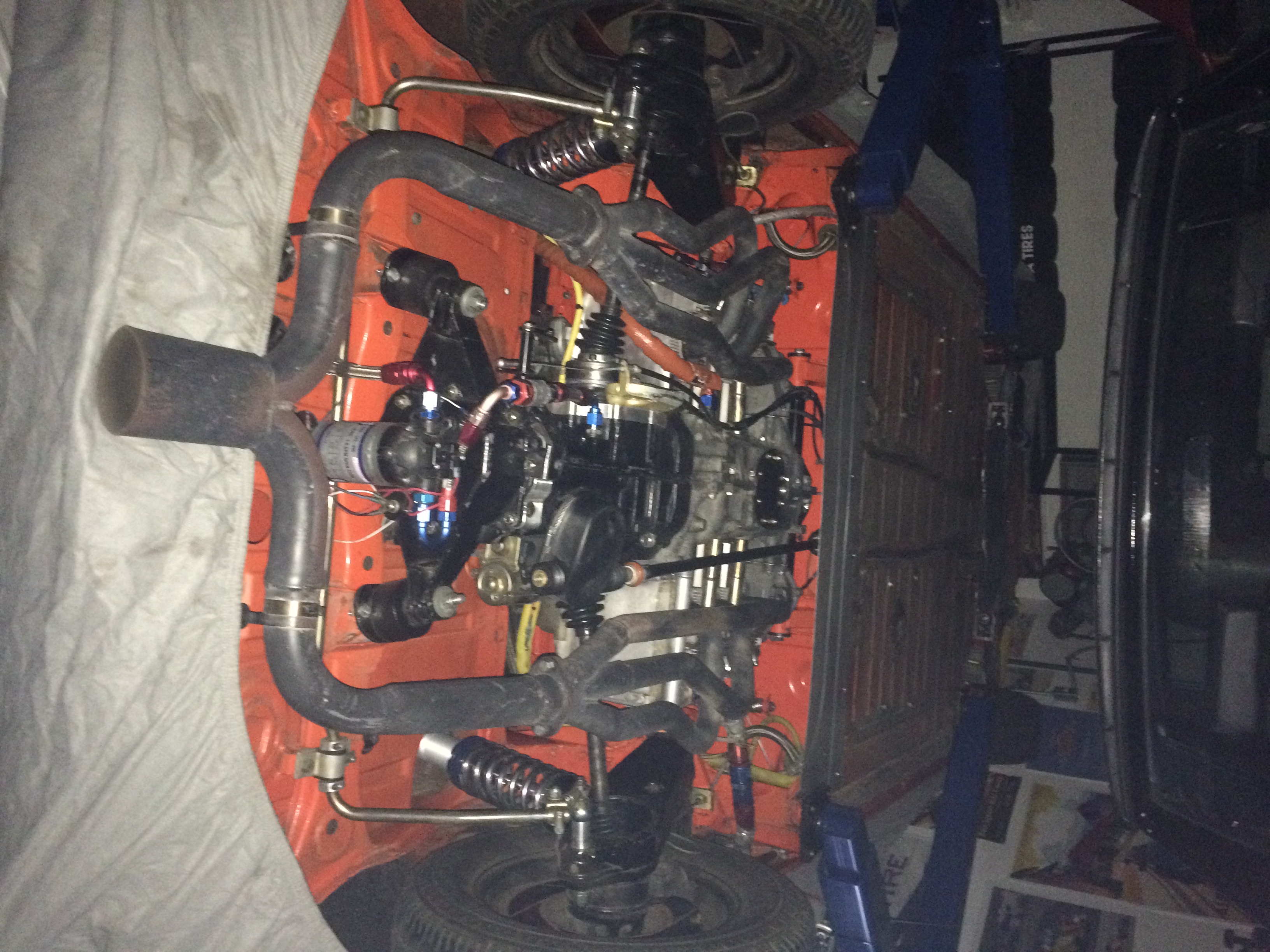

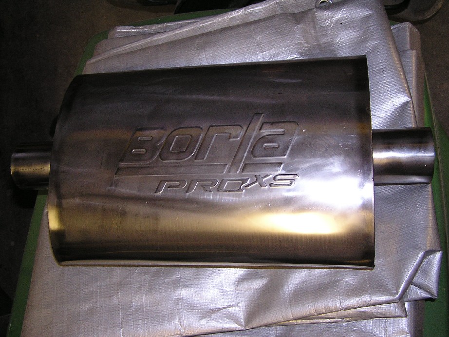

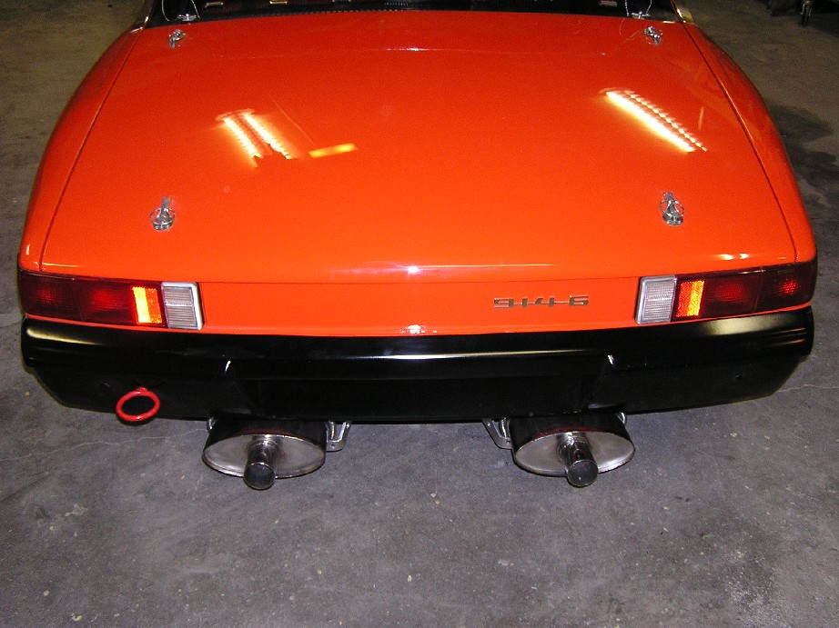

brant
post Mar 5 2021, 11:23 AM
Posts: 12,167
From: Colorado
Member No.: 47

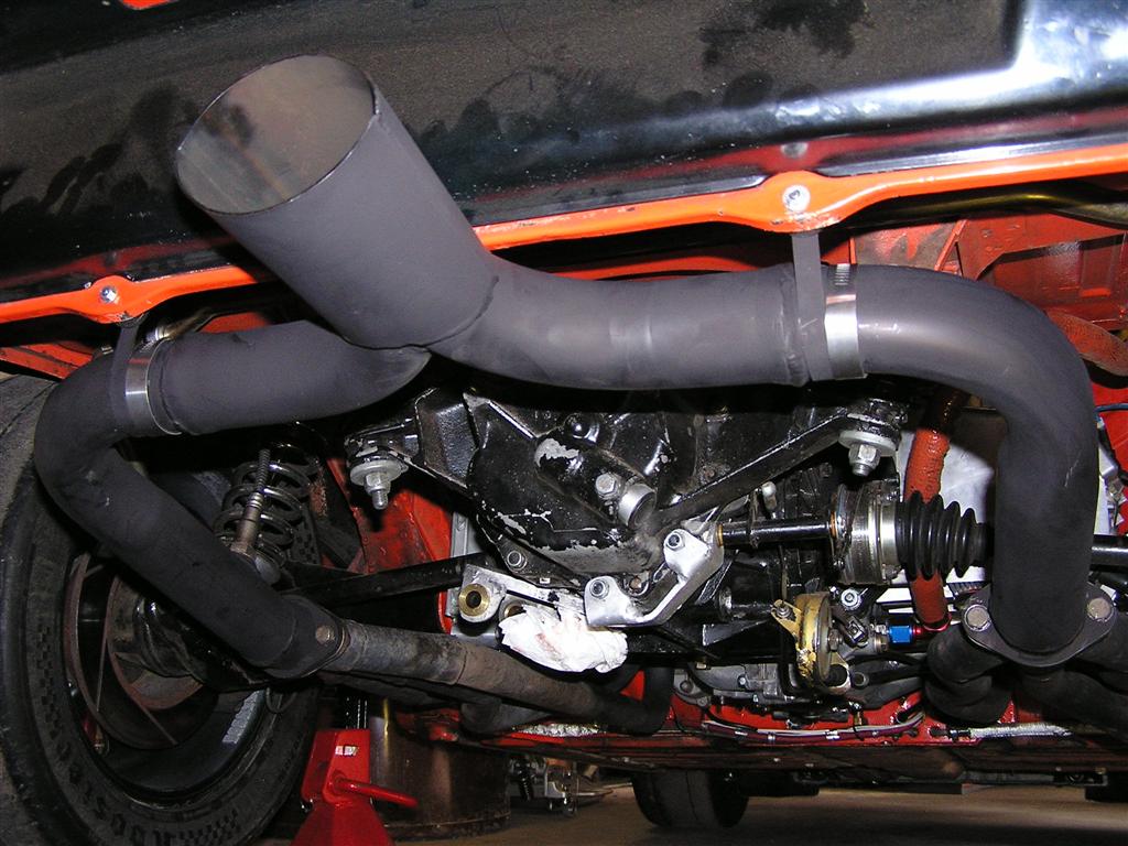

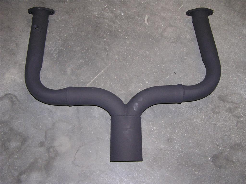

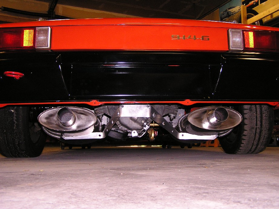

things are crazy busy right now..
I just took pictures from my build thread to save time
original exhaust was straight through twin borla Stainless mufflers
2nd exhaust is not a true cross over. a true cross over should/could be even better
this is just a collector that brings the banks together at the very end of the system
still picked up 14ft lbs on a back to back dyno run

AJRS built on the spot.. before my eyes. 20 minutes
And then we dyno’d

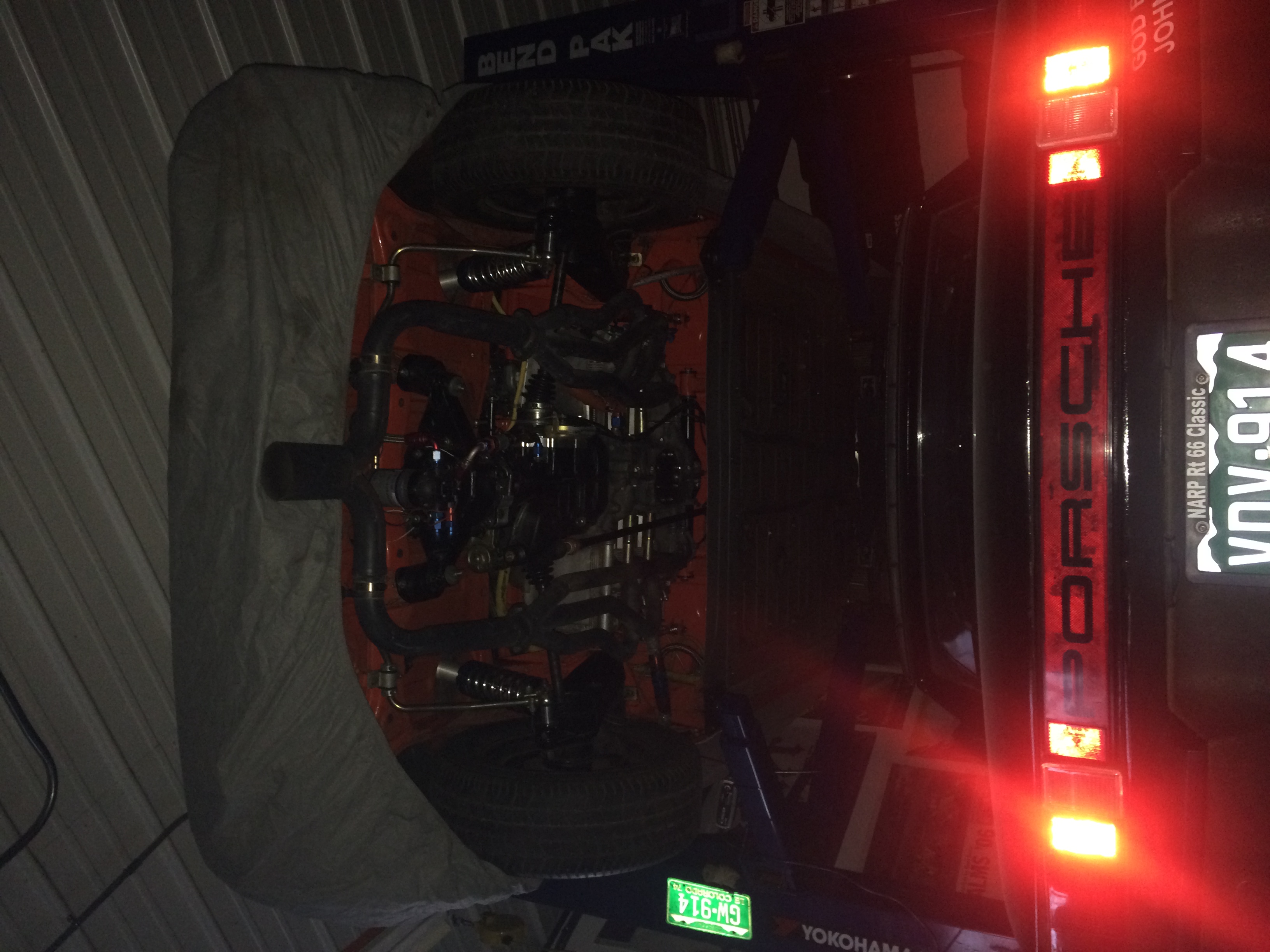

brant
post Mar 5 2021, 07:27 PM
Posts: 12,167
From: Colorado
Member No.: 47
Current pictures
Many years later

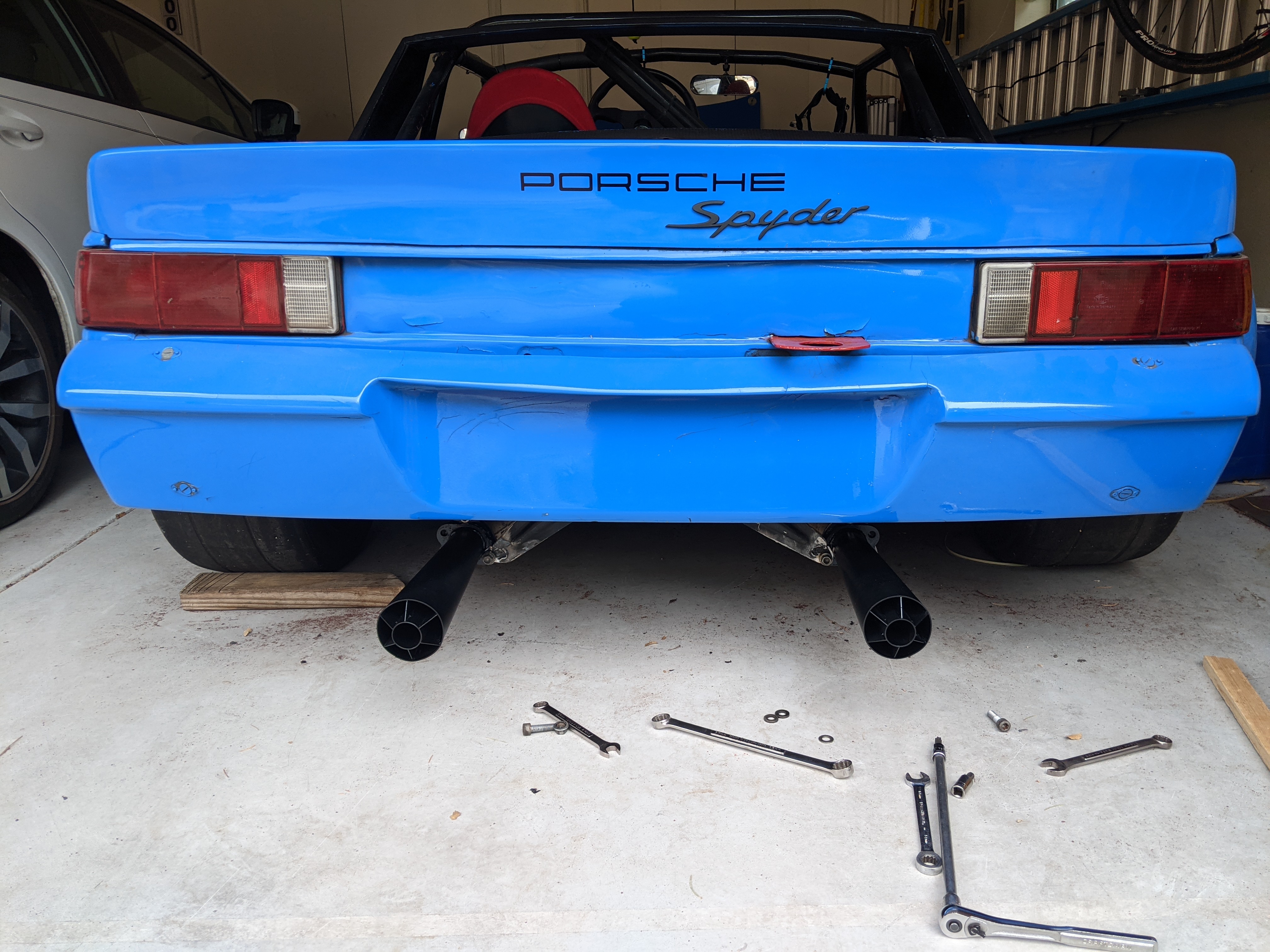

BadToTheBown
post Apr 19 2021, 10:13 PM
Posts: 36
Joined: 12-July 20
From: ABQ NM
Member No.: 24,488
Just updated to cookie cutters from my SuperTrapps, certainly loud...
